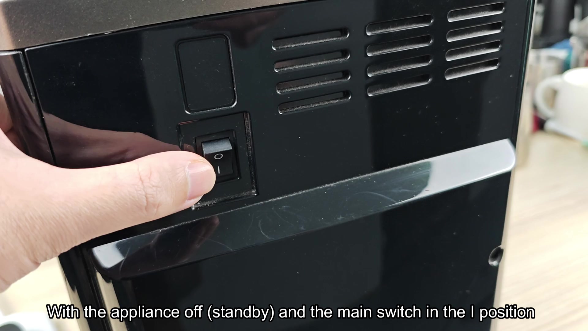

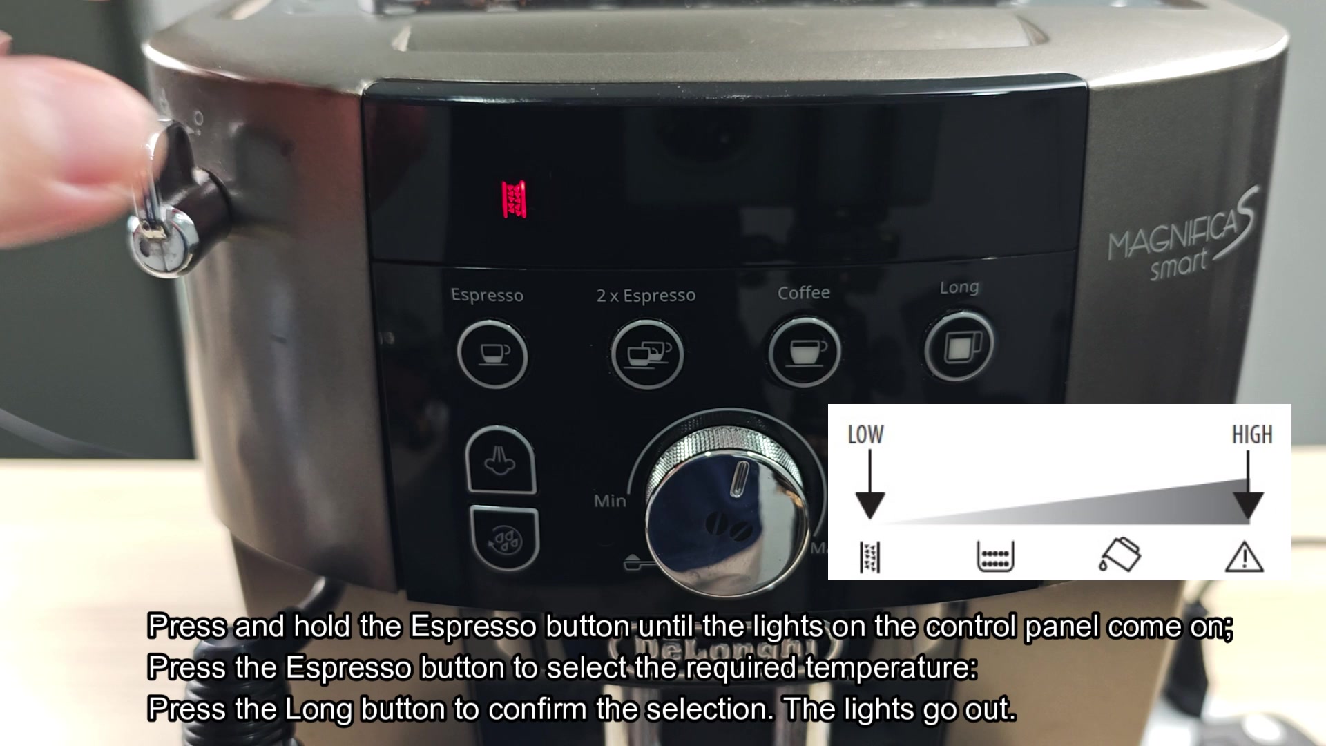

Found this while researching the De'Longhi Magnifica and wondered if anyone else have experienced the same. The machine adjusts the brew temperature via a button combination while it is in standby mode (main switch in an I position).

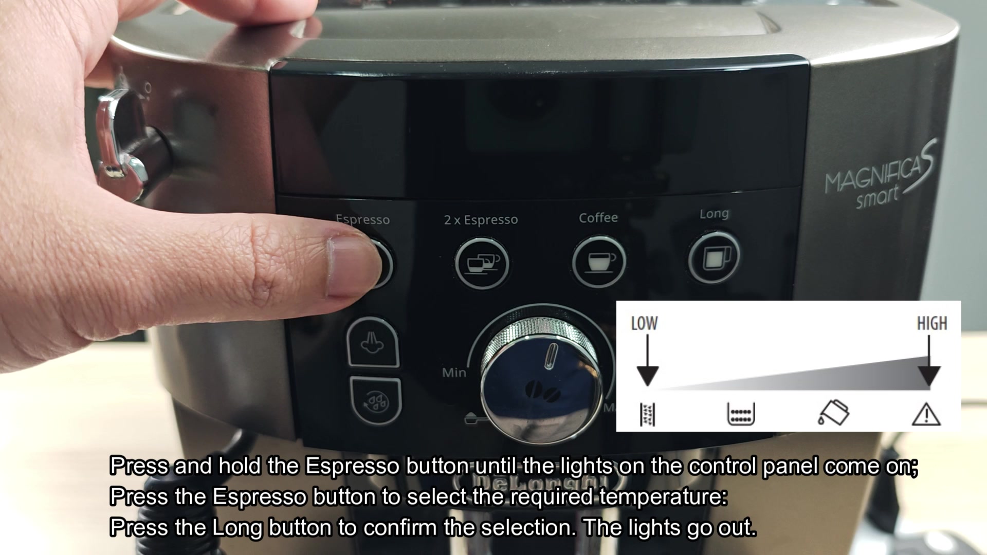

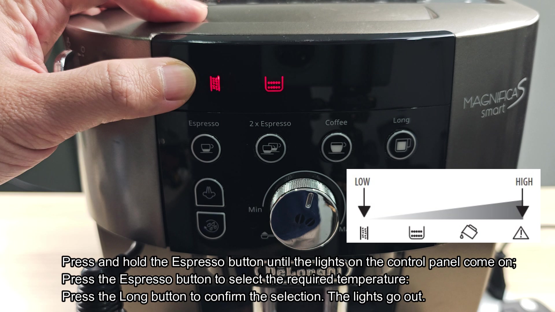

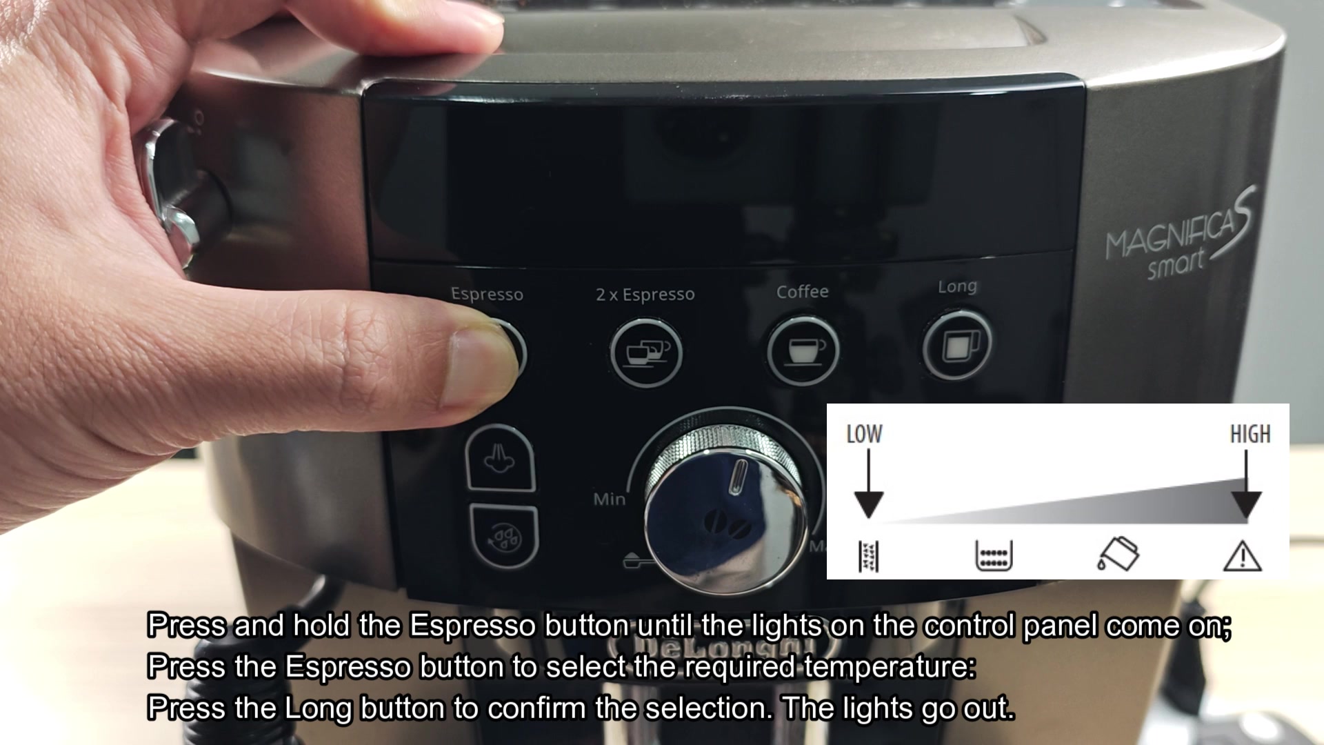

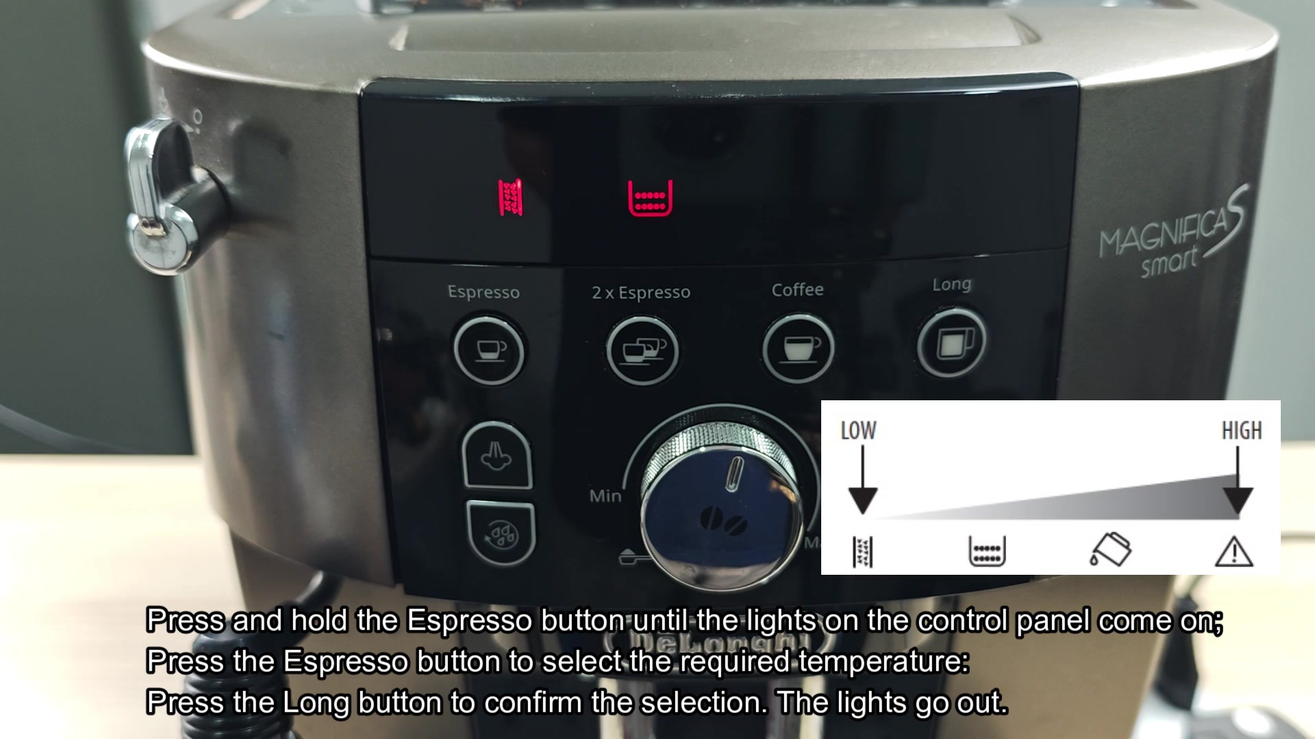

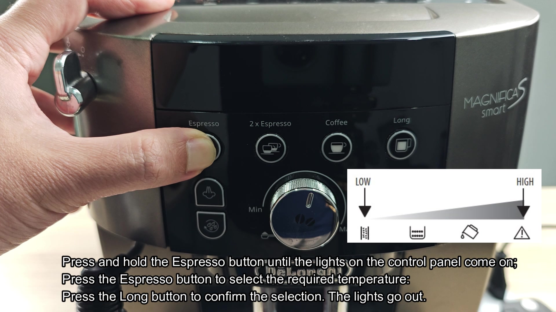

With the machine off and the switch in the I position, press and hold the espresso button. Repeated press of the espresso button cycle the brew temperature from low to high. Once you find the brew temp you want, press and hold the long button to save the setting. Seems simple enough.

works on my S model, did it about a year ago. Went from default (which i think is middle) up to max and the espresso is noticeably hot. Survived two descales since then so it does persist at least on mine.

wait does the rear switch actually need to be in I for this or will it work if its already been on for a while? like does standby mean fully powered down or just the front button off
