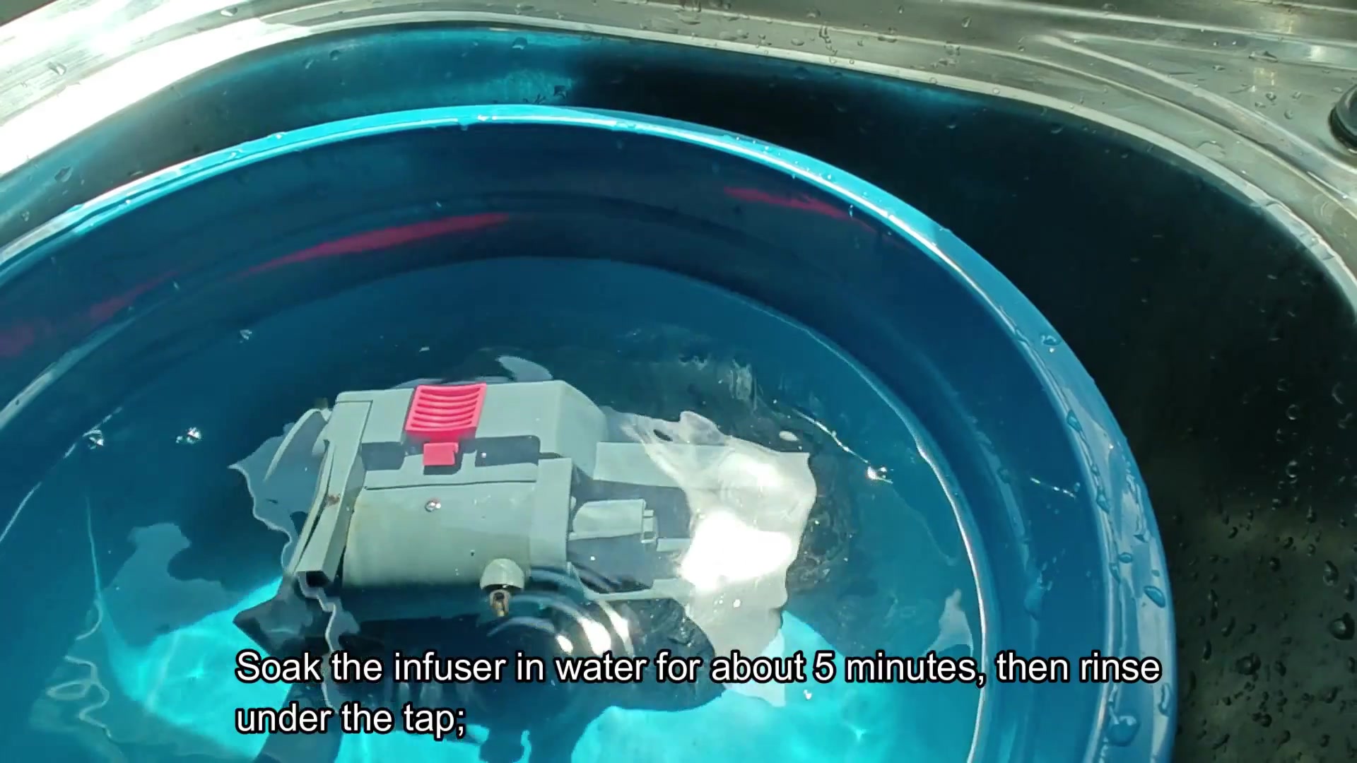

yeah you got the basics right. Solid = clean me, flashing = infuser. But to properly cleaning the machine you have to pull out the brew unit and rinse it with warm water. Also give the rest of the machine a quick wipe down.
