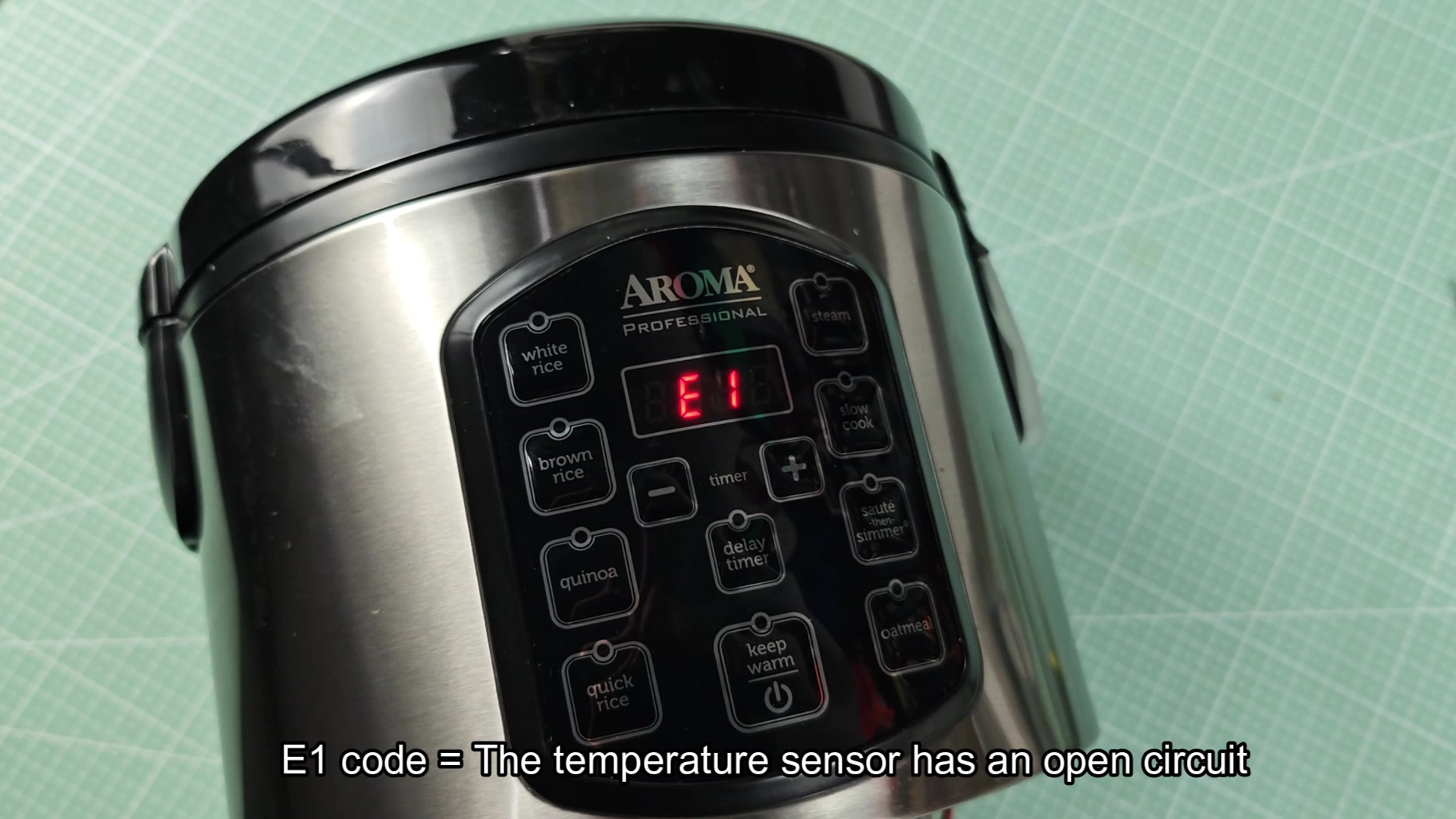

Saw the E1 code come up a few times when people is troubleshooting Aroma rice cookers and decided to post what I've read about it. The E1 code indicate an open circuit in the temperature sensor. Essentaly the cooker cannot read any signal from the sensor so it cannot start up to heat the pots.

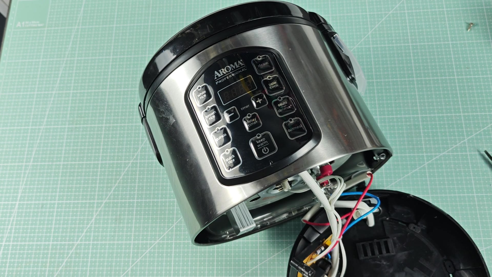

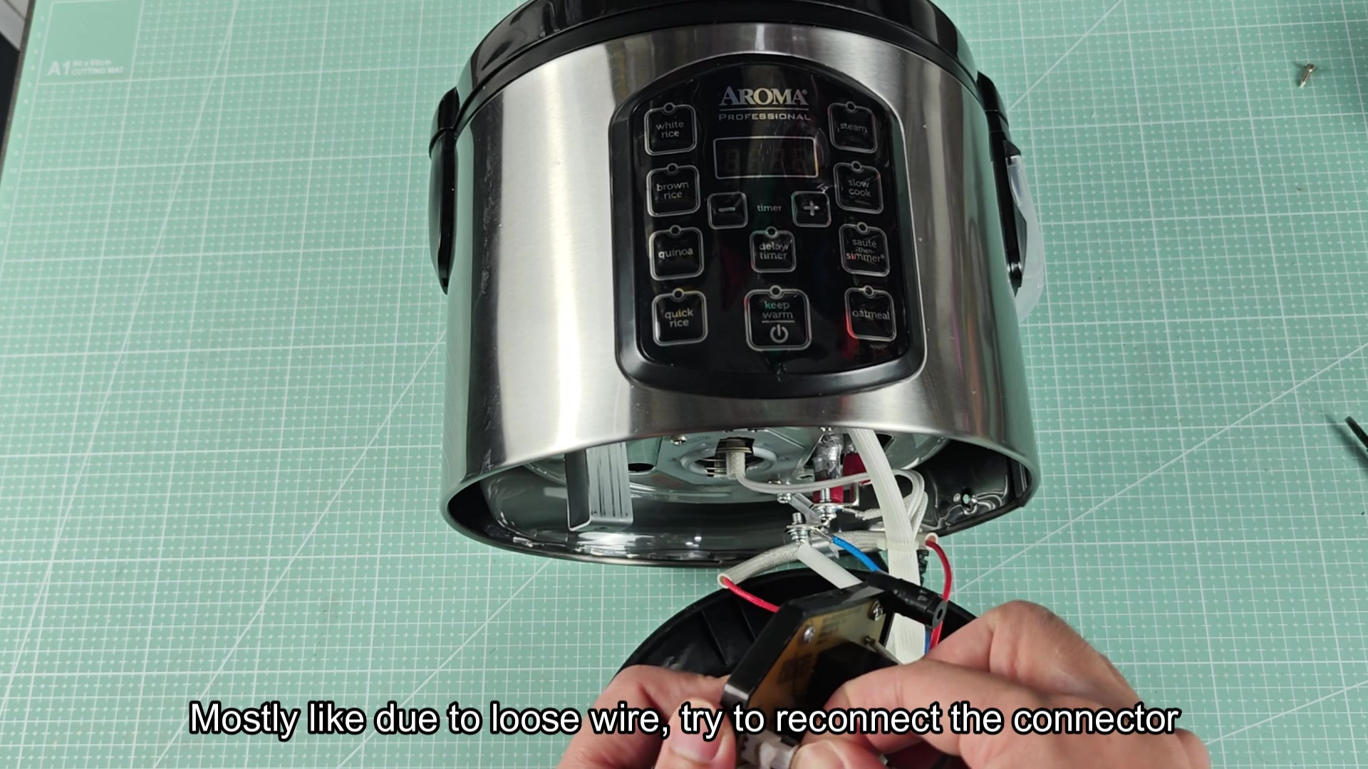

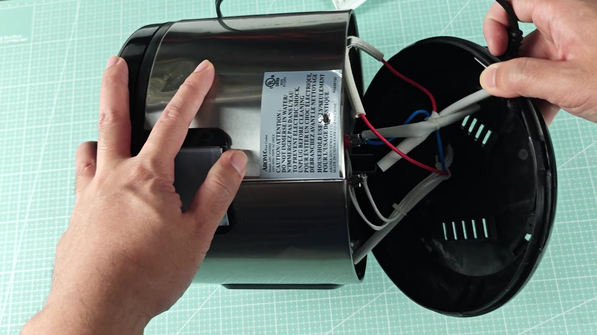

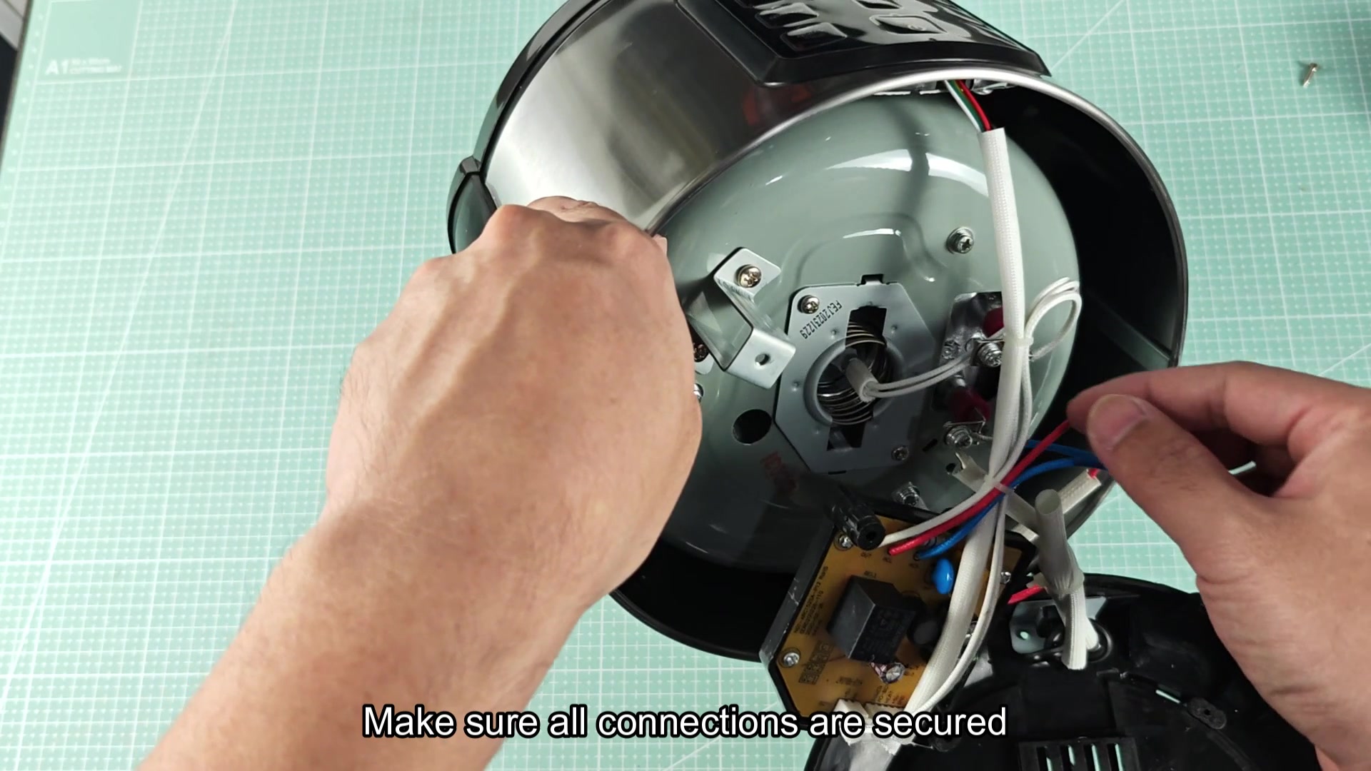

The suggestion is typically to open the machine up and inspect the sensor connection. Most of the time it isnt the sensor itself that is causing the issue, but instead one of the wires that is coming loose. If the sensor and connections check out, then you would have to replace the sensor itself.
