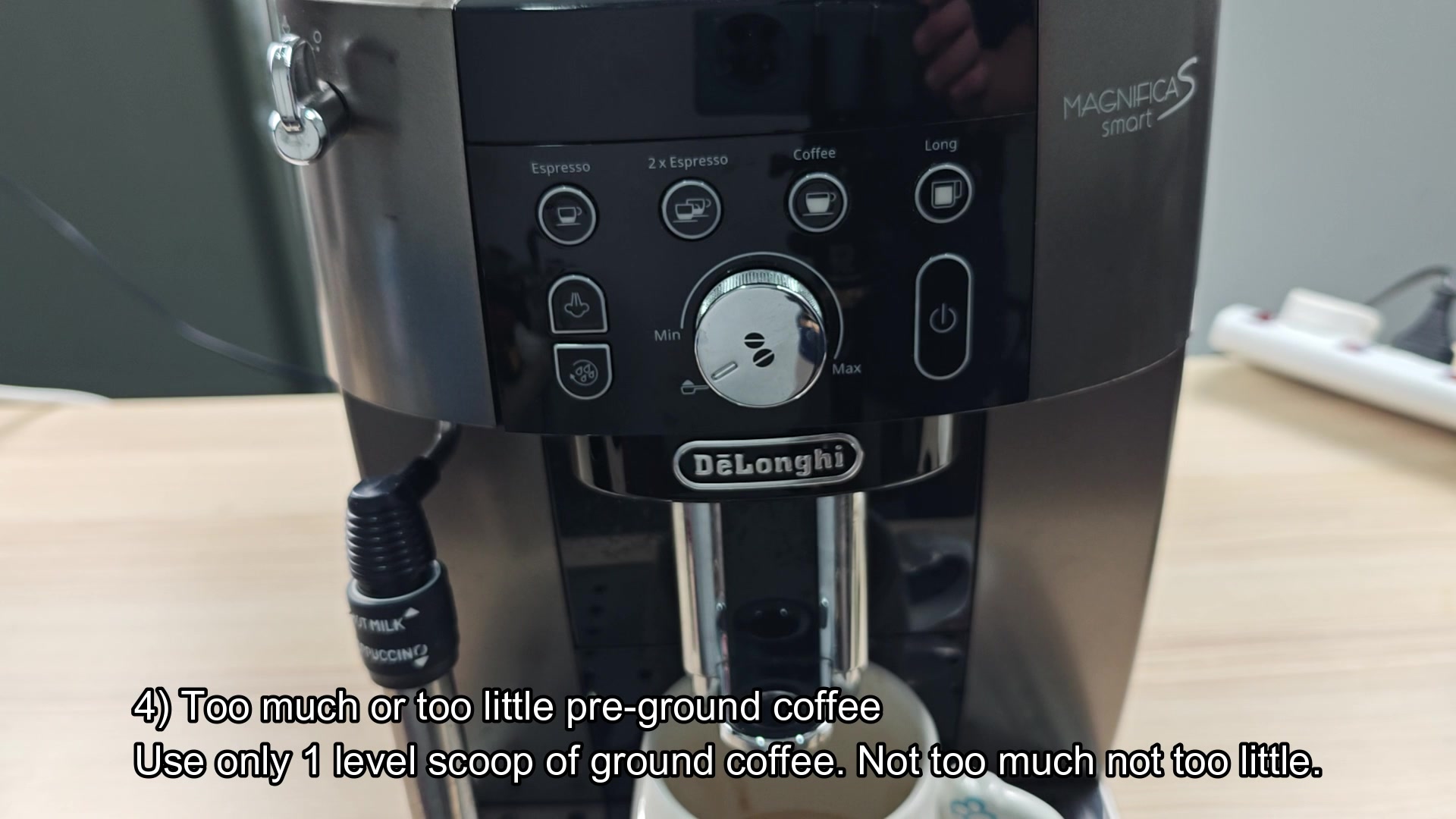

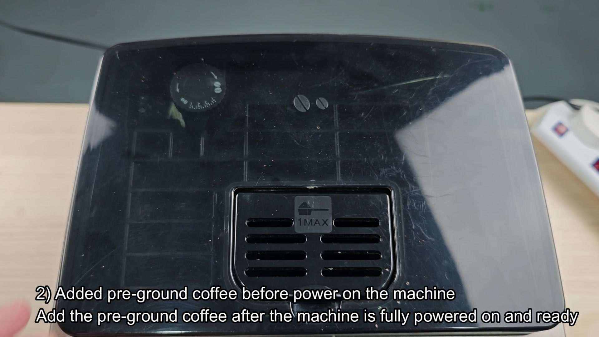

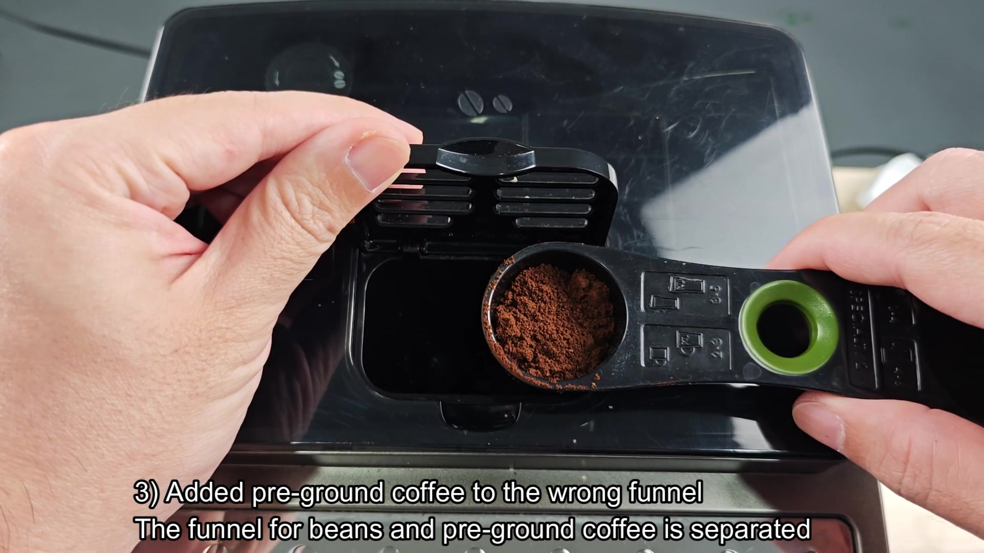

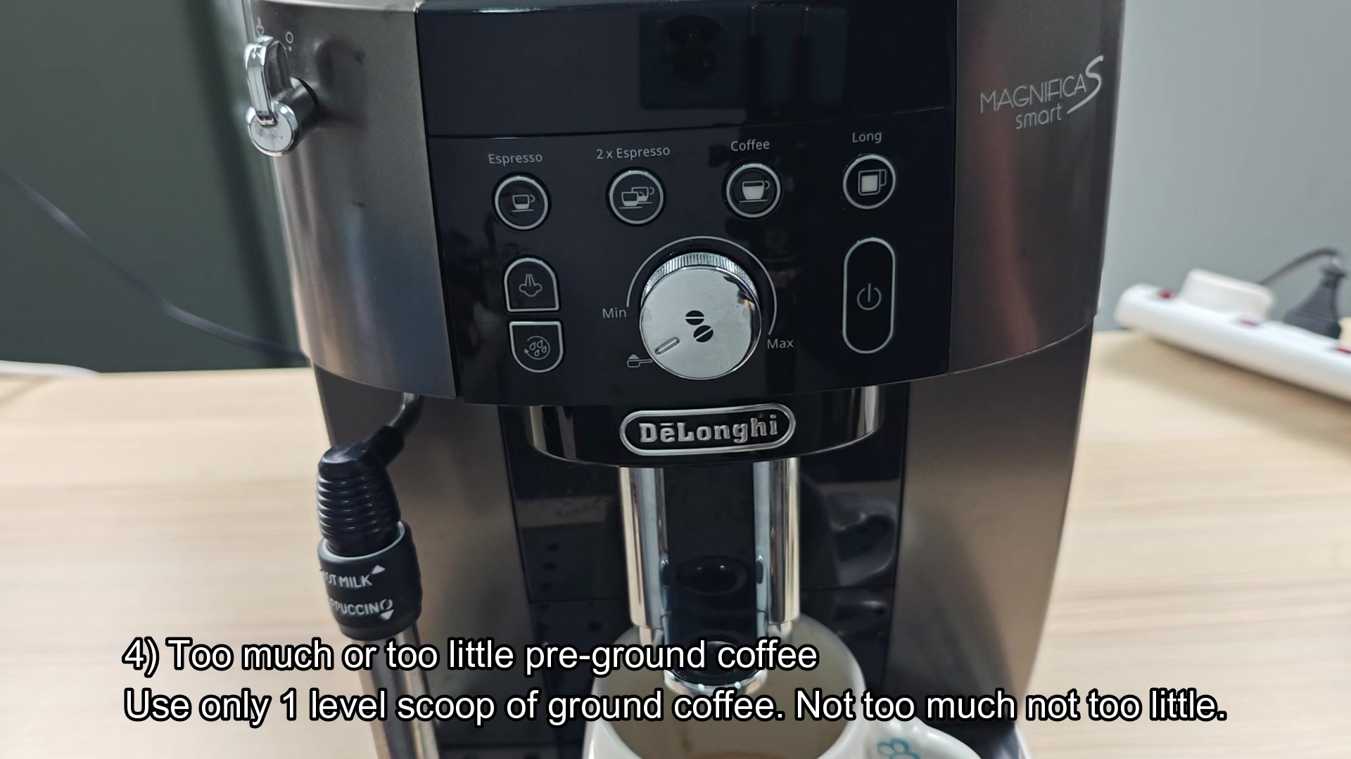

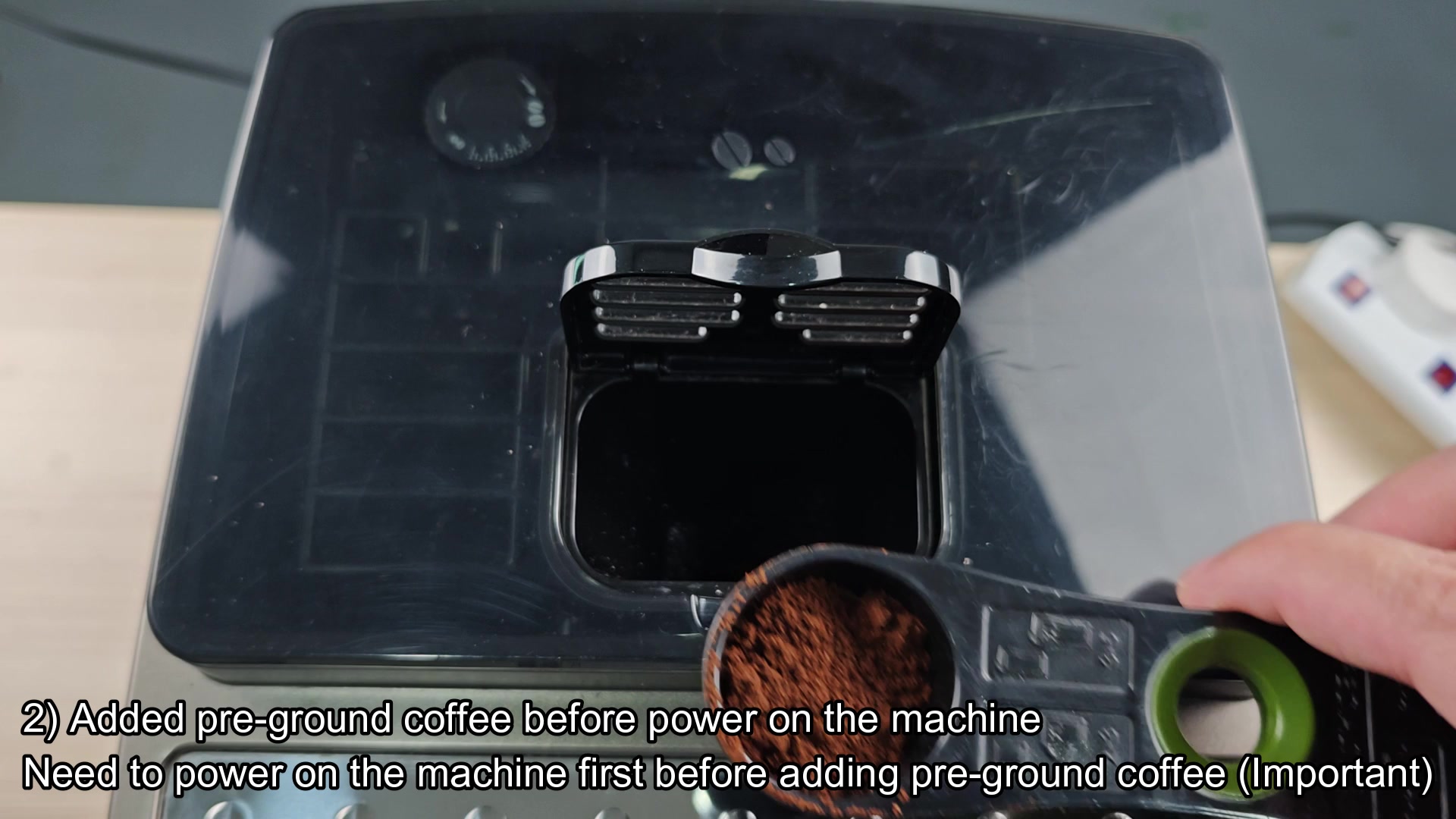

there are four main issues (as with any machine with this many feature and buttons):

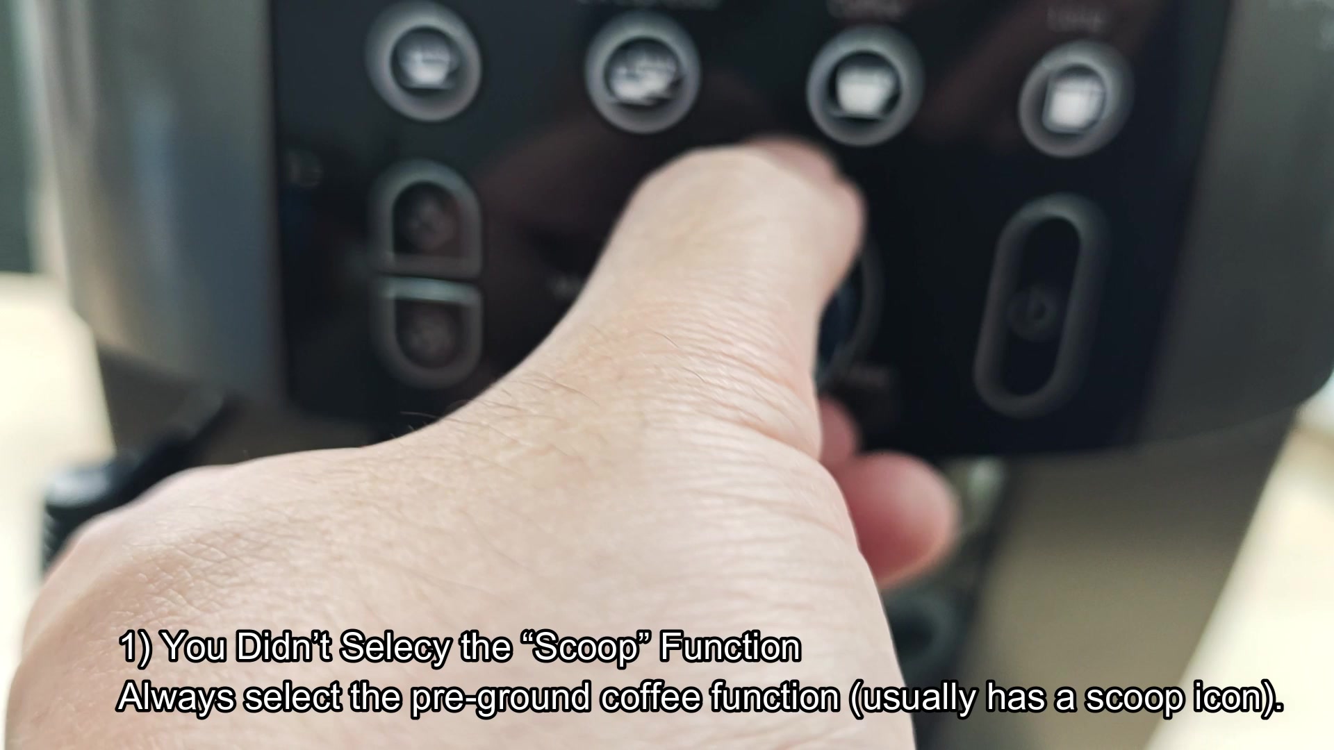

first is that you have to select the scoop mode for pre-ground beans prior to brewing. If not selected the machine will grind your beans as it normally would.

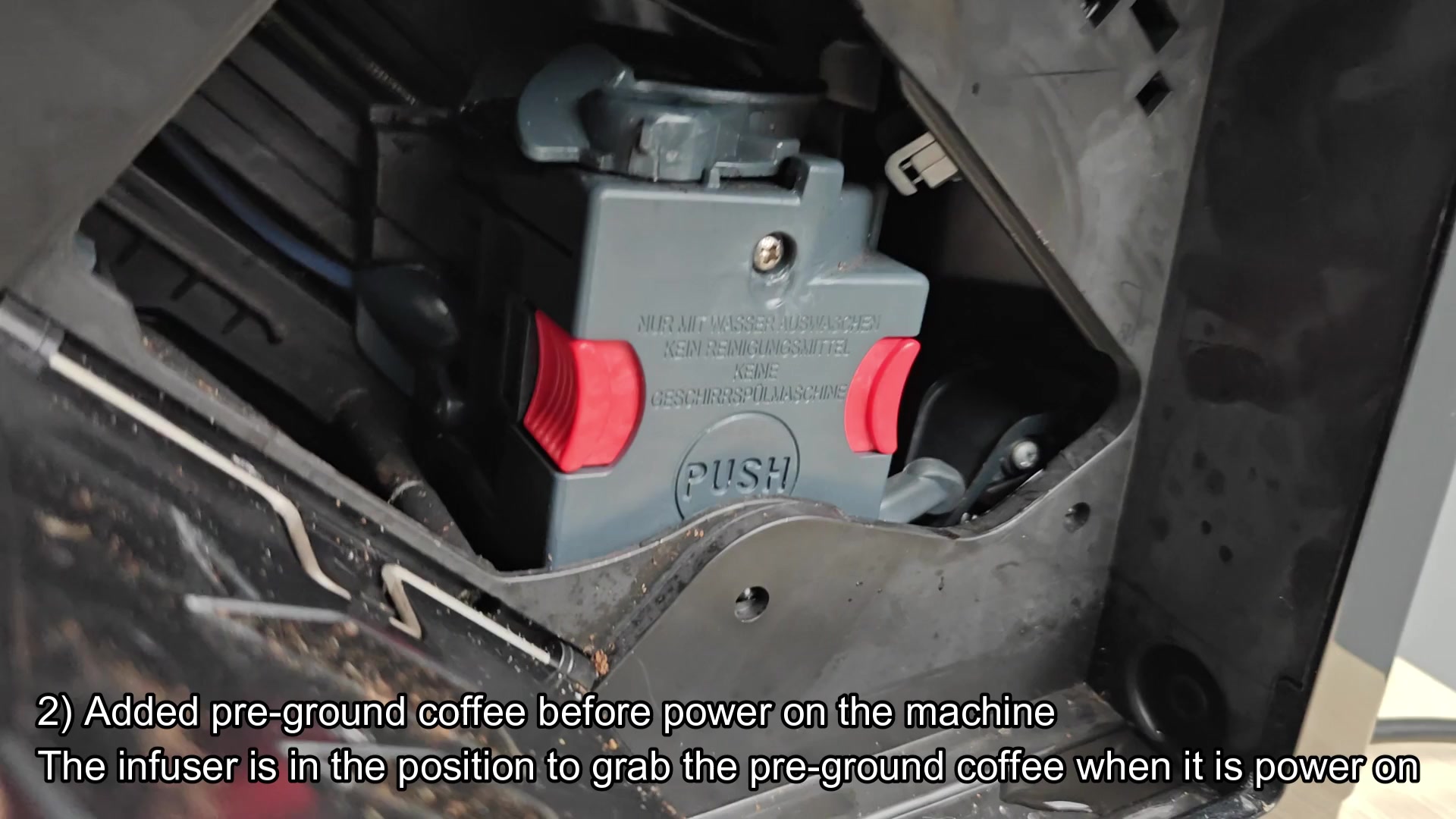

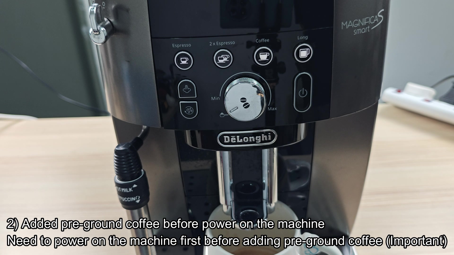

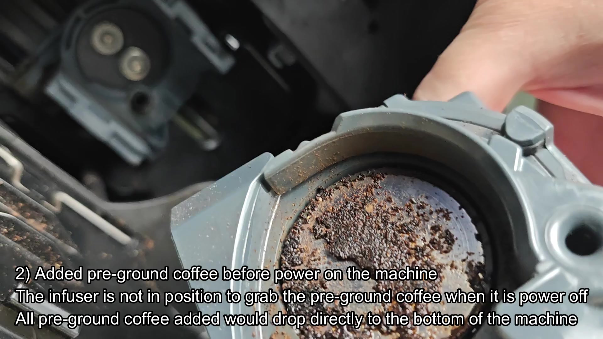

second is ensuring that you add the pre-ground beans before the machine is fully power on and ready to brew.
third is correctly placing the grounds into a proper funnel. The bean hopper is right next to the pre-ground bean funnel so it is easy to mistakenly place the grounds into the bean funnel.
fourth is using the correct amount of ground beans. Ensure it is levelled to one scoop only. Neither more nor less or the machine will fails to properly brew your coffee.

funnel thing got me for like 3 weeks when i first got mine. I was constantly putting my grounds into the bean hopper rather than the funnel for pre-ground beans. Stupid layout by de longhi.

wait does the scoop that comes with the magnifica actually measure the proper dose? i thought it was around 7g but not for sure.
