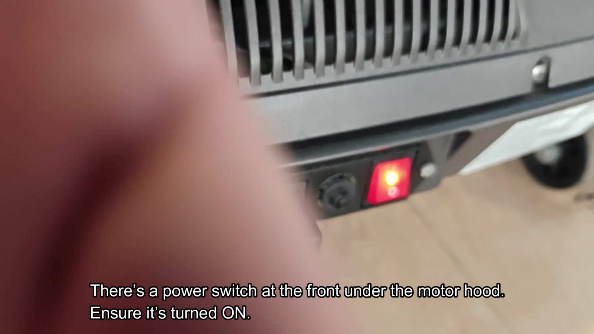

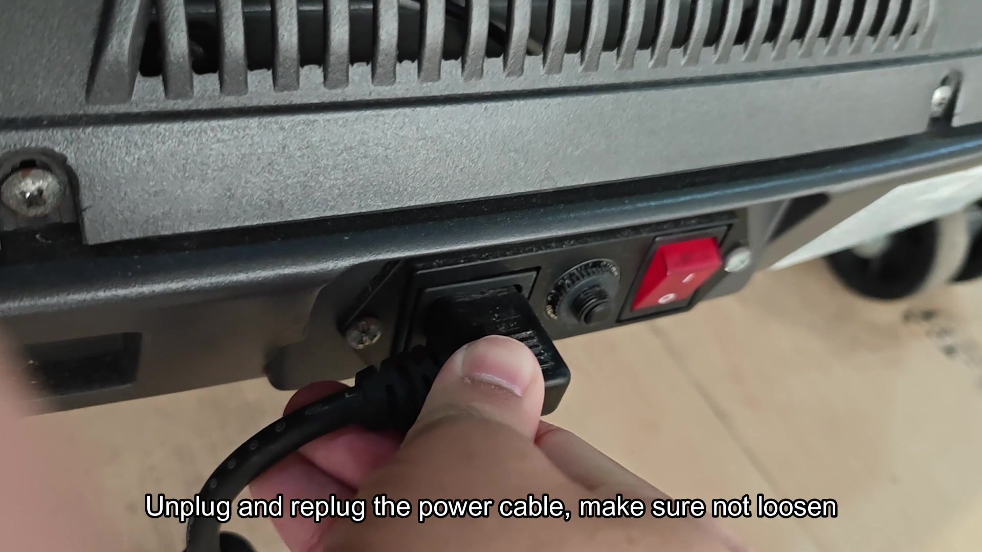

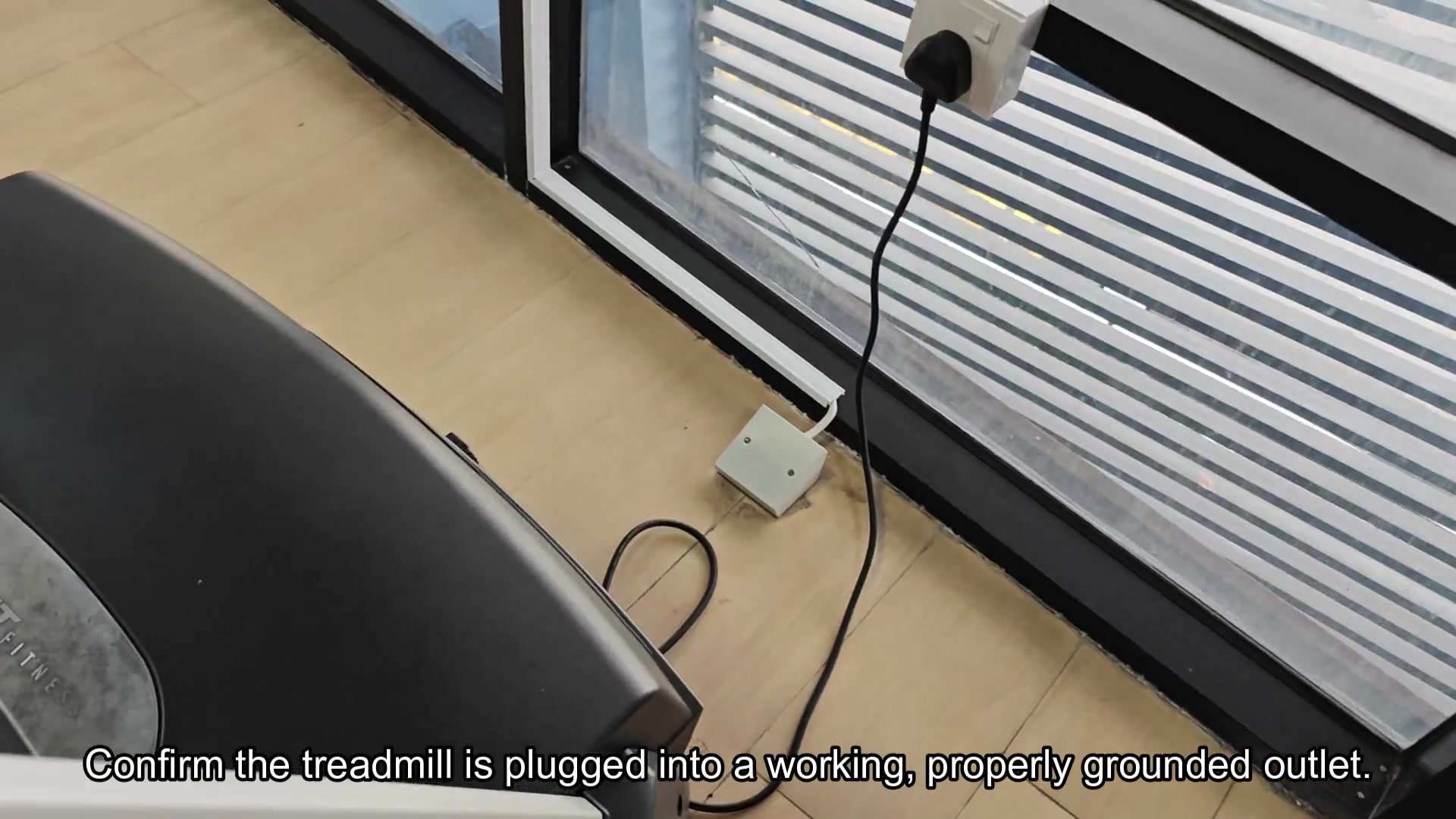

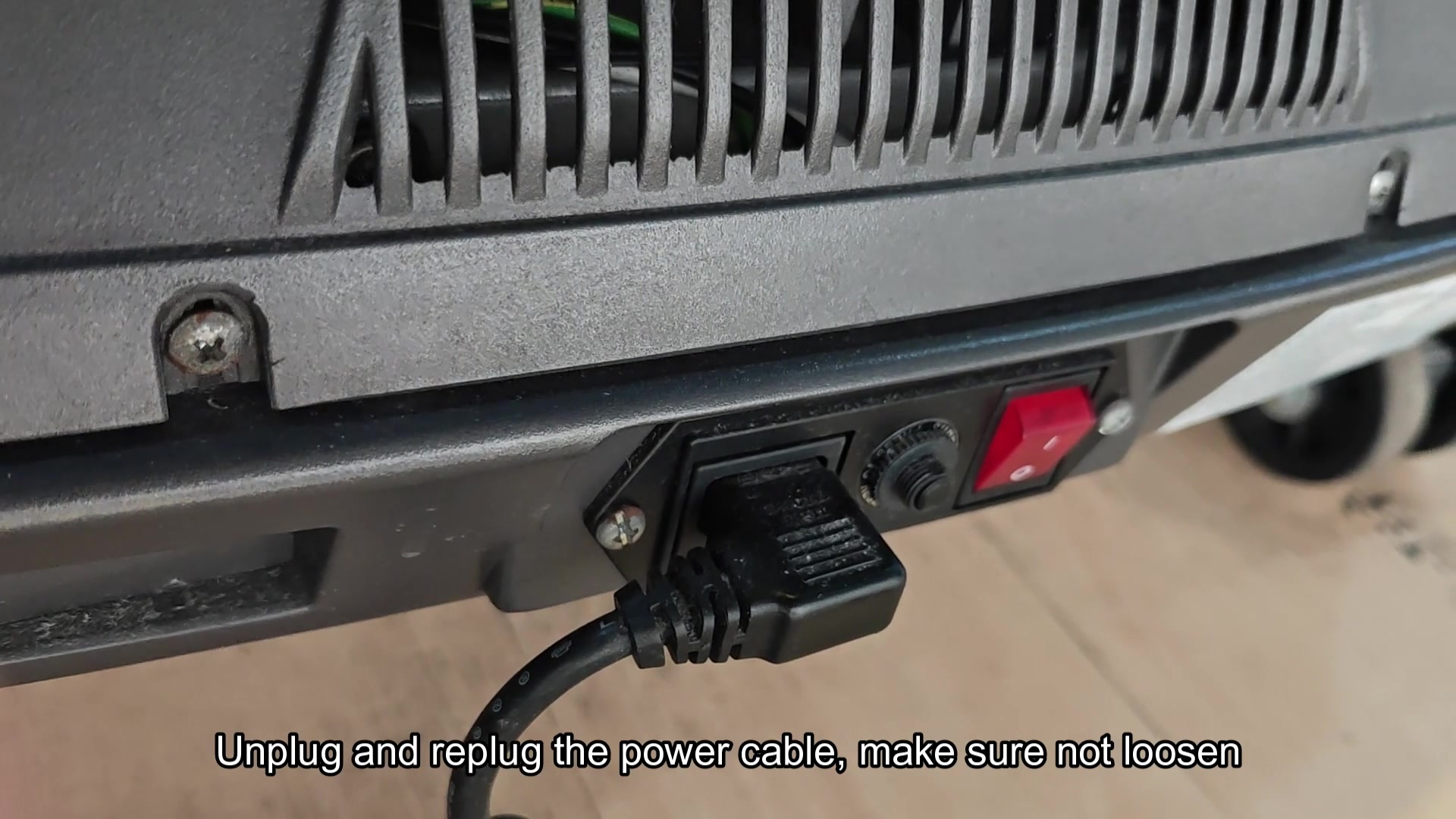

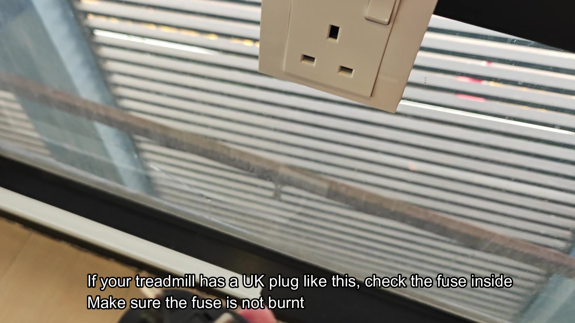

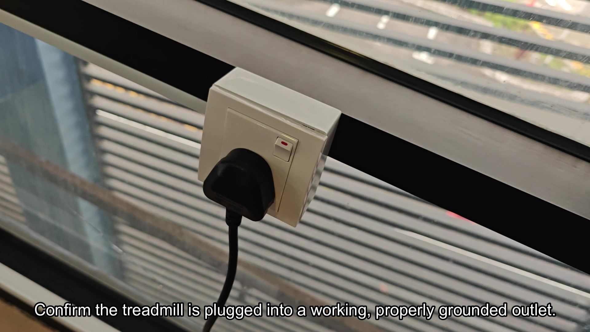

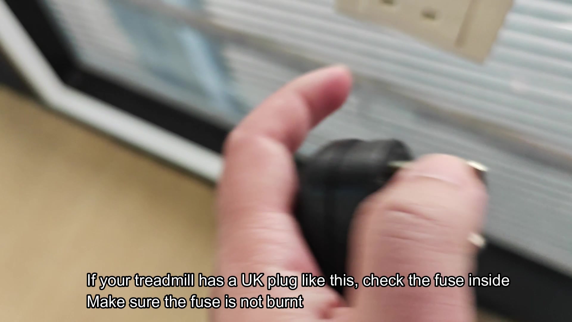

Power source, on/off switch, safety key, and for those using UK electrical plugs, the fuse in the power cord are the place to start.

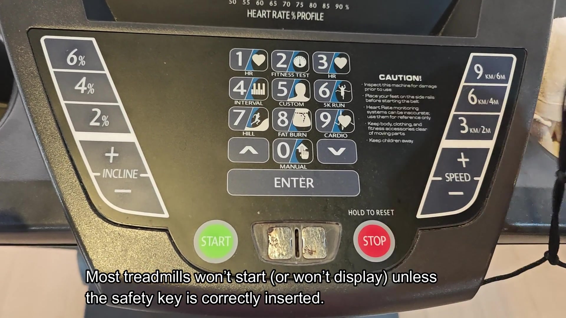

9 times out of 10 the safety key has developed gunk that prevents contact or the magnet fell out of the safety key itself. People dont realize that the magnets on the safety key can fall out and roll under the treadmill belt.

wait the safety key has a magnet in it? I always thought it was just a mechanical switch
Yep. On the console side it’s a reed switch and on the plastic key there’s a neodymium magnet. Cheap design but it works until the magnet eventually falls out of the key. Test it by holding any fridge magnet up to the slot on the console. If the console wakes up, the safety key is dead.

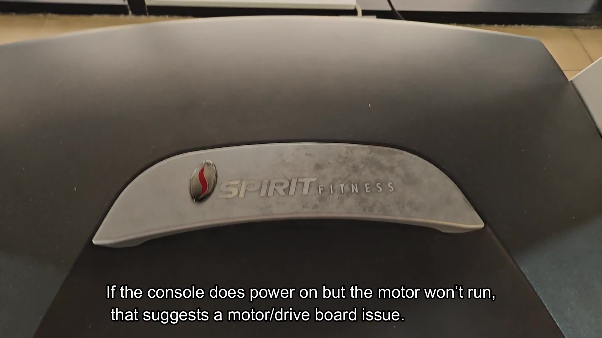

Tripped internal breaker on the motor is another common one on the Spirit treadmills that people dont consider. On the XT685 models there is a thermal reset button on the motor housing itself. It’s under the hood on the motor but you can feel it and you have to press it to reset the motor internal breaker. I pressed it once when I was done exercising and it fixed the issue.
