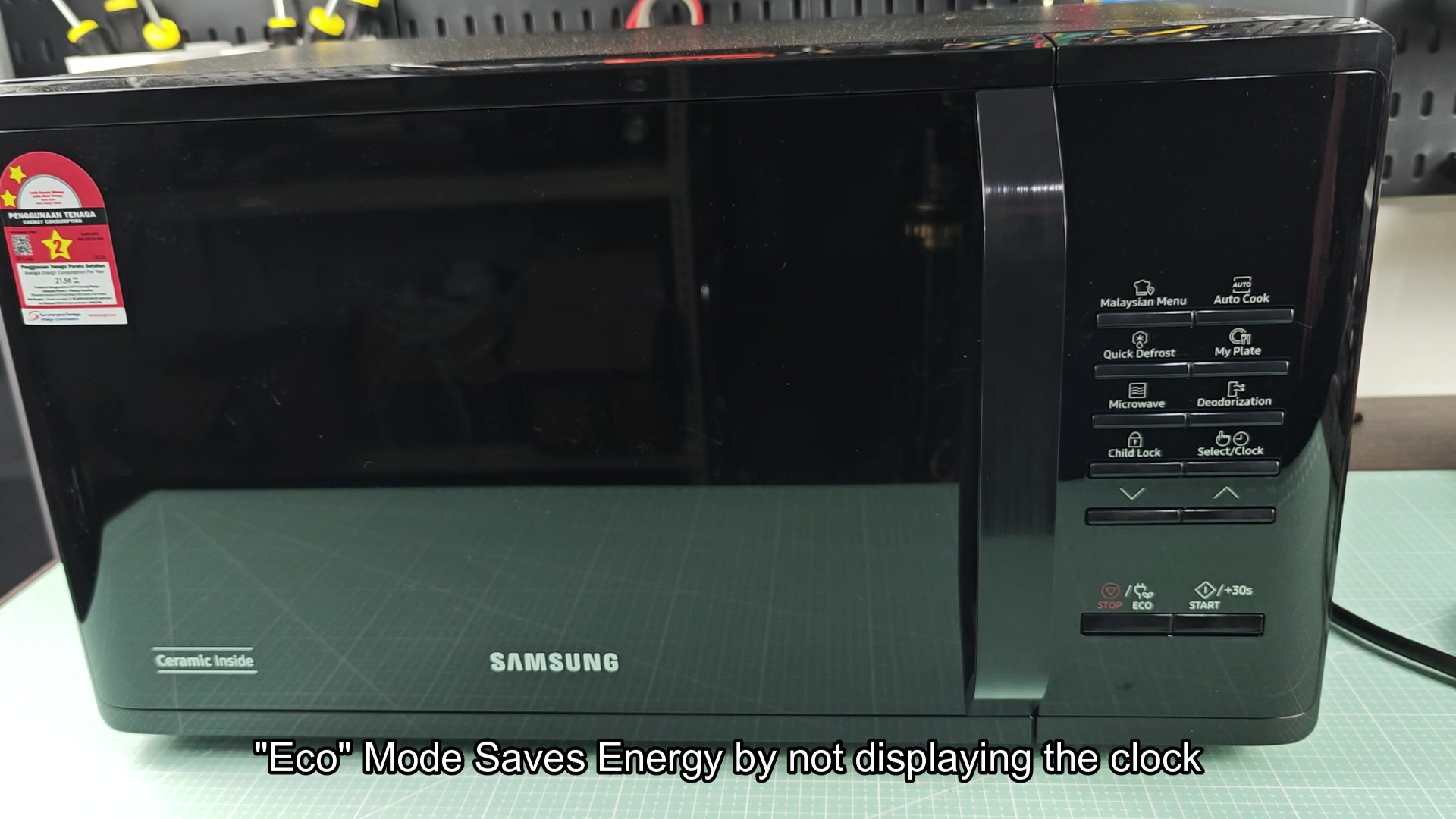

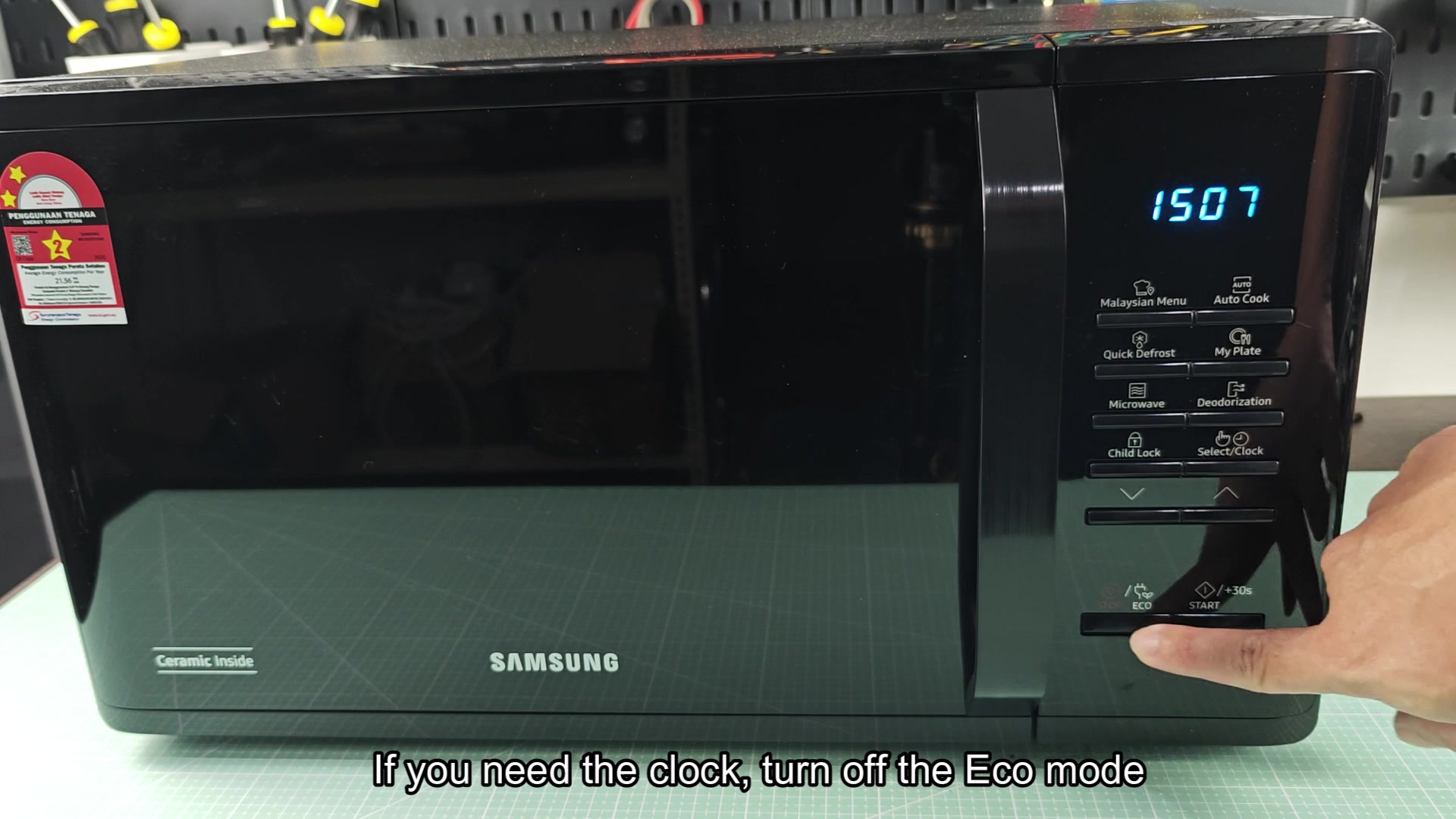

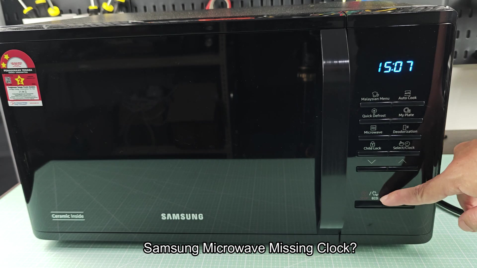

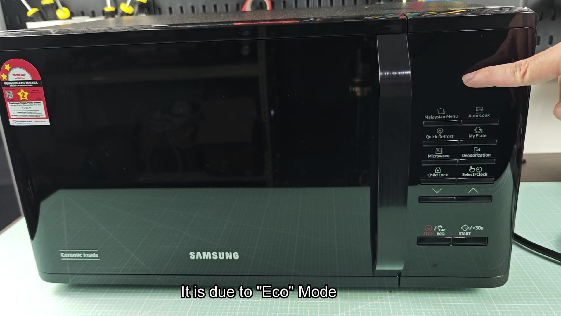

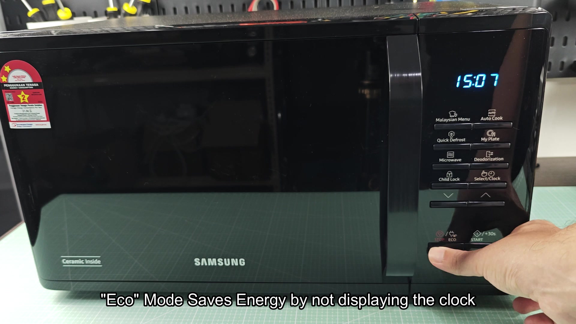

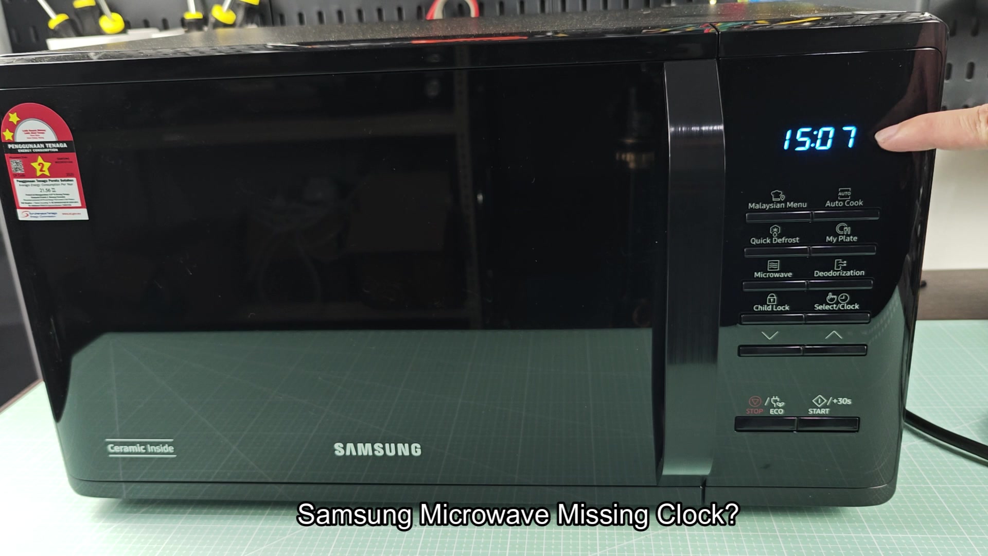

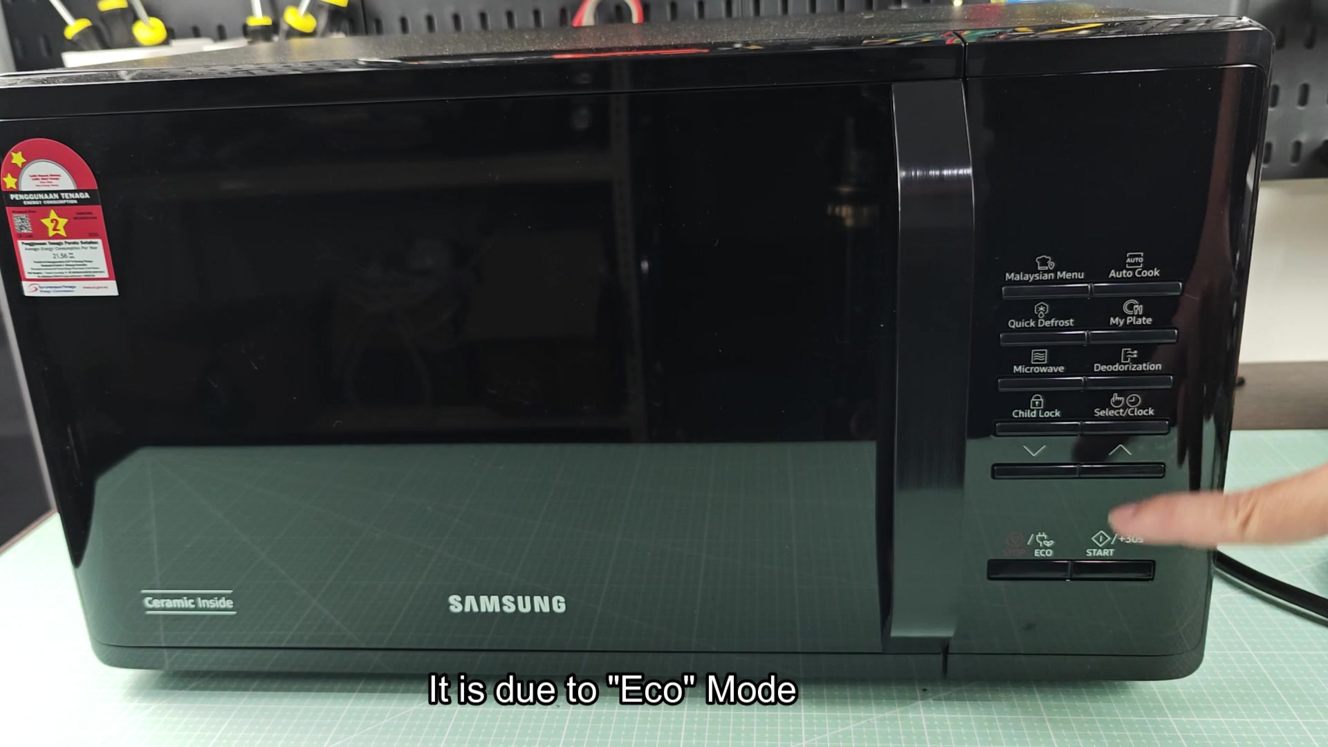

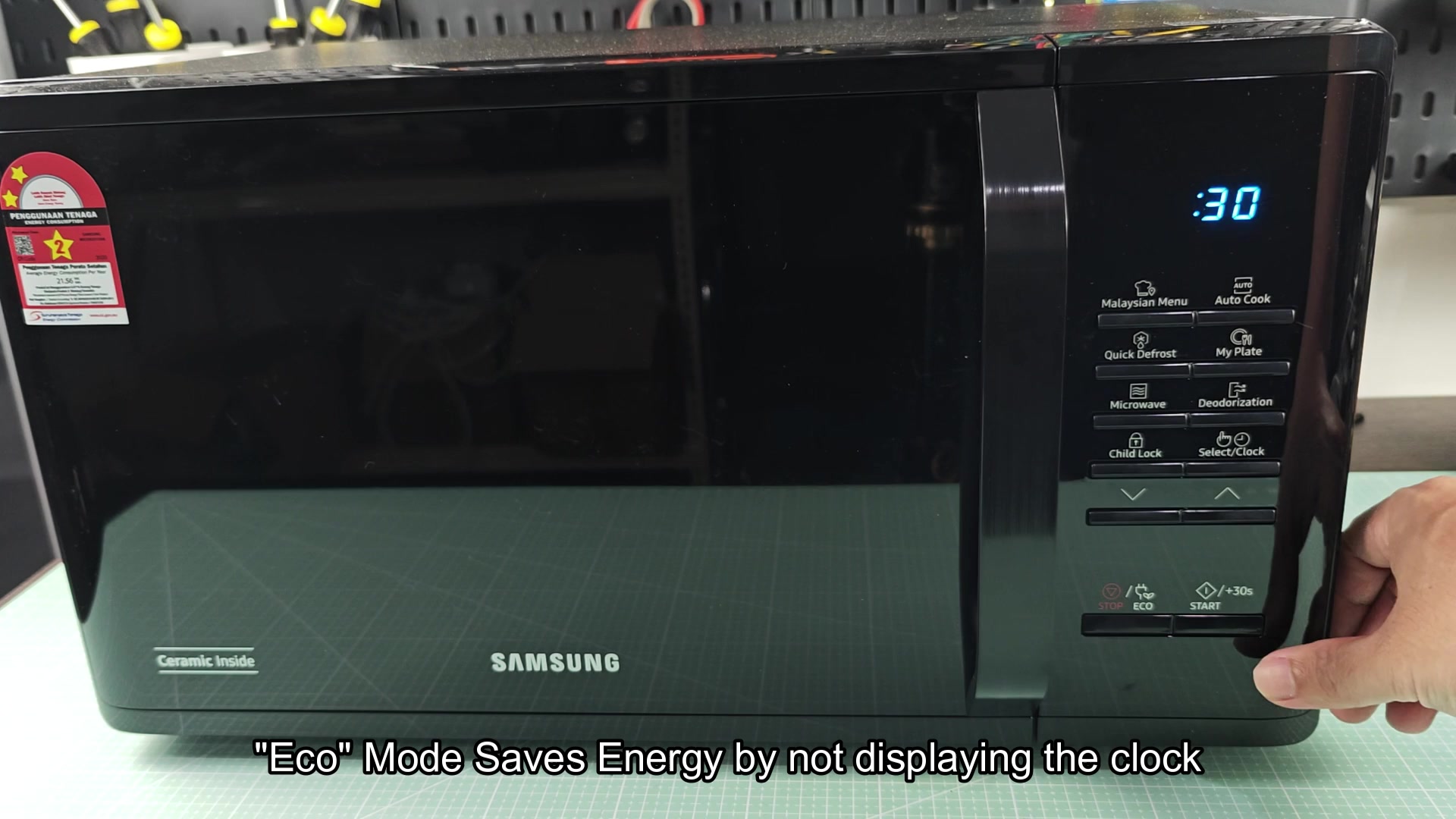

A few peoples has asked about this in the past. When you have a Samsung microwave and the clock read nothing, it isnt the board, not the display. It's just Eco Mode. Turn that off and the clock will come back on.
Makes sense, right? Saves powers when the microwave isnt being used. But why would anyone turn this on? Probably accidental when buying the appliance. Or, maybe it comes on factory default. Either way, it's a total normal issue and resolution. No error code, no fault finding, just flip the setting and go about your day.
Have any of you encountered someone thinking their microwave is broken when it's just this setting? Should be much more obvious in the manual... ? Are there downsides to leaving this off all the time besides the negligible standby power draw from the clock?
