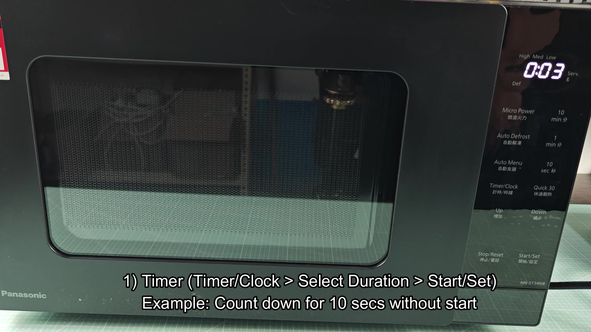

Timer buttons: Timer/Clock, duration, Micro Power, Time/Clock, duration, Start/Set. Timer only function as a countdown timer with no cooking function.

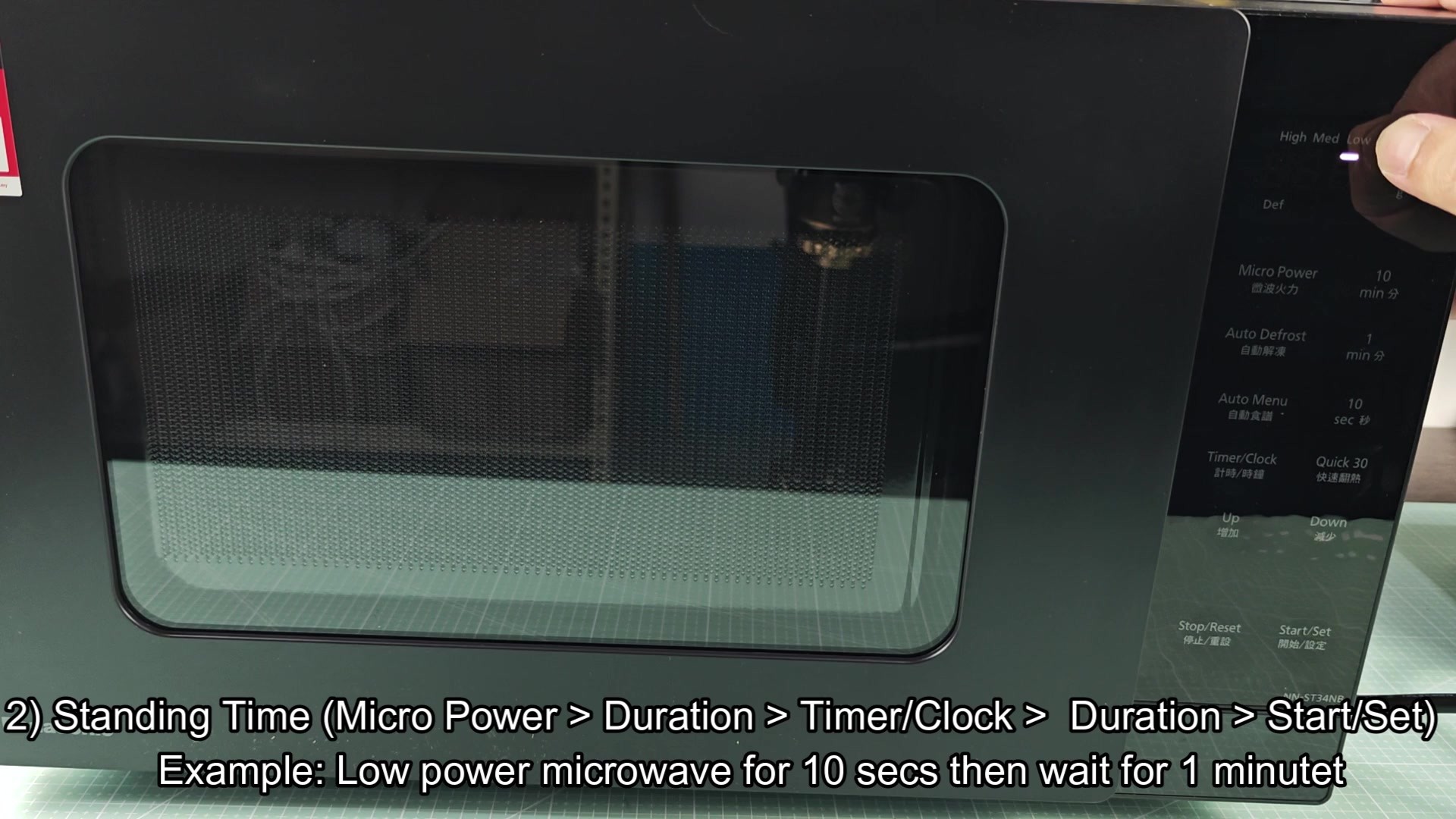

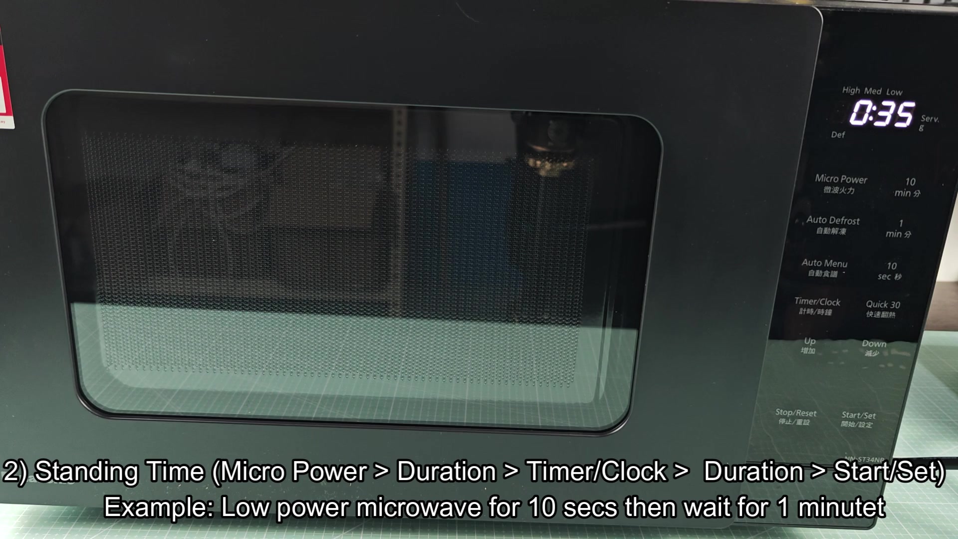

Standing Time: Micro Power, duration, Time/Clock, duration, Start/Set, Adds a standing time/rest period after cooking is complete.

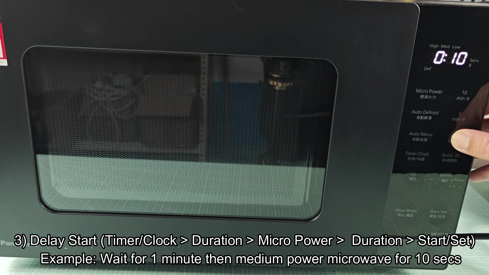

Delay Start: Time/Clock, duration, Micro Power, duration, Start/Set, Cooks at a later time after the delay period. The only difference between Standing and Delay Time is the order of the buttons for Micro Power and Time/Clock.
