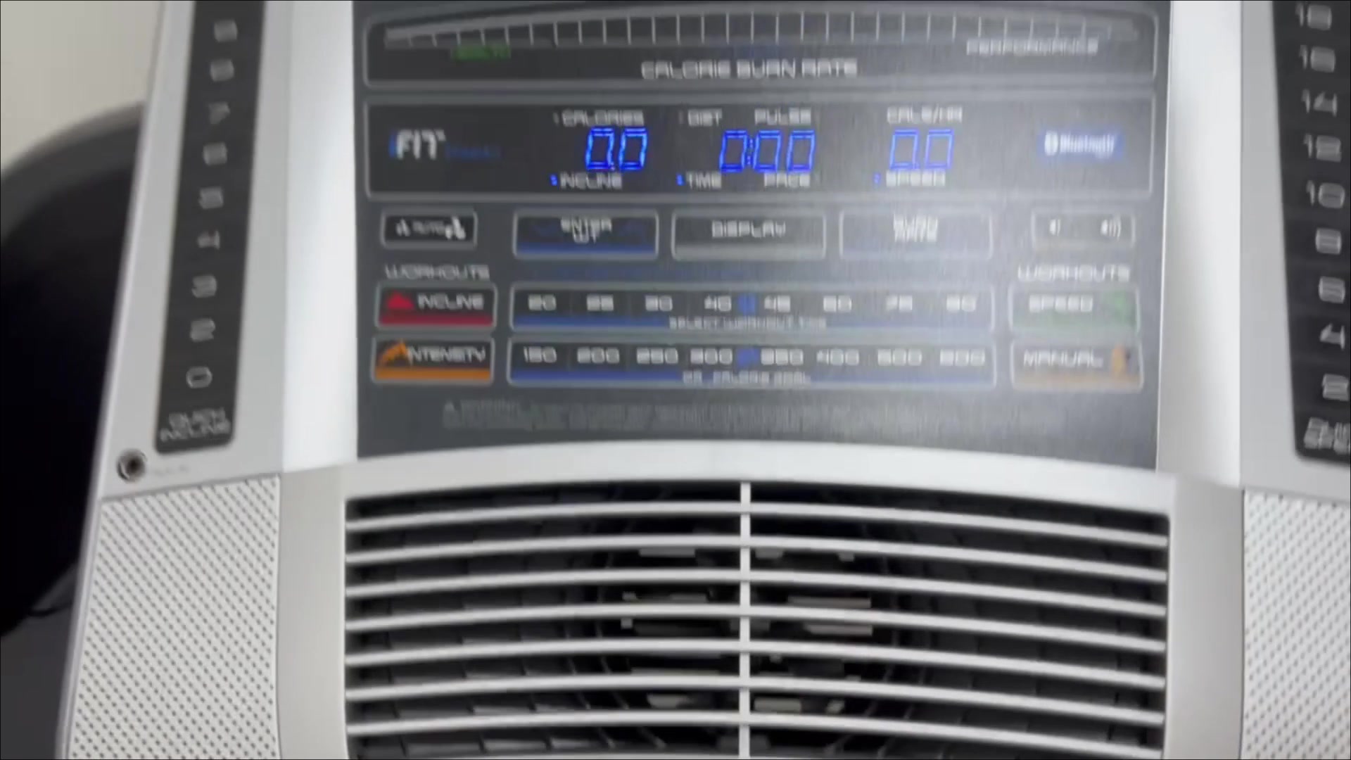

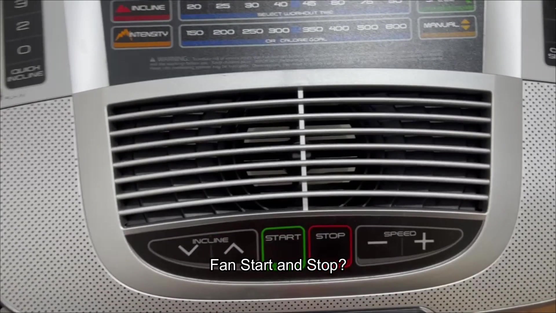

Saw this in a few different threads so figured I’d ask here since people seems to know about the NordicTrack stuff. When you press the button the fan beep but does not spin. The other issue is that the fan will run for a few seconds then automatically turn its self off.
This seem to be a common issue with a few of the treadmill models. For this fan issue, is it typically the console/board, the fan motor itself or the wiring/connector?
