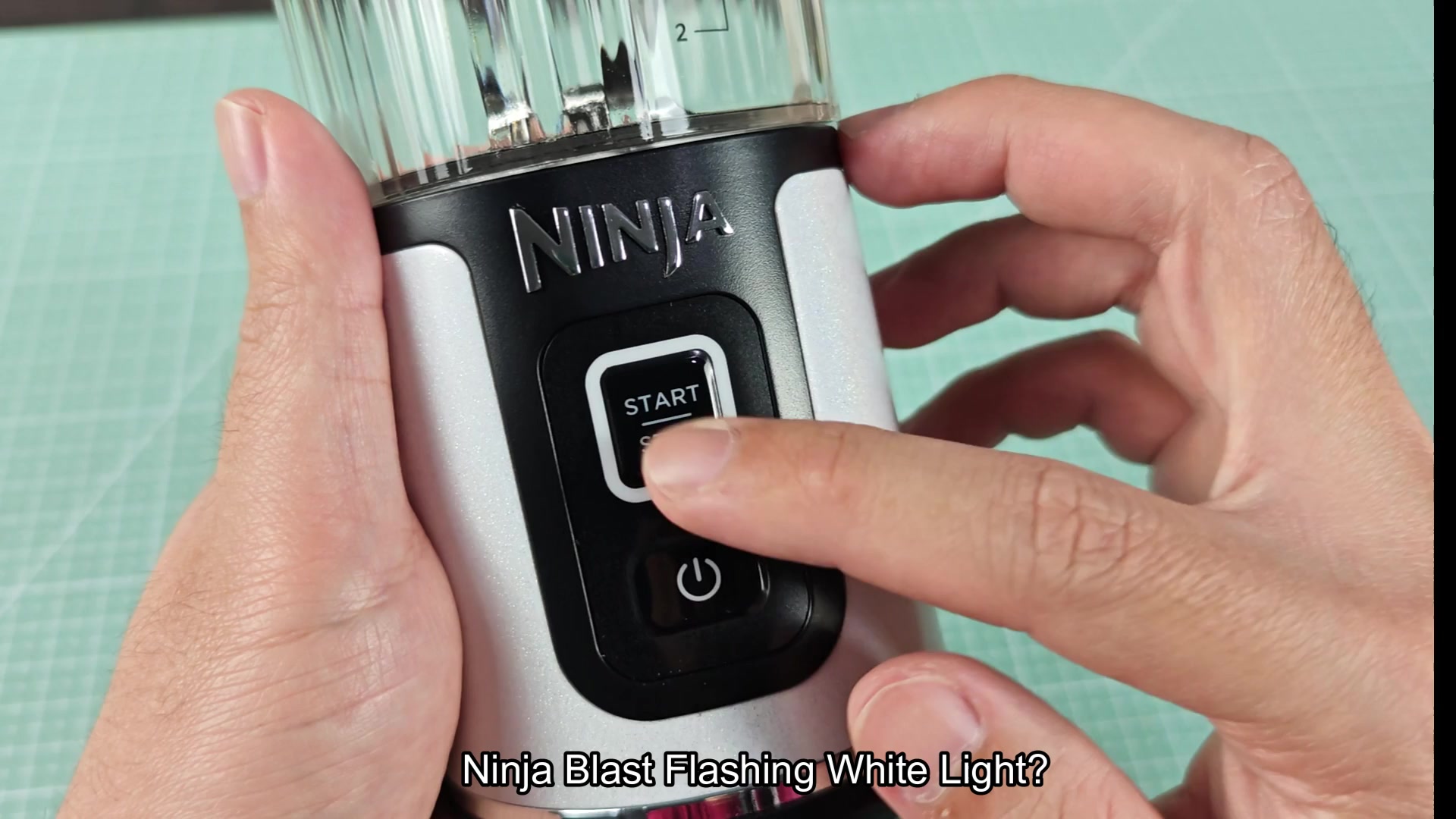

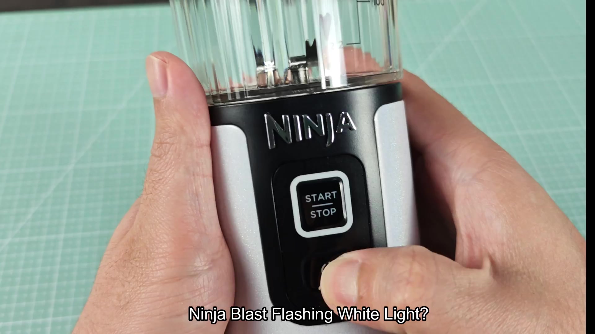

While I was out looking for someone with a Ninja Blast blender who was willing to lend it to me, I saw a couple of posts about the white flashing light on these device so figured I’d try to start a thread about it.

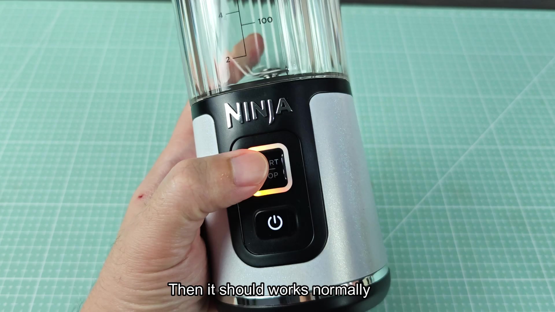

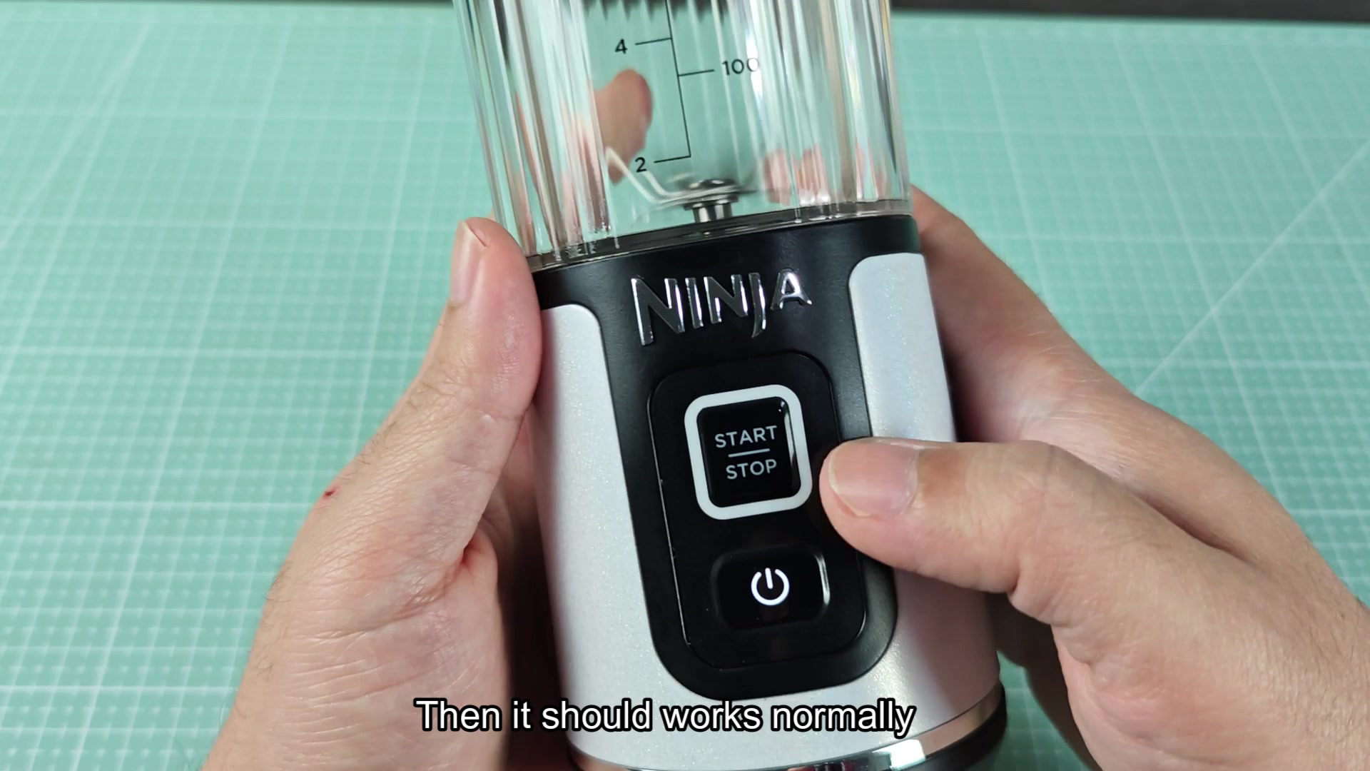

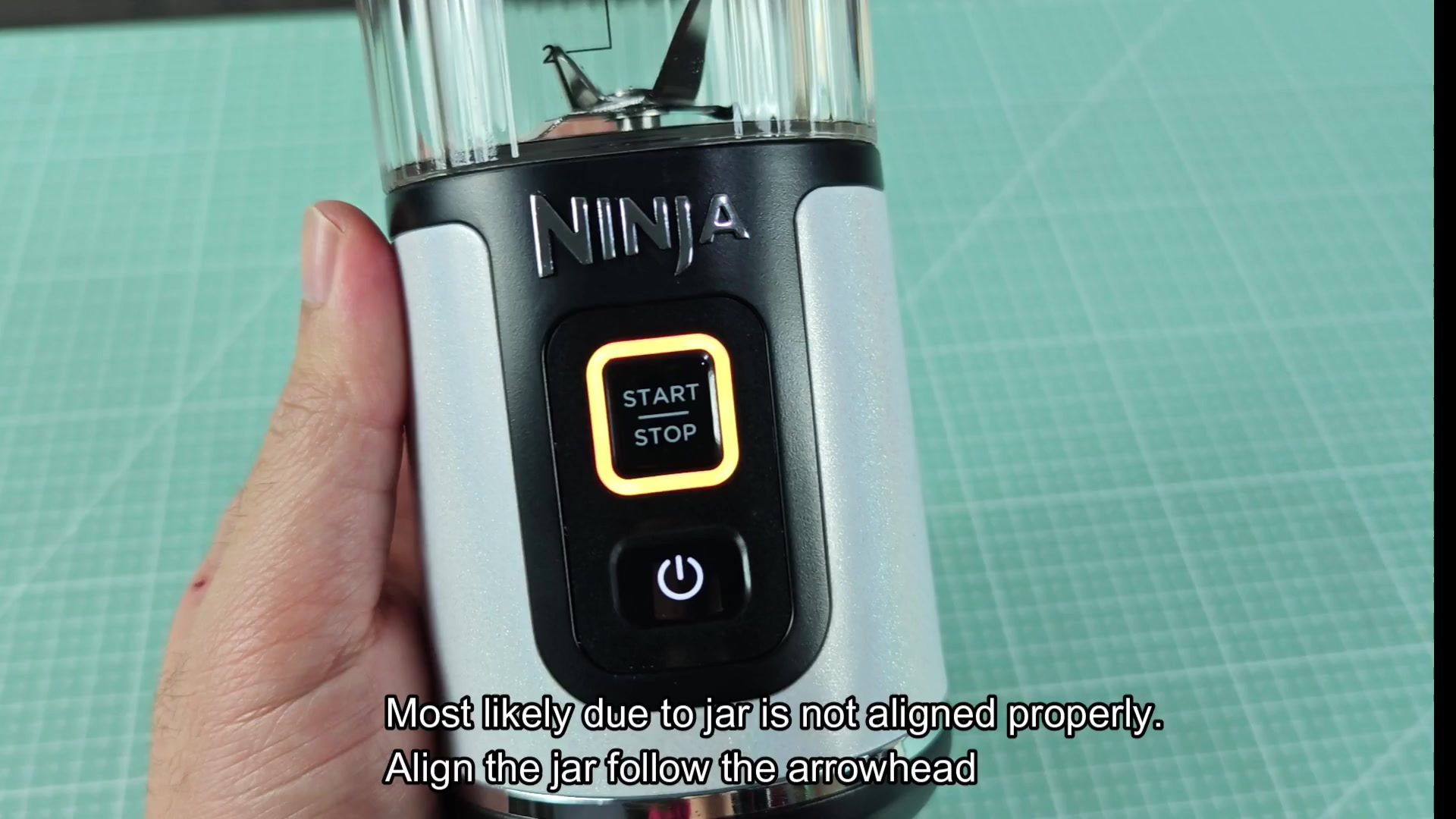

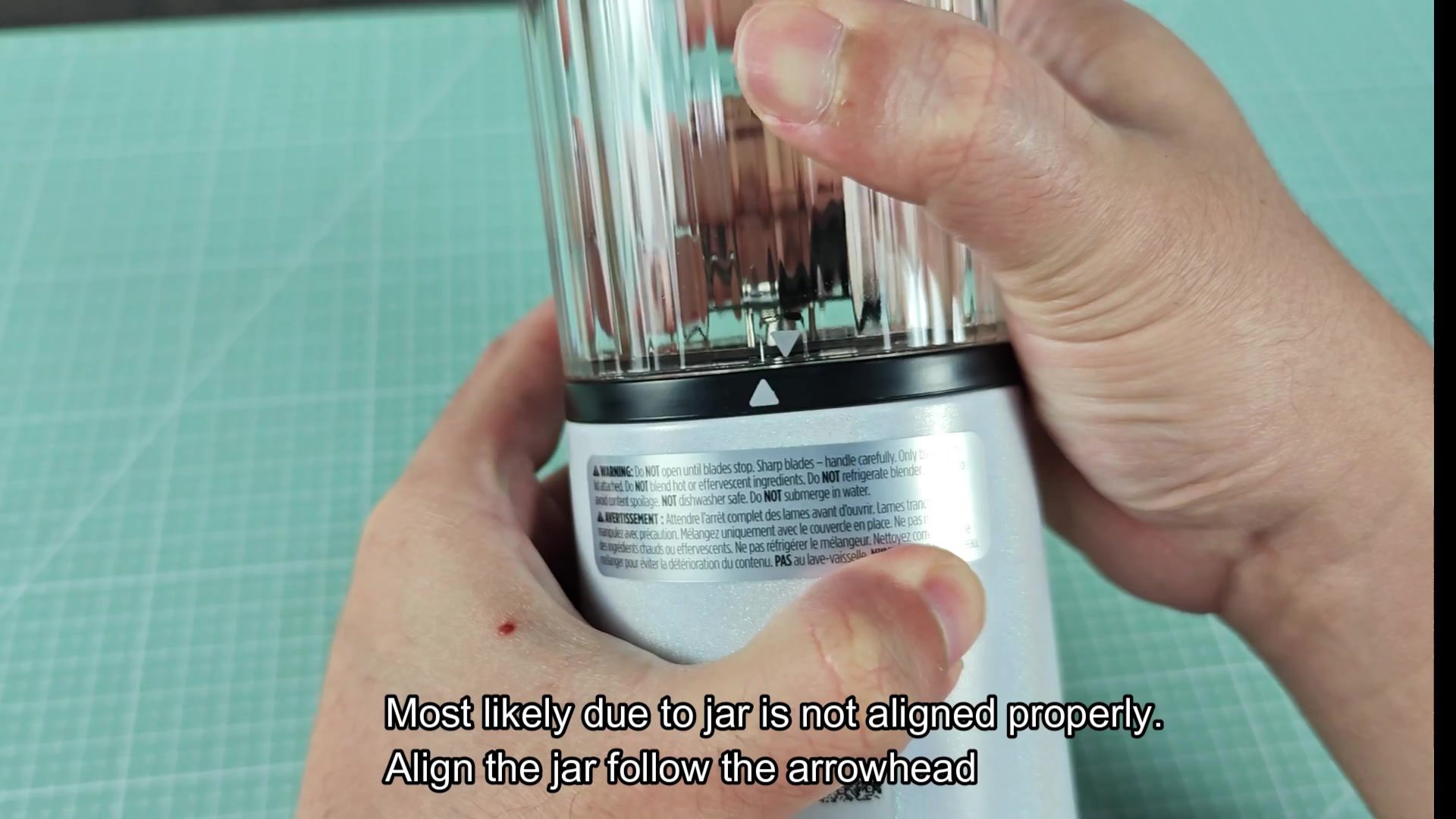

The white flashing light indicate that the jar is not properly seated onto the base of the blender. The jar has an arrow on it that need to line up with an arrow on the base of the motor. When this isnt true, the blender will not start. When the jar is properly rotated into place, the blender will starts right away.
Has anyone had experience with the blender flashing this error code despite having properly aligned the jar to the motor? Perhaps the microswitch under the jar got covered in smoothie residue and is no longer performing proper?
