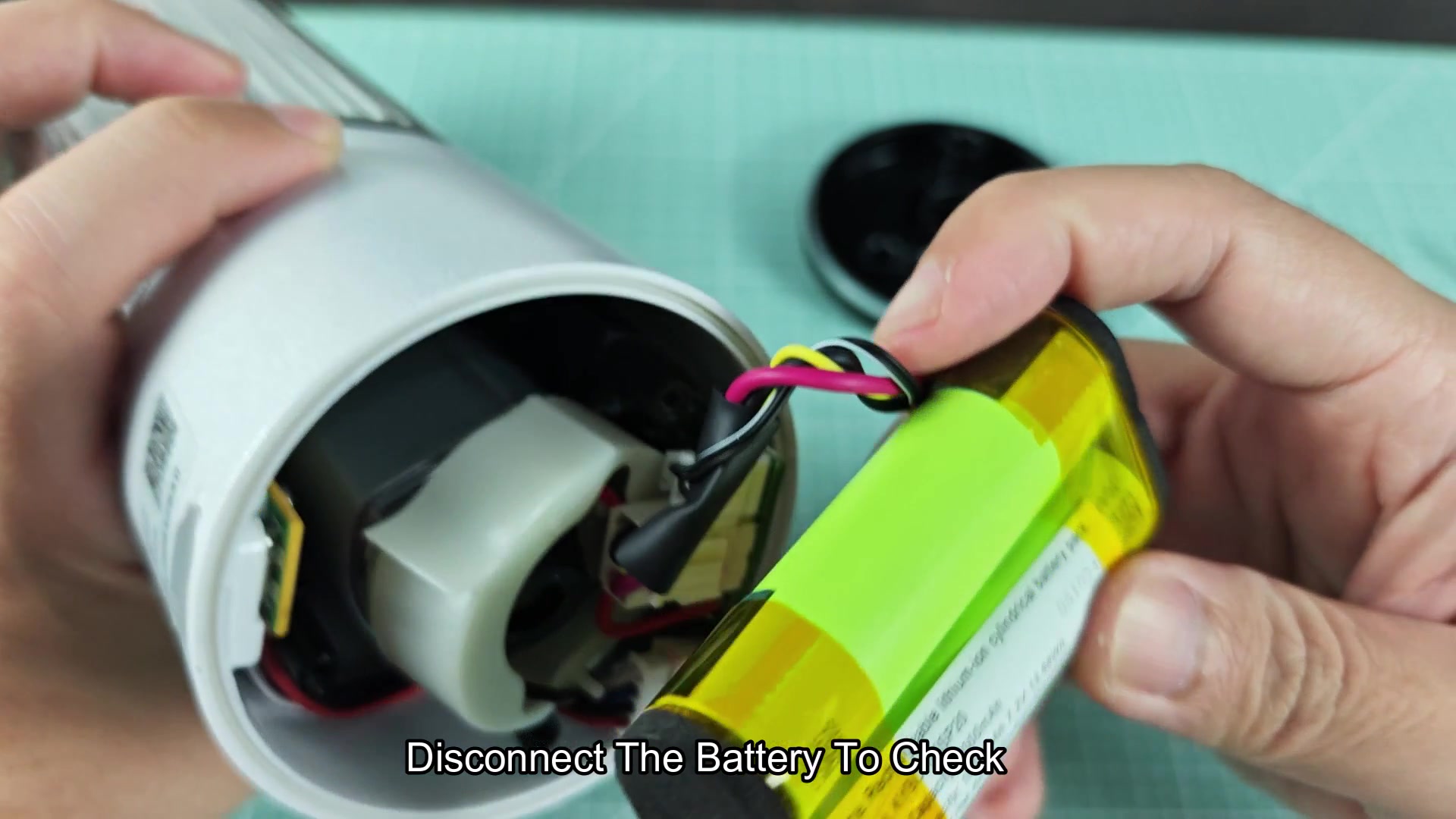

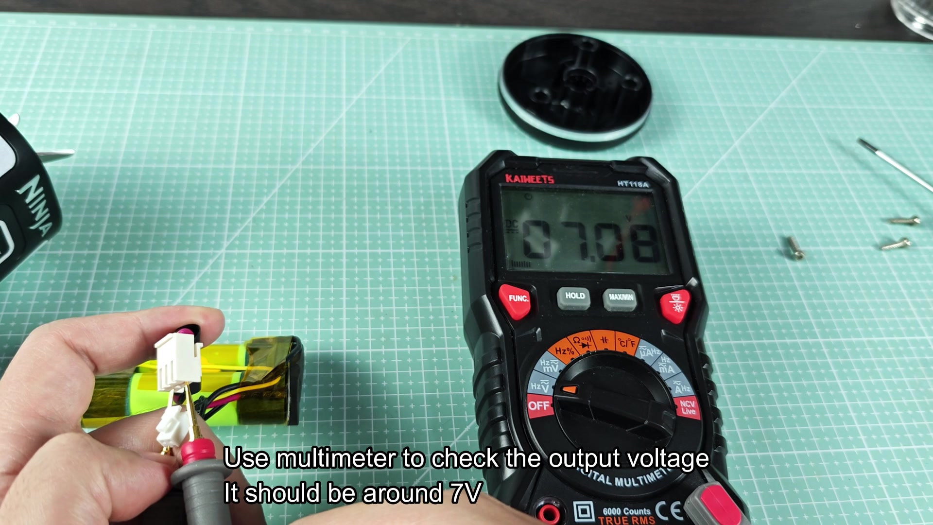

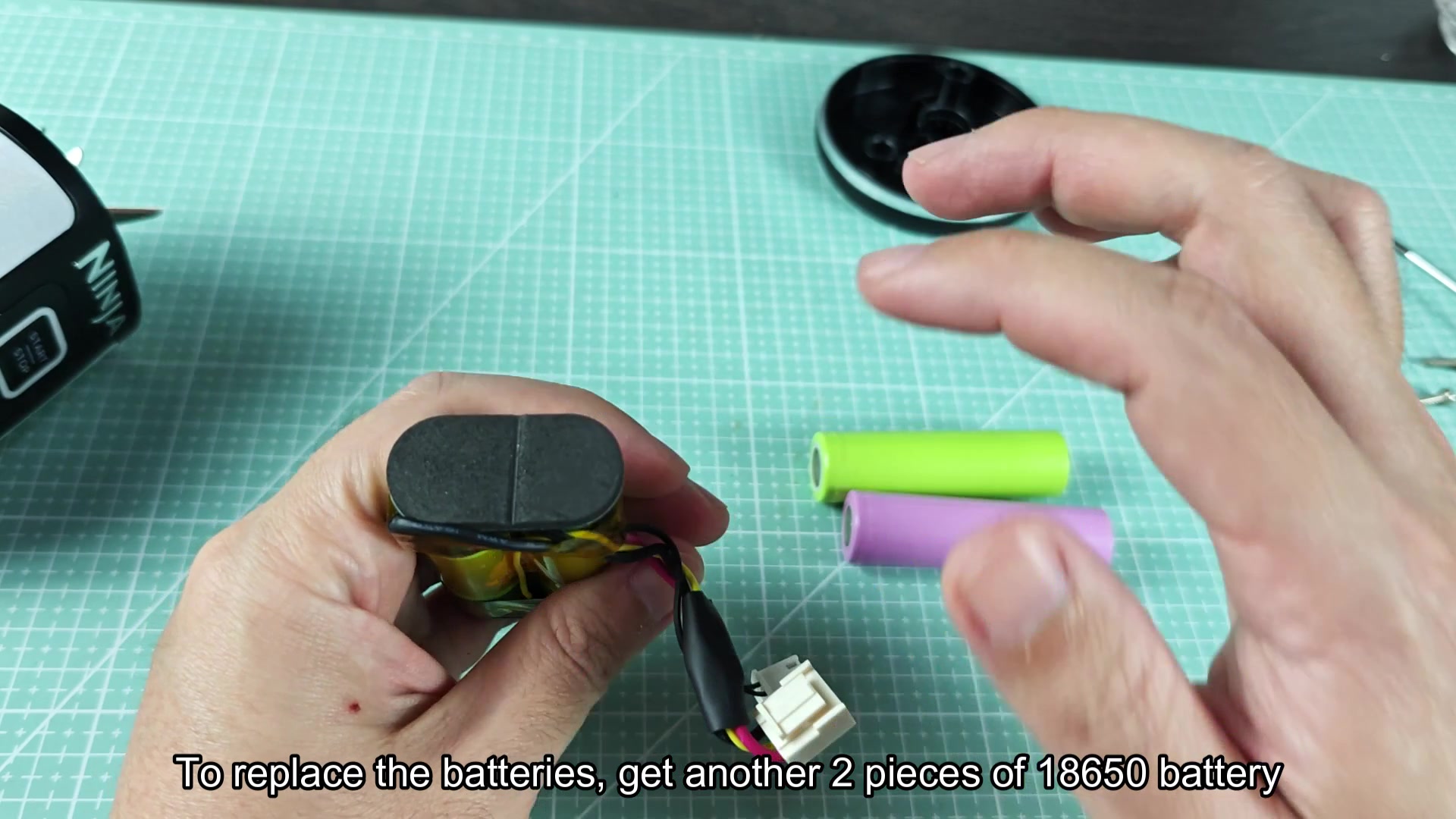

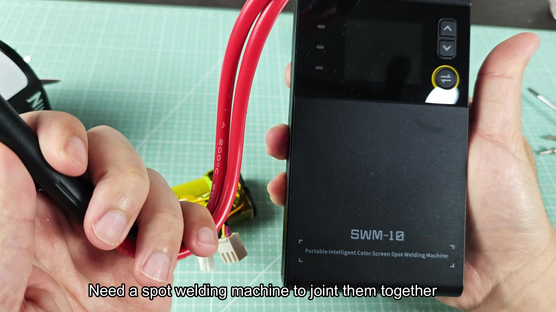

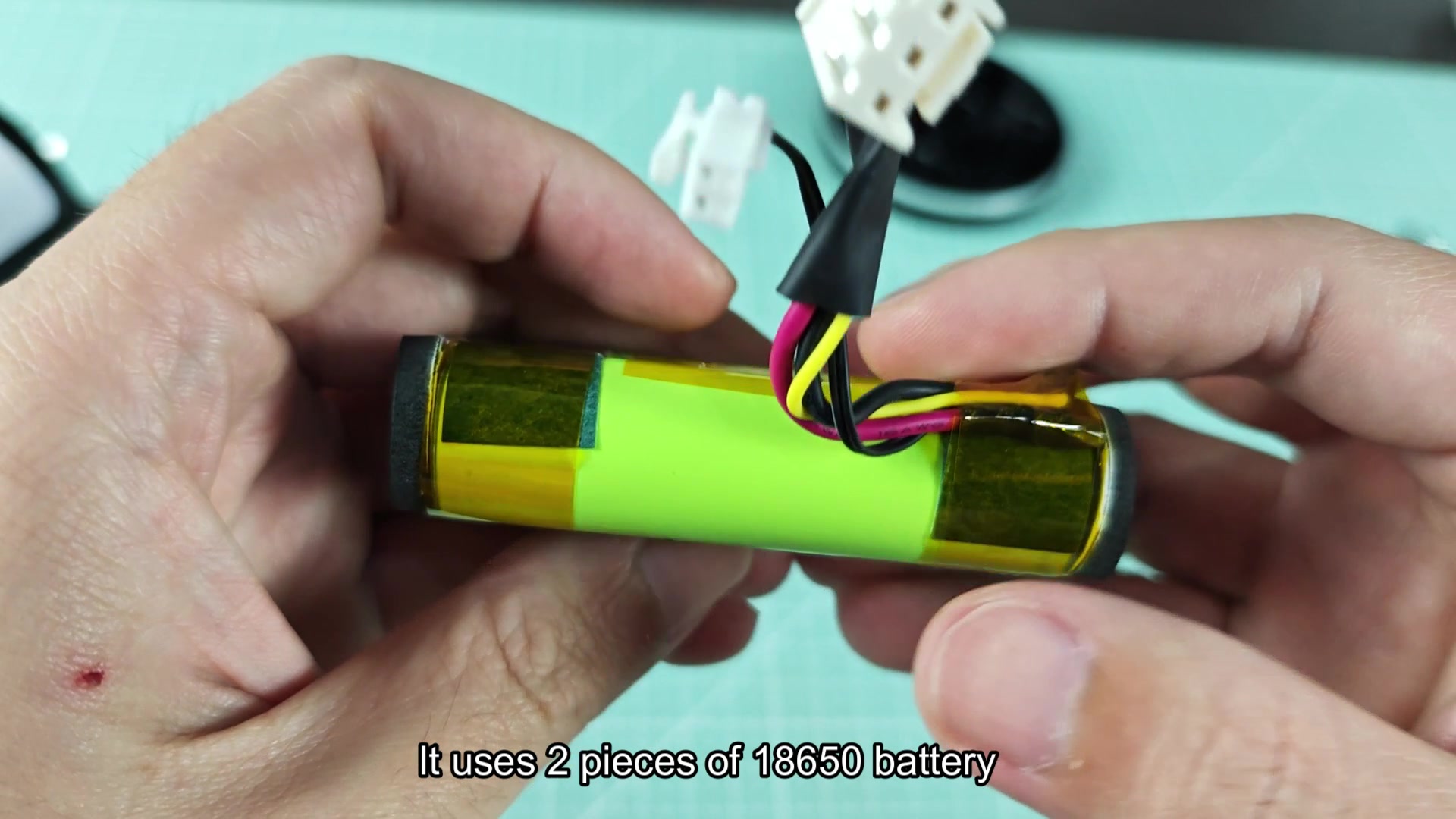

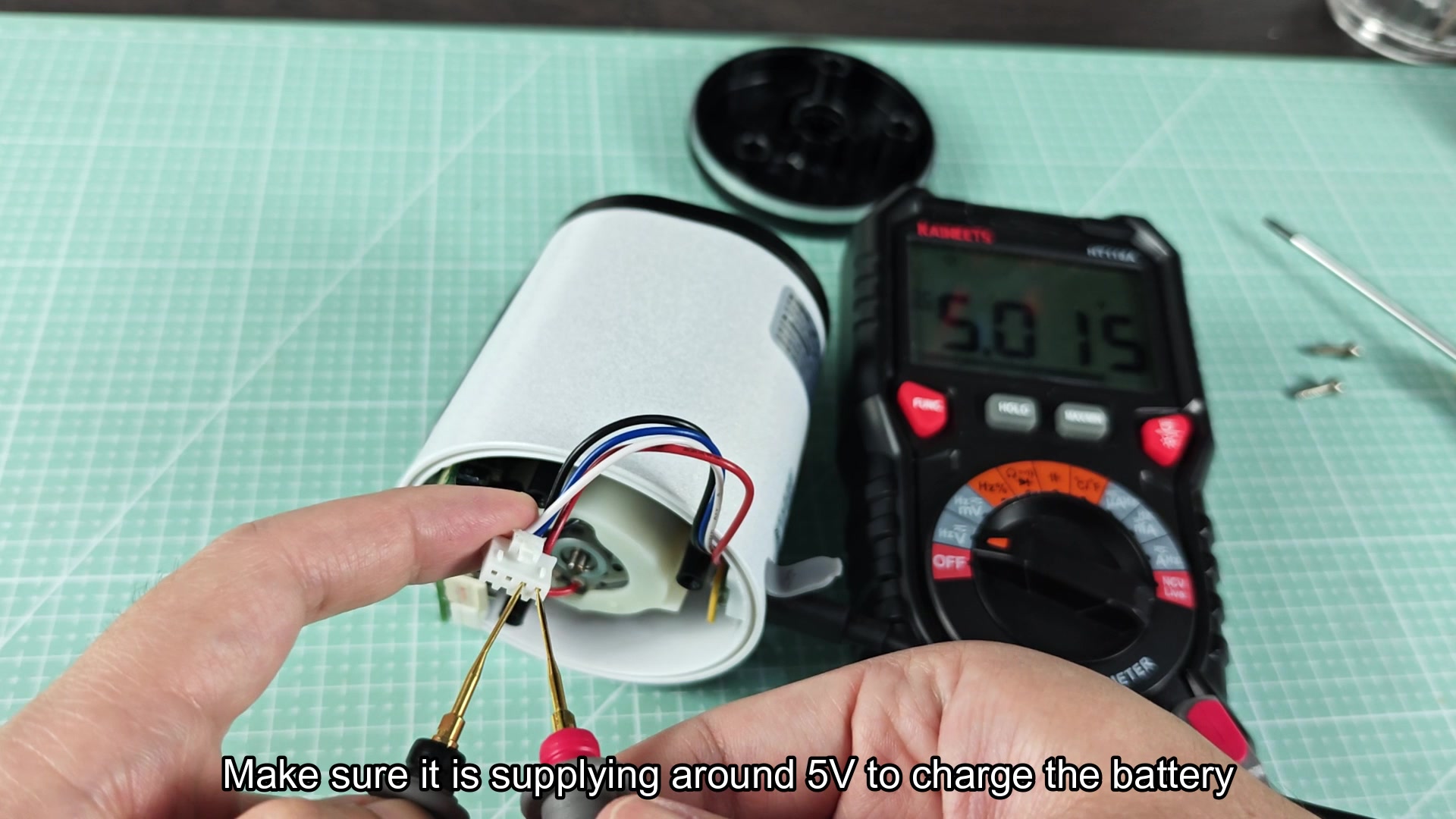

Finally found some information on the Ninja Blast blender that seems to fail often while charging. The internal battery is two 18650 cells in series for a 7V output. Nothing fancy; just like other small appliance with 18650 cells. When the Ninja Blast stops charging, it’s either due to low battery in the cells or the USB charging port not having voltage. Using a multimeter to check the charging port while the blender is plugged into USB should read around 5V. If there is no 5V on the input, the issue is the charging port, not the cells. If the charging port is fine but the battery is low, then the only fix is to replace the cells. Given that soldering to 18650 cells can damage them, using a spot welder or buying pre-tabbed 18650 cells is advise.
