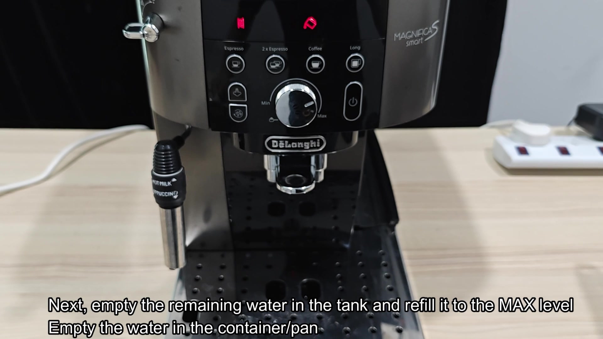

For a few threads on the De’Longhi Magnifica machines that is dropping super slow from the portafilter. Saw this as an opportunity to put up a thread for discussion since it came up a few times. There is four main causes for this from what I’ve seen. Grind too fine (fine espresso are great but for the magnifica), when people crank the grinder down thinking finer is better espresso they end up choking the portafilter. Secondly, using pre-ground beans, either too fine or too much in the chute. Third, the machine can get clogged which require a rinse cycle to clear the issue. Lastly, mineral build up in the machine caused by descaling (common in areas with hard water).
What people seem to do is jump straight to descaling when the issue is realy with the grind. What’s your go-to sequence when you find yourself in this situation with one of your Magnifica machines?
My go to is grinding 1-2 clicks coarser than pulling a shot. If still dripping then rinse then descale as a last resort. Descaling a machine that is dripping due to a fine grind is a waste of time.
