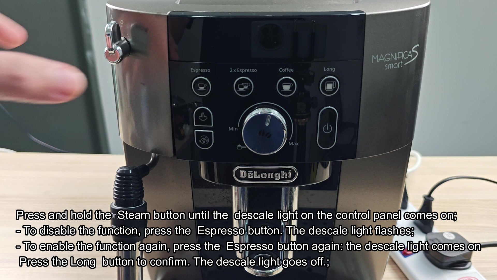

While looking at De’Longhi espresso machine menus I noticed the energy saving mode were not very obvious to find. I’ve been looking into it a bit so thought I’d share what I found.

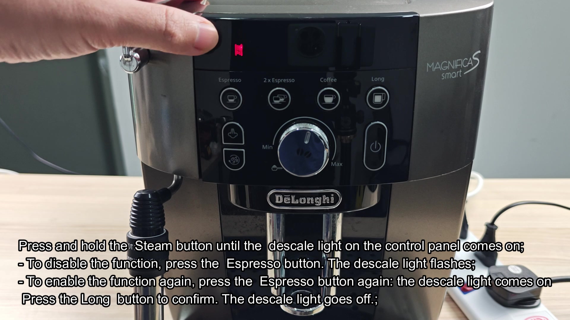

To enter the energy saving mode on a De’Longhi espresso machine you have to have the machine off but the main switch on the machine on. Once on, hold the steam button until the indicator show up. After entering the menu, press the espresso button to disable the energy saving mode and the indicator will flash. Pressing the espresso button again will enable the energy saving mode and the indicator will have a solid light. Finally, press the long button to confirm.
This mode seems to work on most espresso machine by the brand but I’m curious to know if it works on most of they models or just specific ones. The steam, espresso and long buttons seems to be used on most models so I’d imagine it would work on those but I haven’t heard from anyone who has use it on the touchscreen models. Have you used this mode on different machine?
