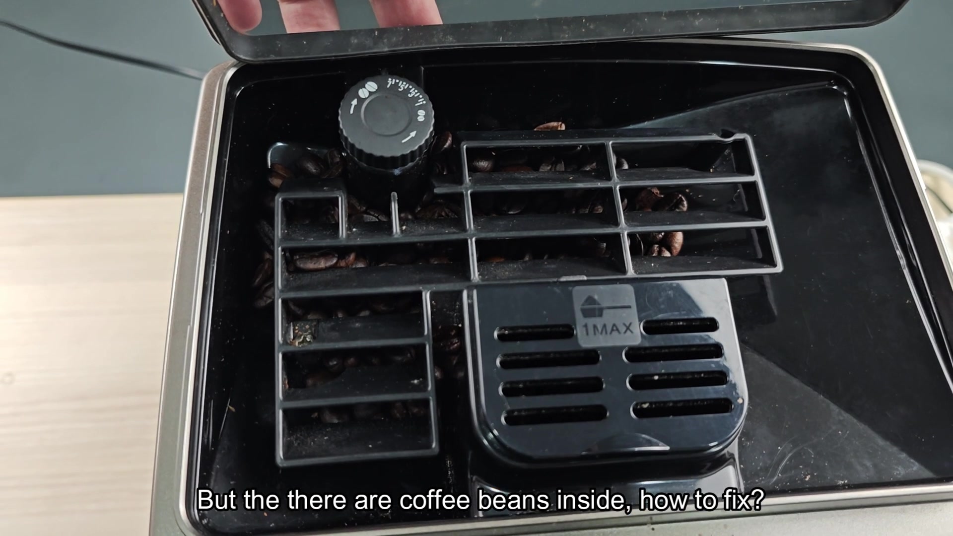

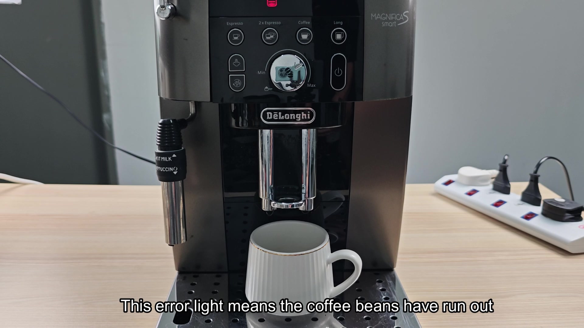

De'Longhi throwing bean empty error with a full hopper, grind too fine?
Saw this pop up a few times. A lot of peoples seem to get the solid ground container with a flashing triangle even with beans in the machine.

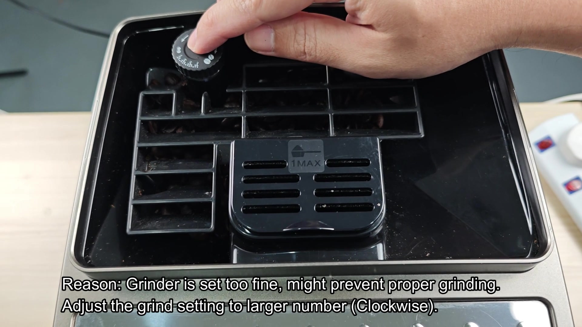

First thought is bean sensor or is the machine properly seated in the beans? However most posts indicate its the grind setting that is too finely for the machine.
If the burrs are too fine the machine cannot push the grounds through fast enough to register that there is beans in the machine. Coarsening the grind setting will generaly fixes the problem.

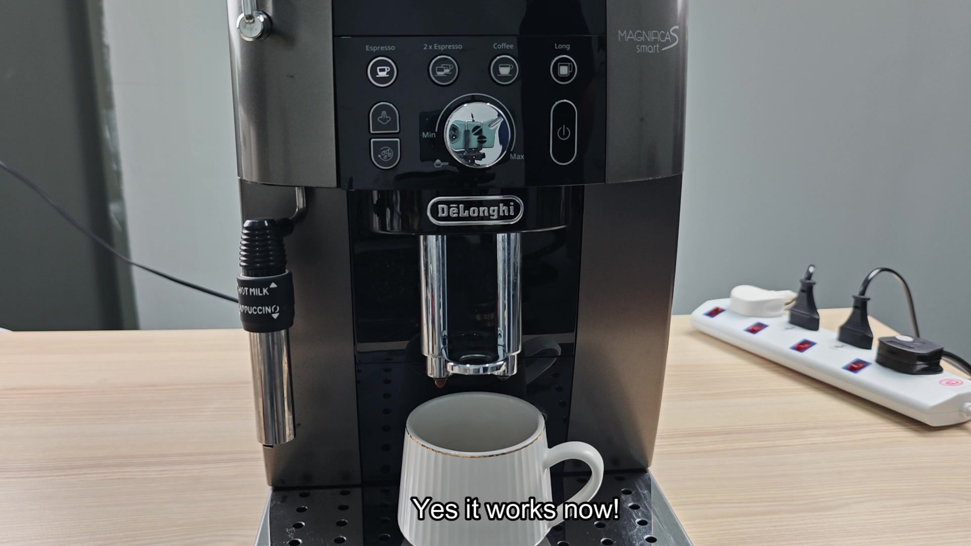

Magnifica S here, did exactly this last month. Was trying to get a finer shot but went past one notch. After 3 cups I got the error. Backed off 2 notches and it’s been fine since.

Cleaning helps more than people think. Every 6 month I pull the machine apart and clean the burrs. After a deep clean I can go a notch finer again without getting the error. Dead burrs don’t helps.
