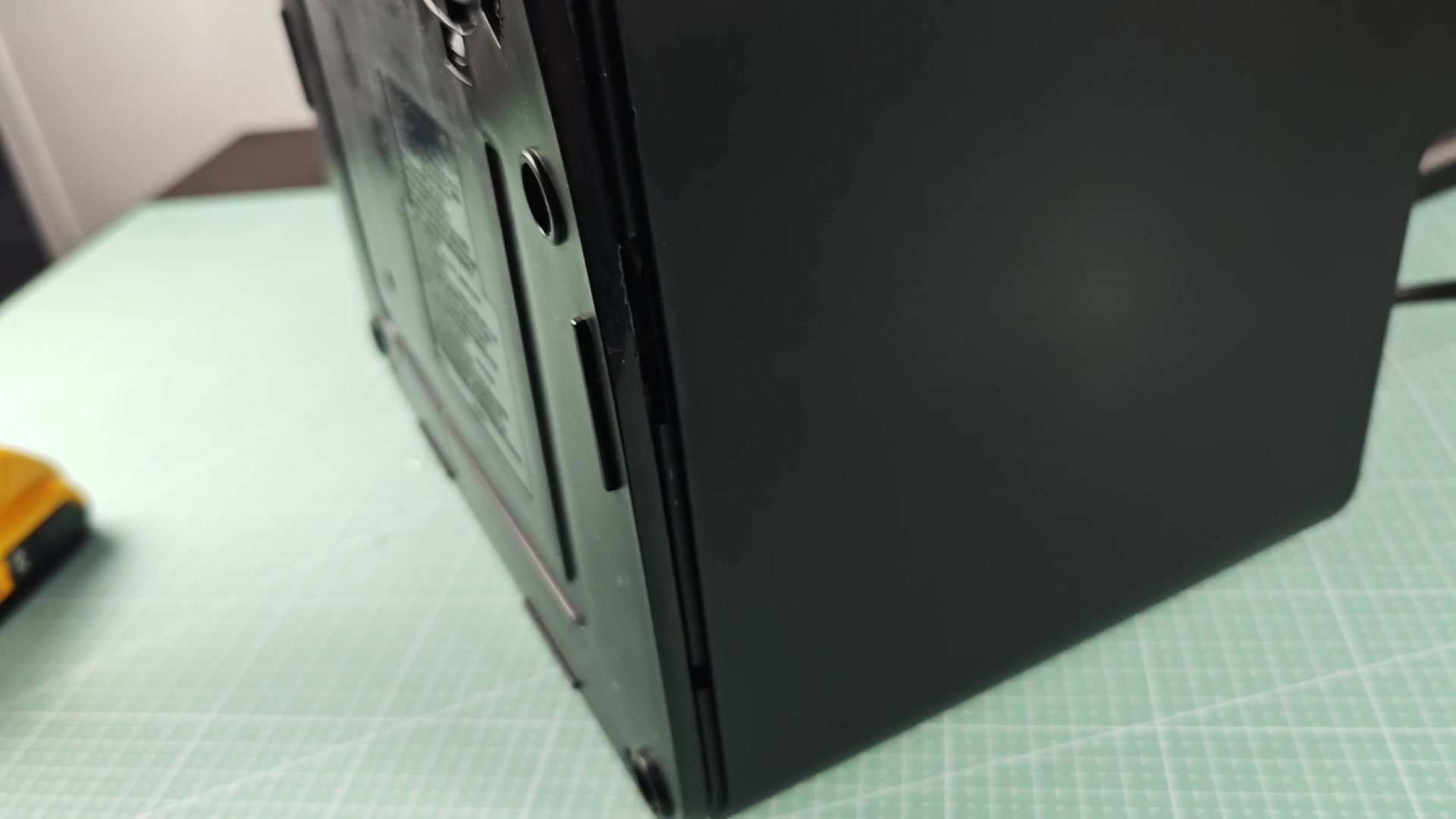

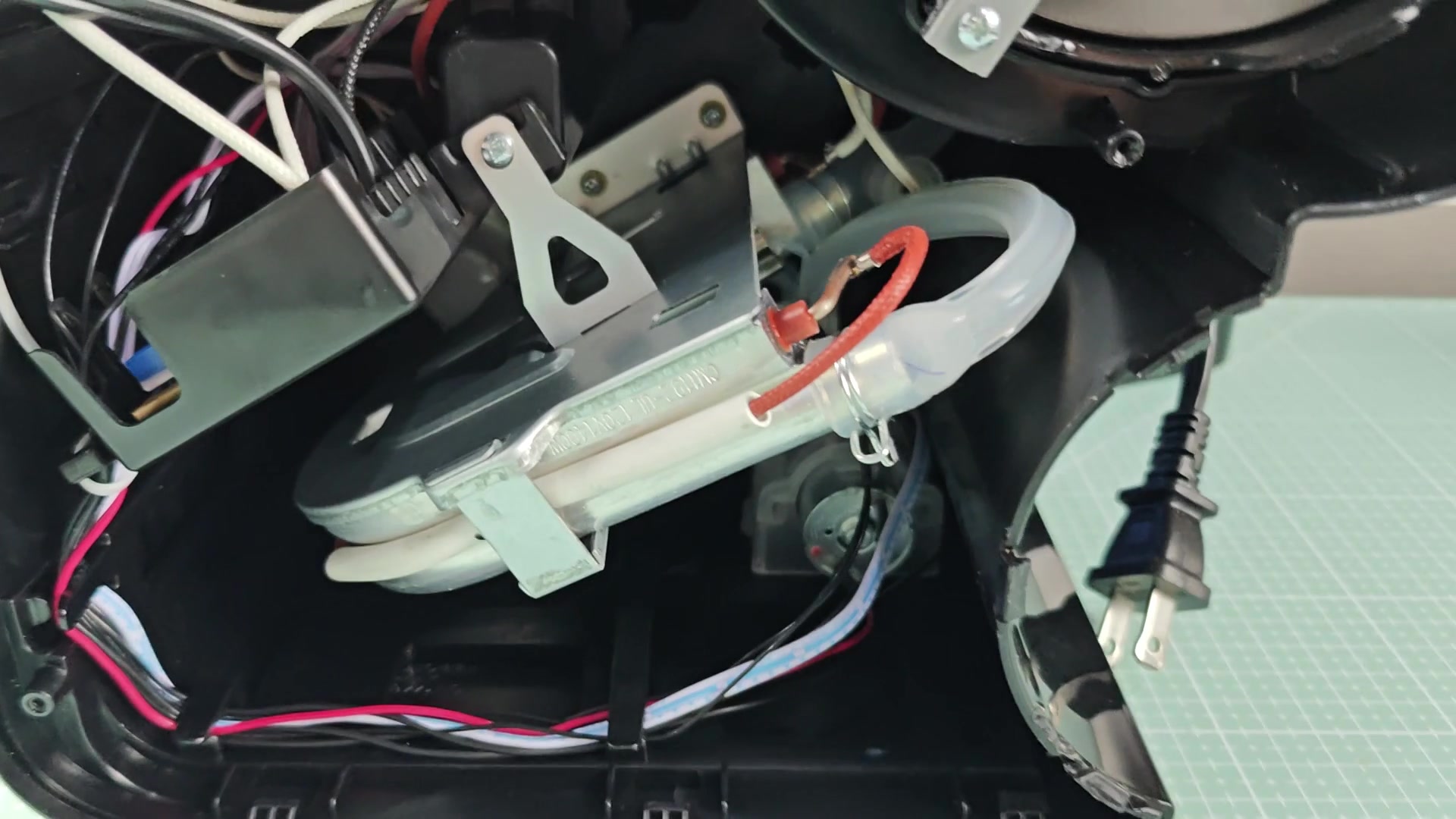

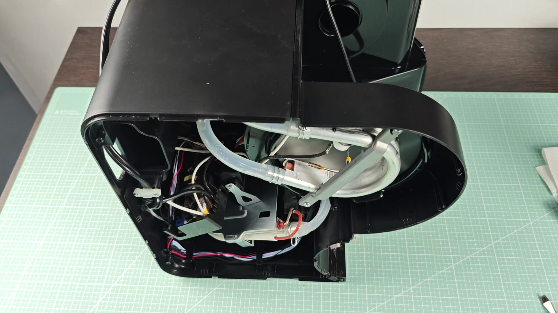

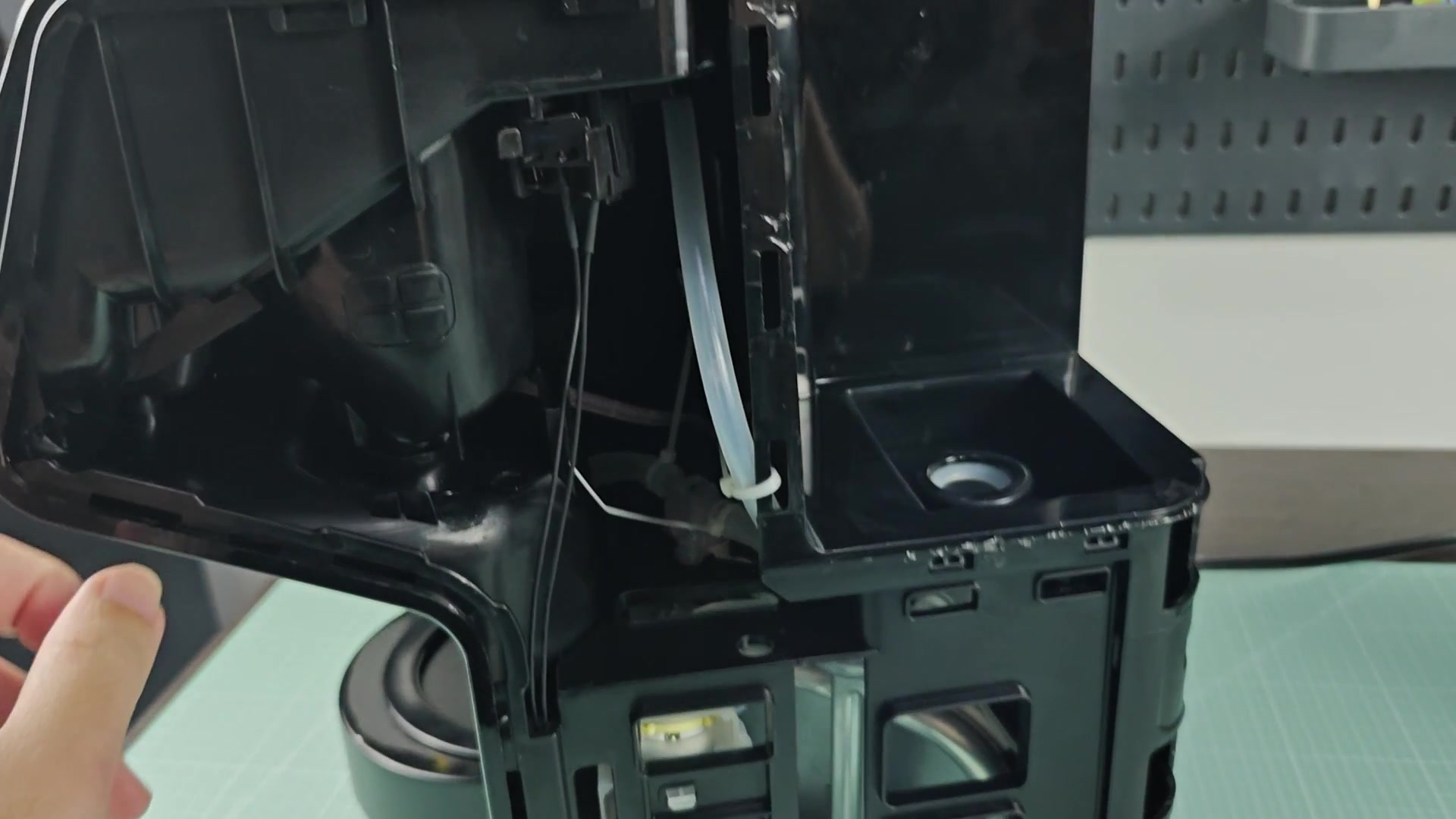

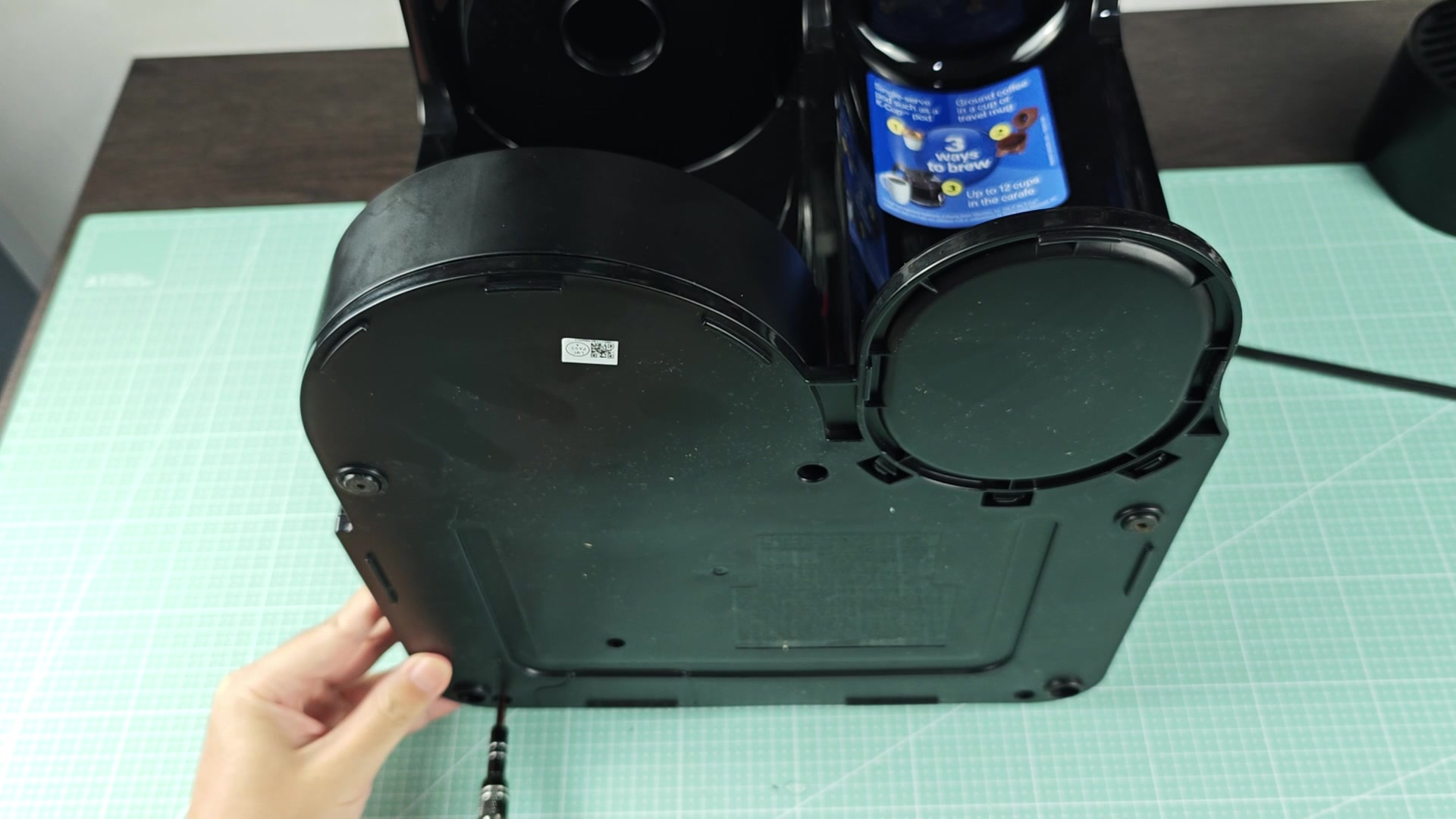

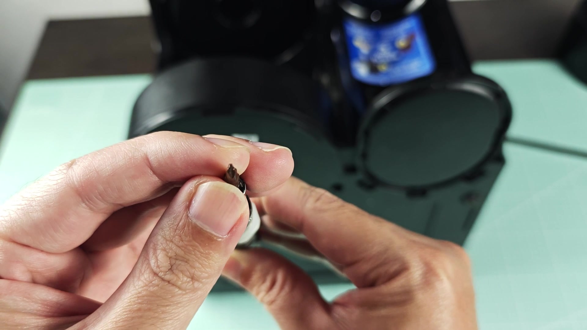

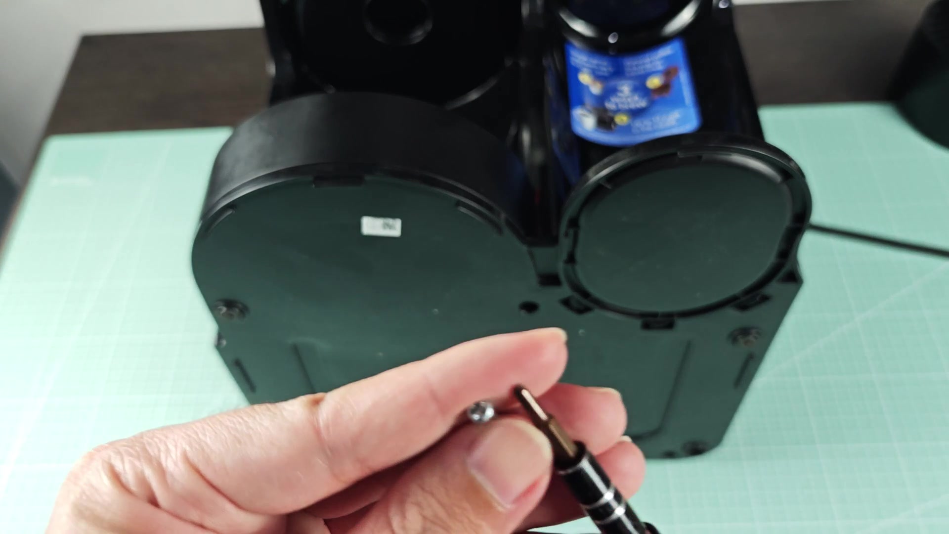

Curious if anyone here have gone inside an Hamilton Beach FlexBrew units. I'm reading up about how to teardown them and it seem fairly straightforward. Unplug the device and remove the three screw on the bottom of it to gain access to the top portion of the device. The catch on the top portion of the device use plastic clips that you can prise open with a flat screwdriver to gain access to the interior. If done quick the clips can be snapped and the housing will not fit correctly back together like when it first came from the box. These FlexBrews tend to get pulled open to address issues with the pump and heater component. As such, one would think that there would be detailed information regarding their teardown. Yet, there is no information I can find online about them. Has anyone here actualy opened one of these up? Is there any trick to getting into the top portion other than the three screws on the bottom? Does it appear like there are any ribbon cable attached to the top portion of the device?
