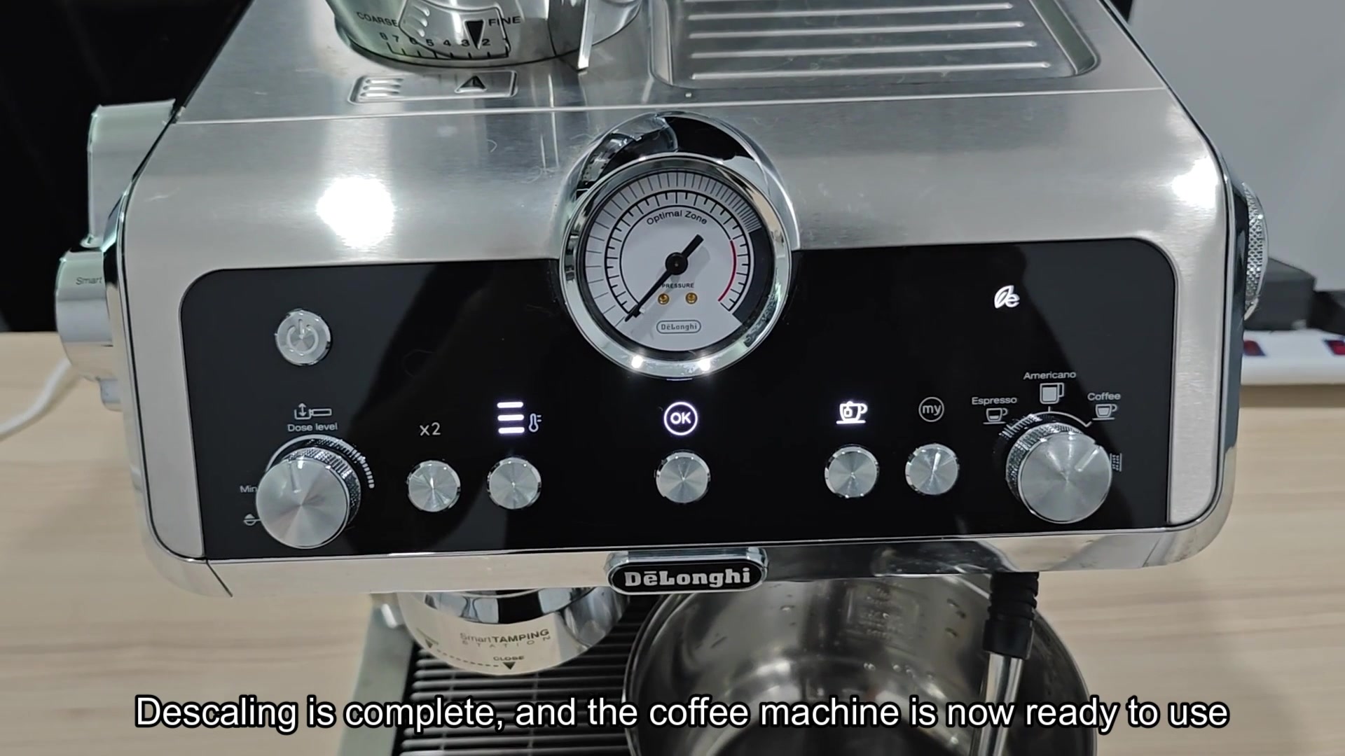

Saw a list of reasons why the La Specialista might stop pump water. Thought it’d be worth getting a discussion started on this since these are not cheap machines and people often panic and tries to replace the pump right away.

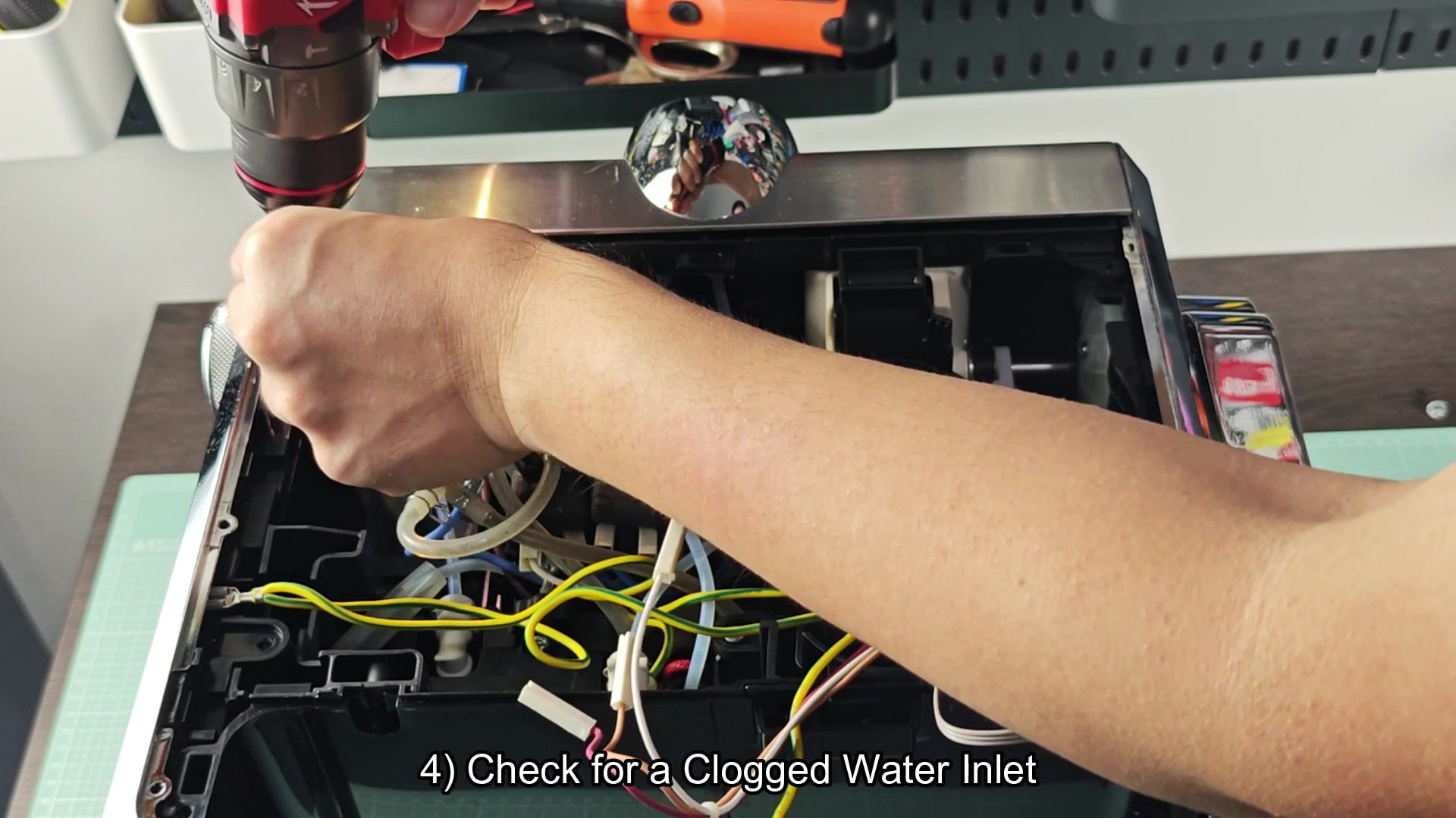

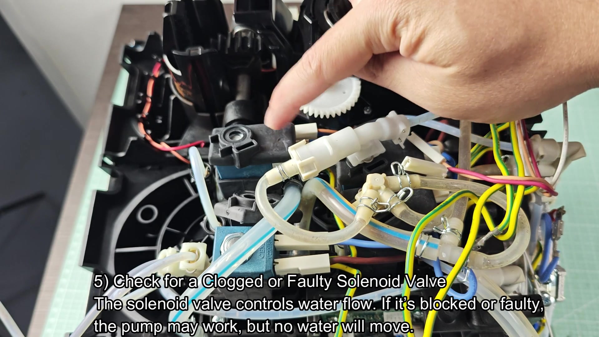

The usual suspects include a few items: Power/tank seating, descaling, reset, checking for inlet and internal components, and lastly the actual hardware of the machine such as the internal water pump or flowmeter.
