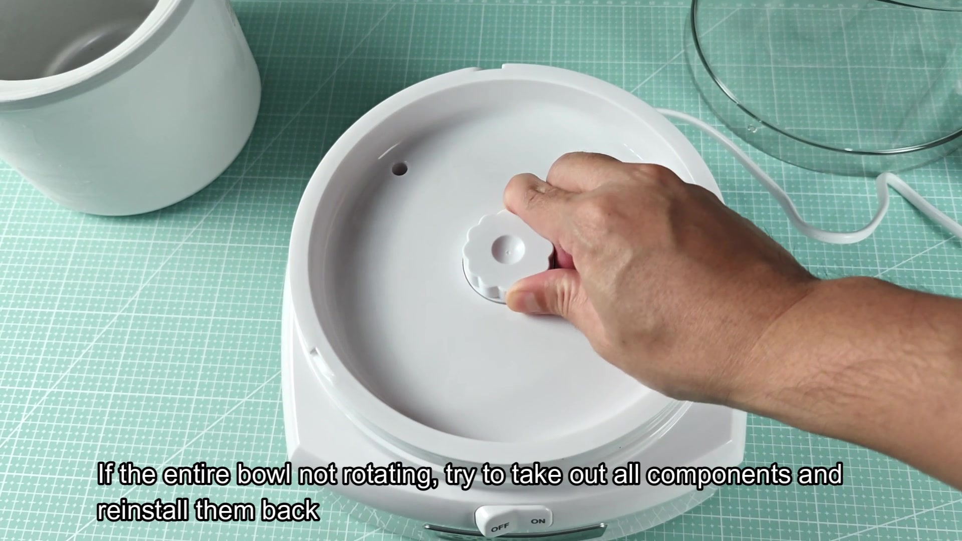

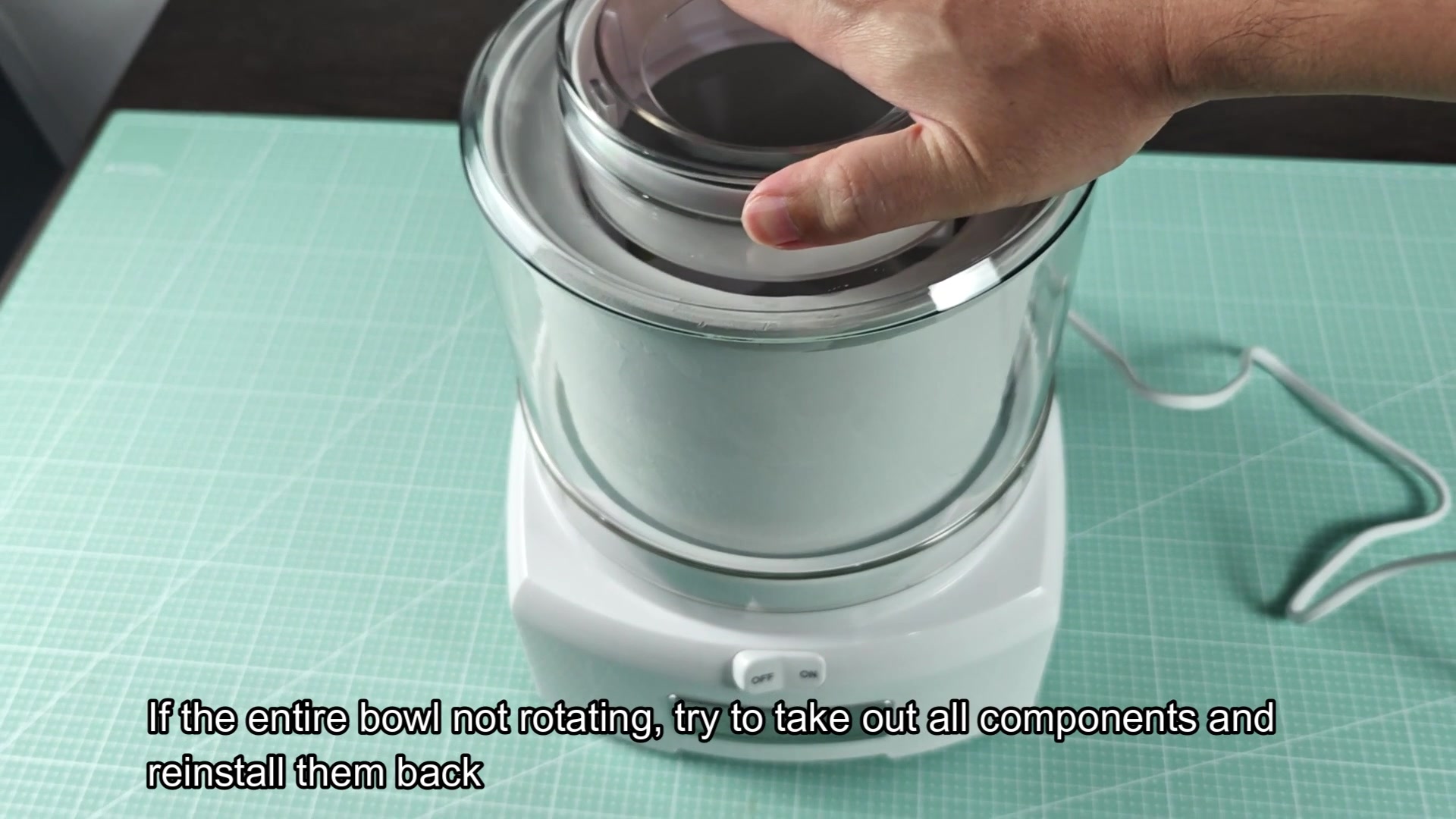

The most common issue is the paddle not turning. From reading the troubleshooting notes, this is actualy by design (the bowl turn and the paddle does not). So if the bowl is turning you're fine, if the bowl is not turning it's the motor or switch.
Next most common is the machine not freeze properly... Again, this is usually due to the bowl not being frozen properly. The spec require that it sit at -18c for at least 12 hour. People has to make the mistake of putting it in the fridge instead of the freezer, or there freezer isnt cold enough.
If the machine will not power on it's usually a faulty switch, motor/gear wear or a fuse in the plug... The notes specifically say it's an UK plug type.
Regarding disassembly, one of the bottom screws requires a U shaped screwdriver whereas the other three is standard. Not the most convenient of design, anyone encounter this issue and find a workaround?
