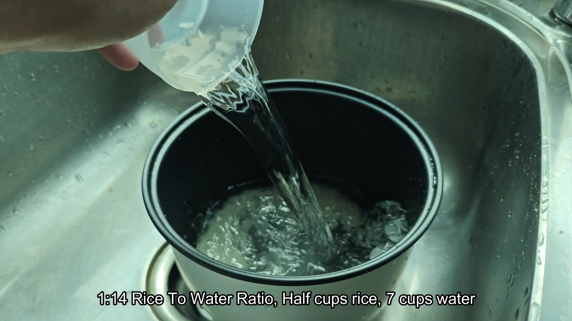

Found a method for congee in an aroma rice cooker. The rice to water ratio are 1:14 so 1/2 cup jasmine rice to 7 cup water or 1 cup rice to 14 cups water. That’s alot of water for congee. Still, rice cookers take some time for cook rice so I suppose it make sense.

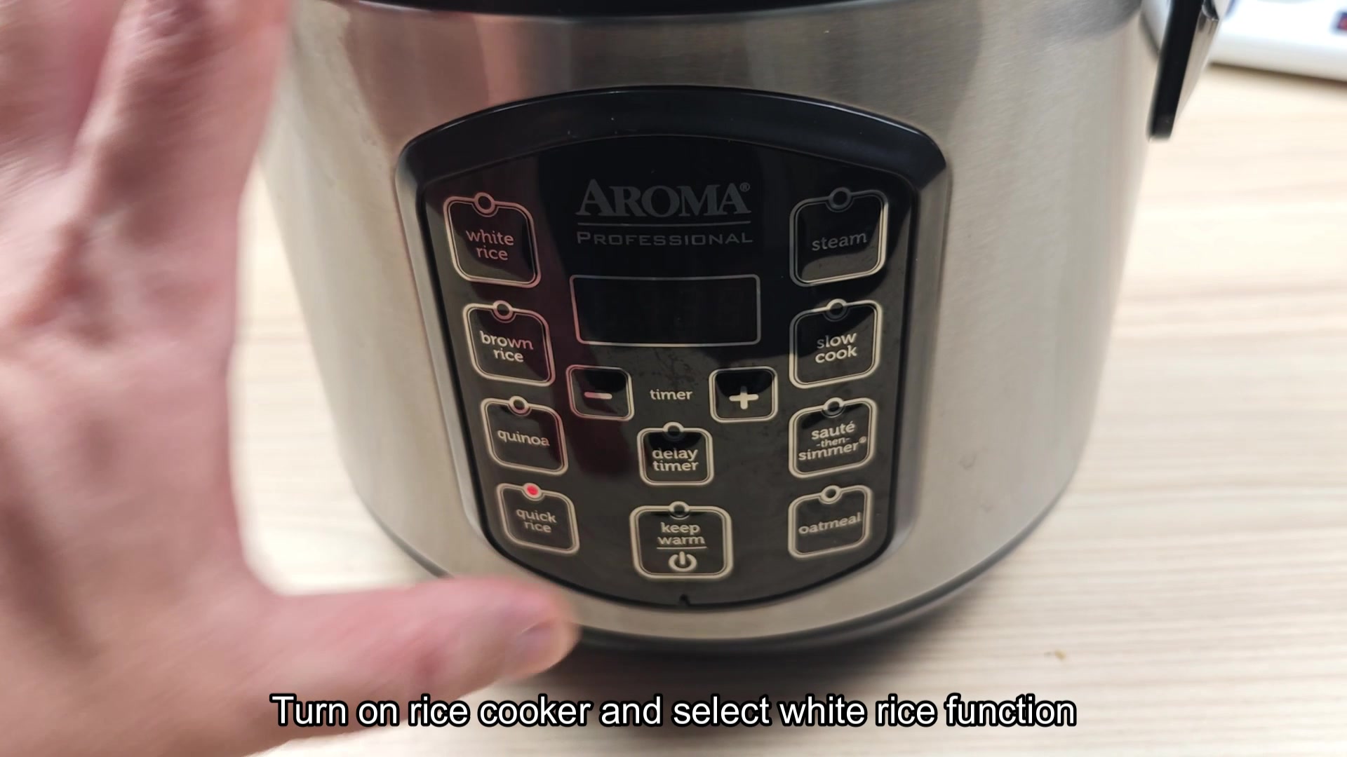

Rice should be rinse before adding to the rice cooker. Add any ingredient to rice such as mushrooms or carrots. Set rice cooker to White Rice program. It takes around 2 hours to cook. I’m not sure why since the white rice program usually takes less time but maybe its because of an amount of water in the rice cooker.

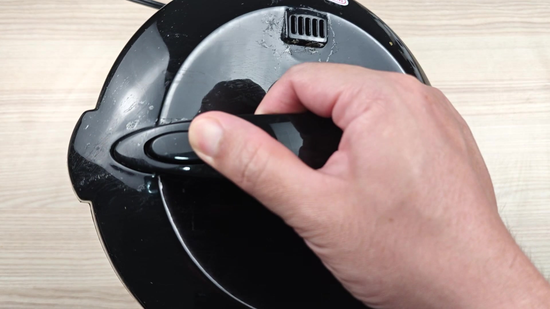

1:14 is on the wetter end but not crazy for proper jook. I usually use a 1:10 ratio in my Aroma 8 cup rice cooker. It works perfectly in the white rice mode and takes about 90 minutes to cook. It will not boil over but I leave the vent pointed away from the wall in case it do.
