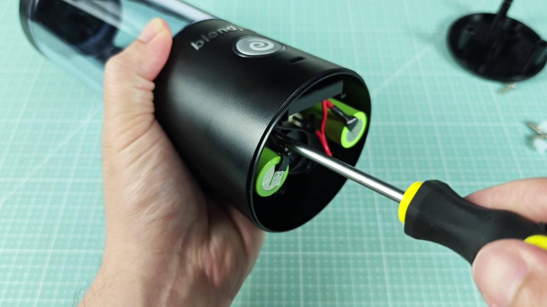

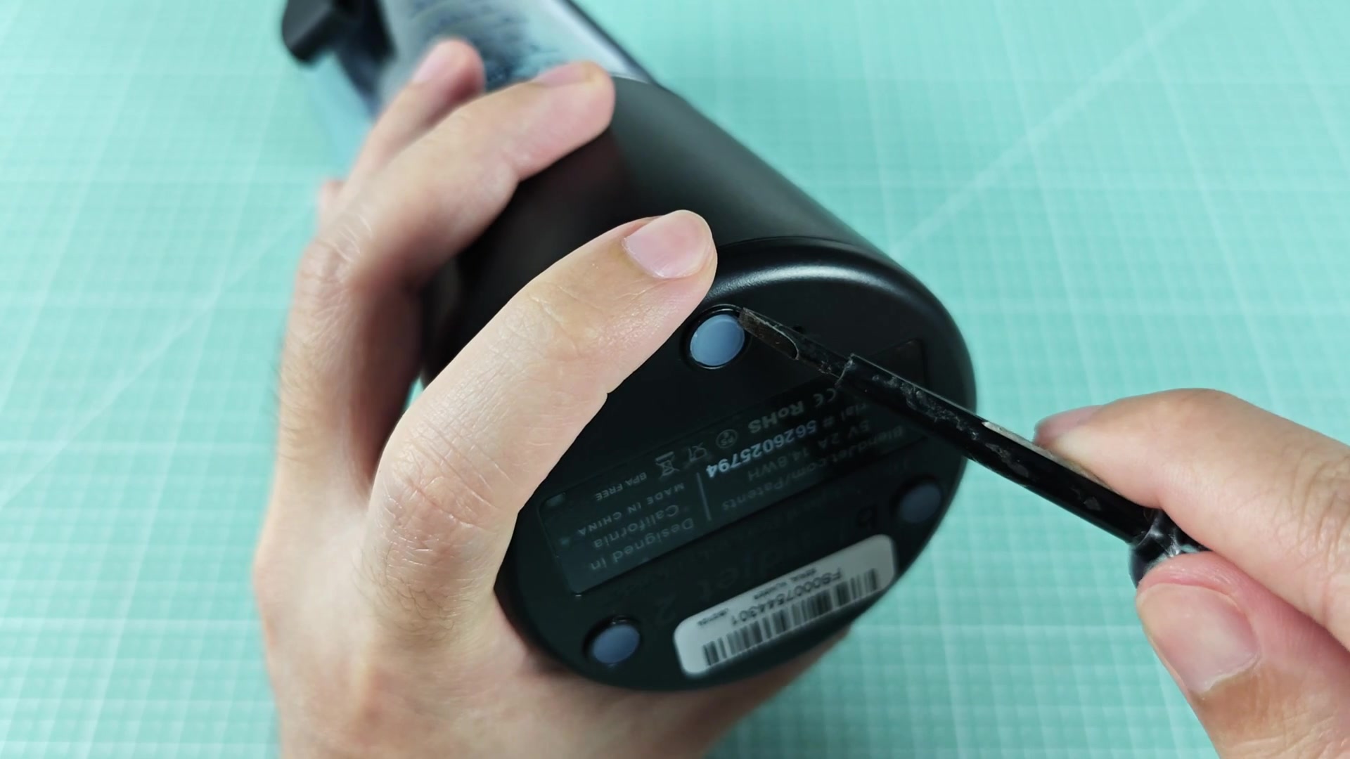

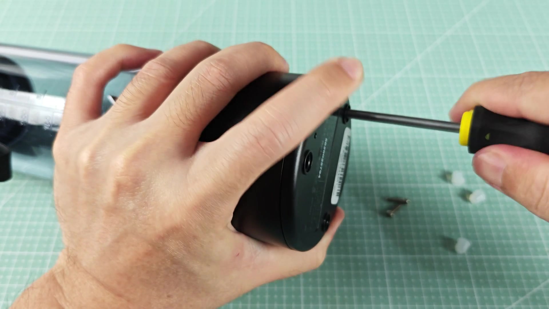

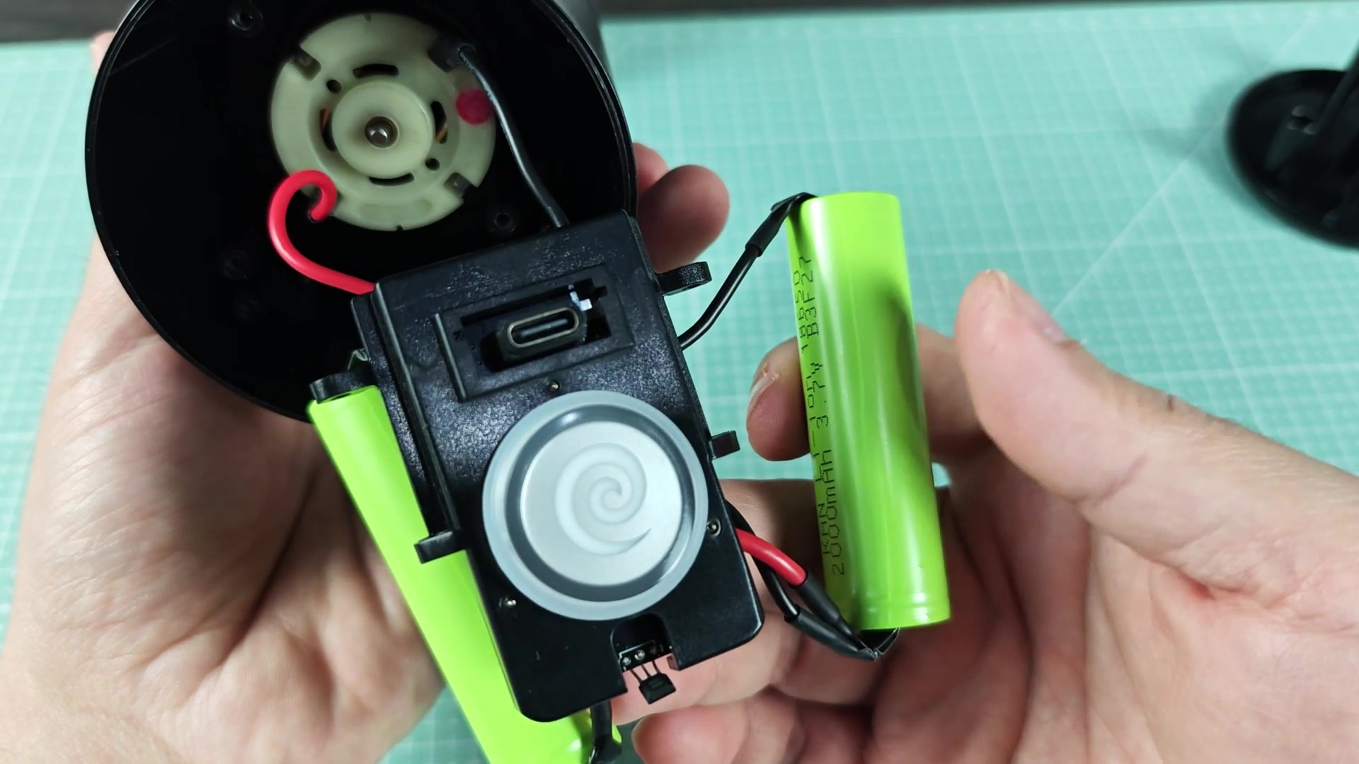

They are largely glued or ultrasonically welded together; there are no screw on the base, the newer models have a USB-C charging port, and the motor and battery is under the device. The blade is likely pressed onto the motor shaft rather than having it thread onto it.
The battery is likely not replaceable; rather, are the cell spot welded to a board that is difficult to access for replacement? Is it a brushed DC motor for instance?
