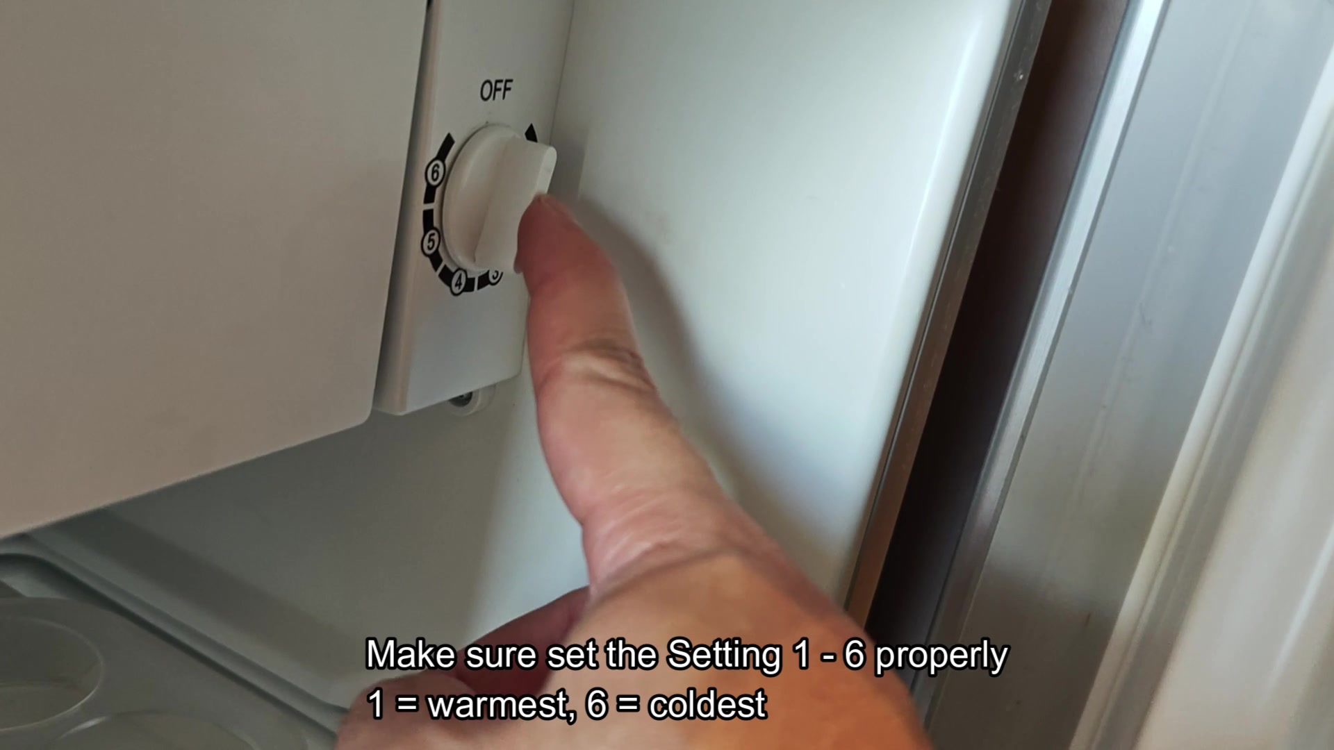

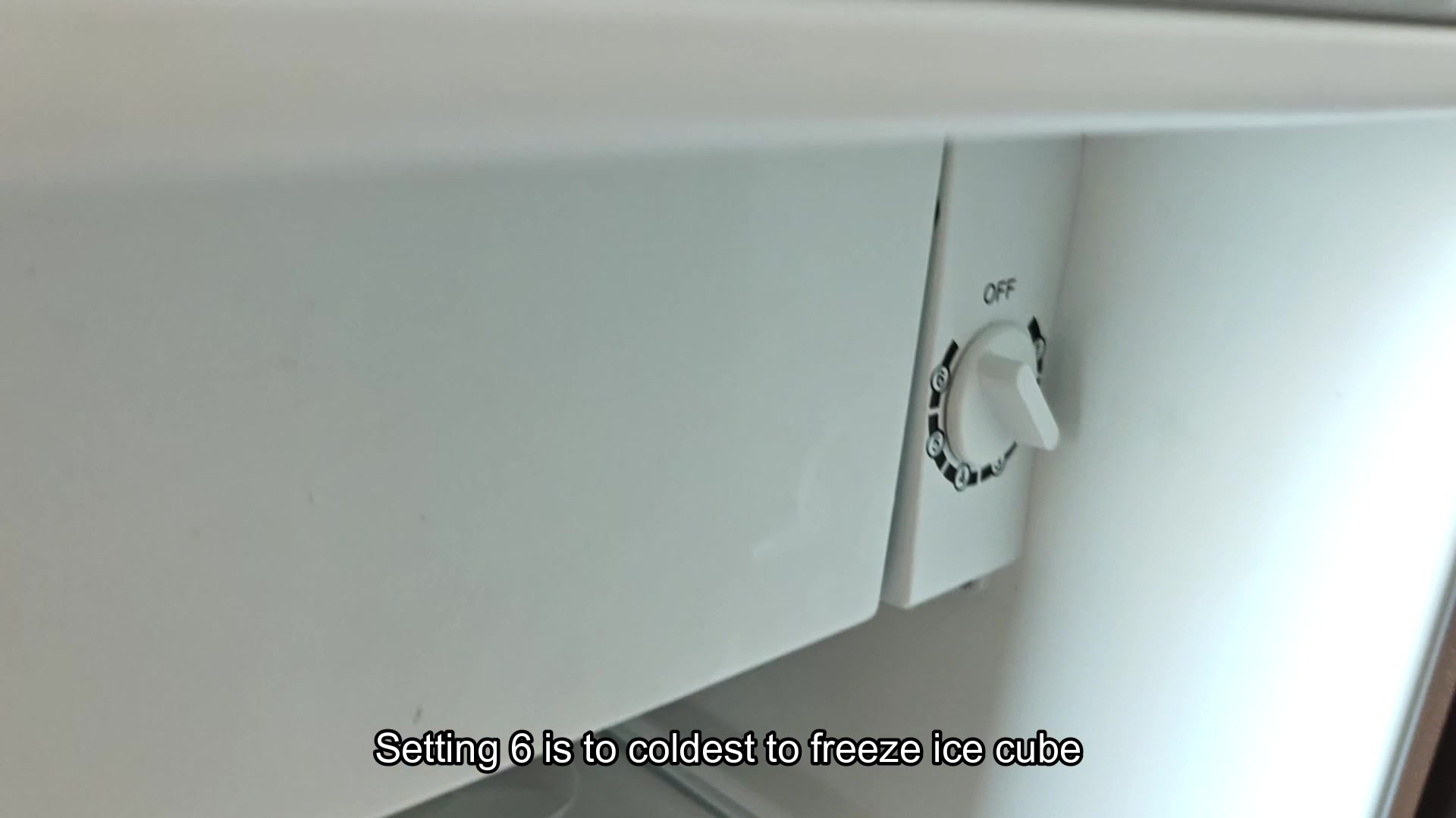

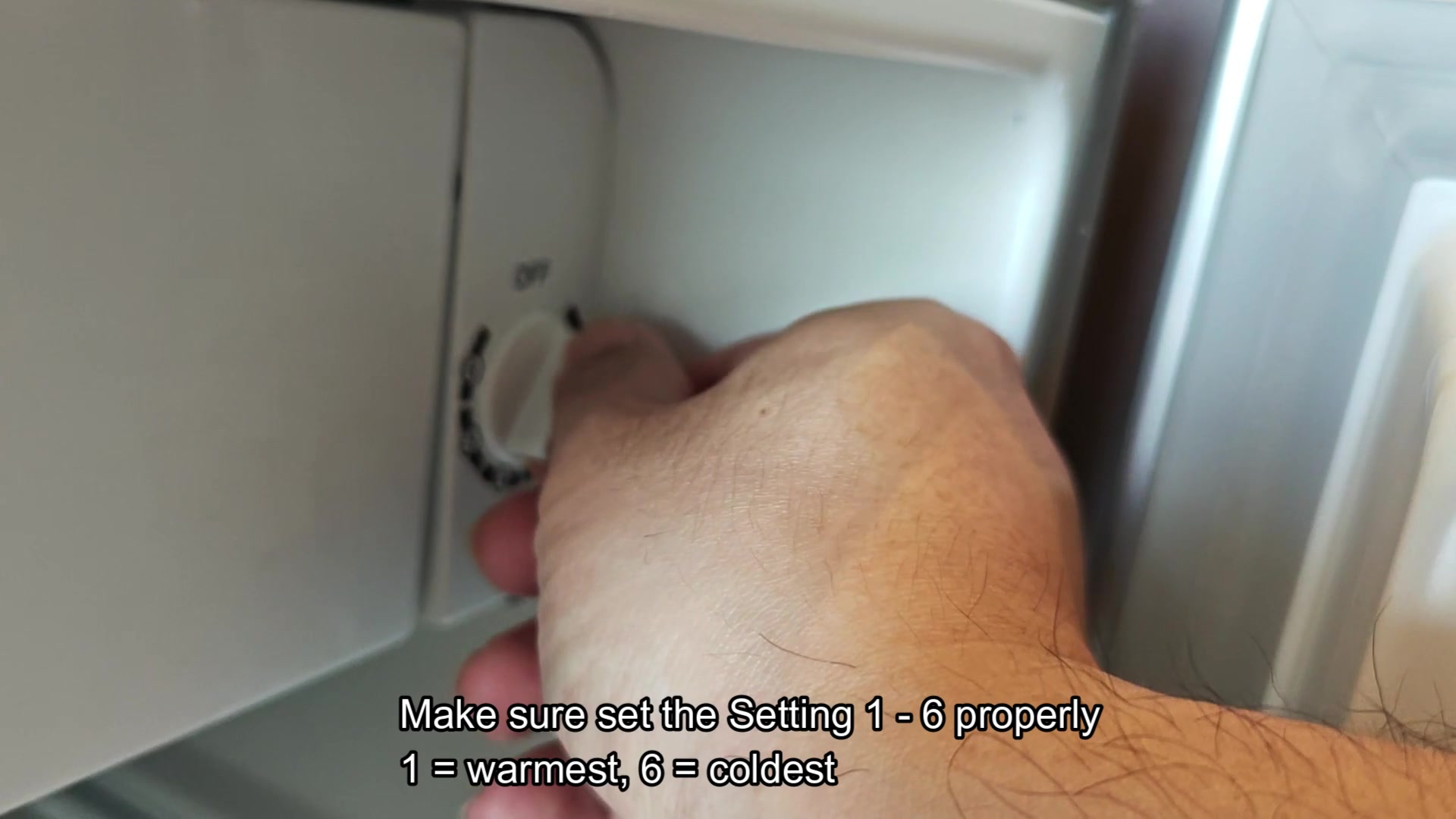

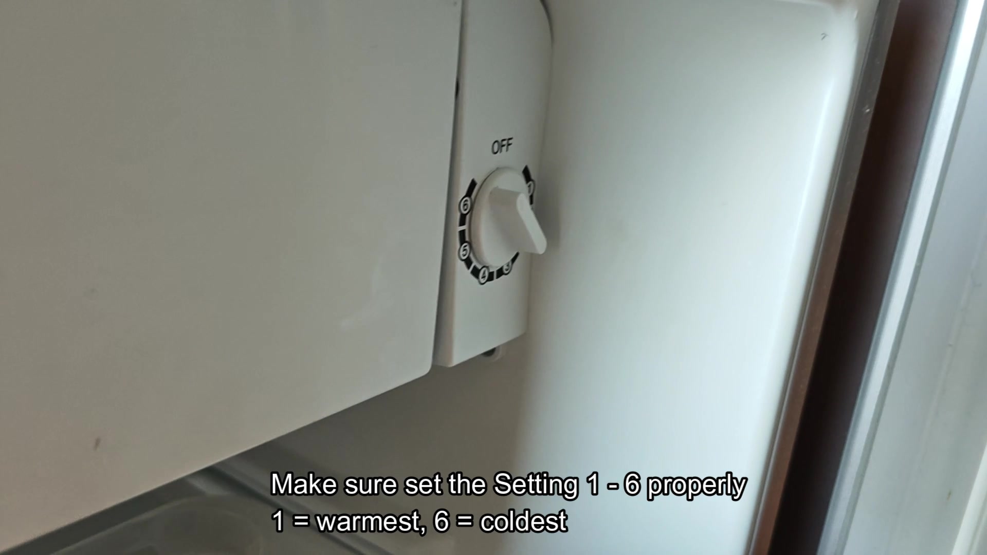

First one is the setting on the fridge. This will seem pretty dumb but you need to set these to 6 in order for either the fridge or freezer compartment to get cold enough for ice to form. Any lower and the fridge will come in at a lukewarm.

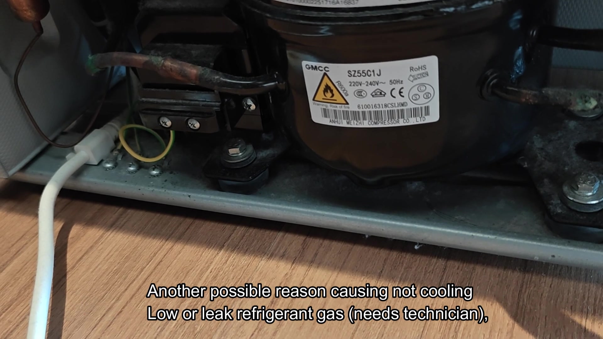

Second and third are the compressor issues or refrigerant leak / low refrigerant gas charge. Compressor issues are typically felt (or not felt) while low refrigerant will typically make the compressor run nonstop but the fridge dont get cold enough.

9 times out of 10 on these cheapie minis its the compressor or the start relay, not a leak. Leaks happen but the tubing is all sealed copper, there's not many places for it to go bad.
quick question for anyone whos opened one up, is the compressor in these midea units even servicable or is it all sealed units? like can you swap just the relay or do you have to rip the whole back apart?
Relay is easy, it just clips onto the side of the compressor. Pop the cover, unplug it, swap with a matching one. Compressor itself though is sealed and not really worth it on a fridge that cost 120 bucks new.
honestly at the price point these things sell at its just not worth diagnosing past the easy stuff. Labor and a refrigerant recharge from a tech would cost more than a new unit. Bin it and moves on
You can tell if its a refrigerant charge or not with the compressor pretty easily without refrigerant gauges. If the compressor is humming and getting hot to the touch but the evaporation line in the fridge itself is not getting cold to the touch its refrigerant. If the compressor isn't starting that's the start relay or compressor. Touch the line off the compressor, should be hot to the touch. Suction line to the compressor should be cool. If both lines are to the same temp as the ambient air in the room, its refrigerant charge is low or gone. Not perfect but gets you 80% of the way without gauges.

interesting, so if the discharge line is hot but the evap stays warm that would indicate the gas is gone? does it matter how long youve let it run before checking the lines?
Give it 5 to 10 min running. Discharge line gets hot quickly but the evaporation line will need to run for a minute to drop the temp if there's any refrigerant charge in the system. If after 10 min its still room temp the charge is definitely low.

set it to 6 and pray lmao thats definately the vibe with these. One fridge I had the thermostat knob was corroded so it wasnt telling the compressor to cycle on long enough. Fixed that for him and it ran for another 2 years before his nephew took it over.
