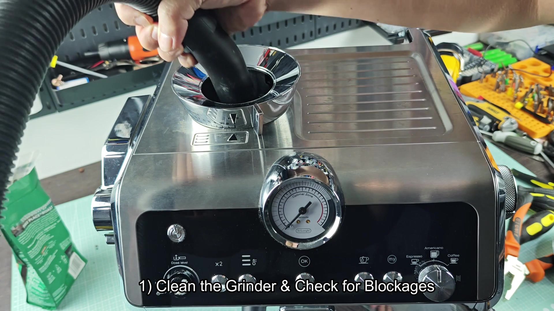

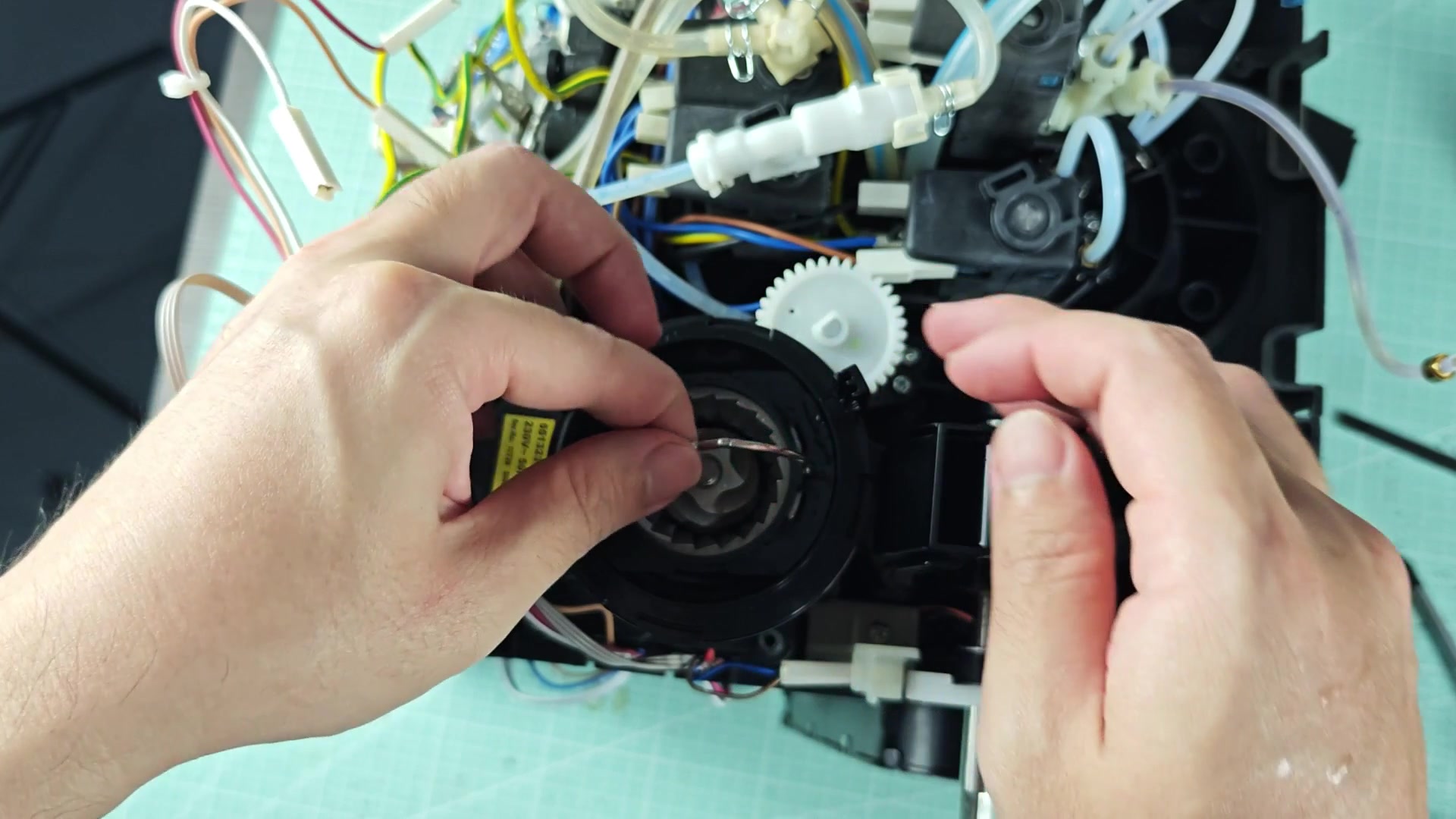

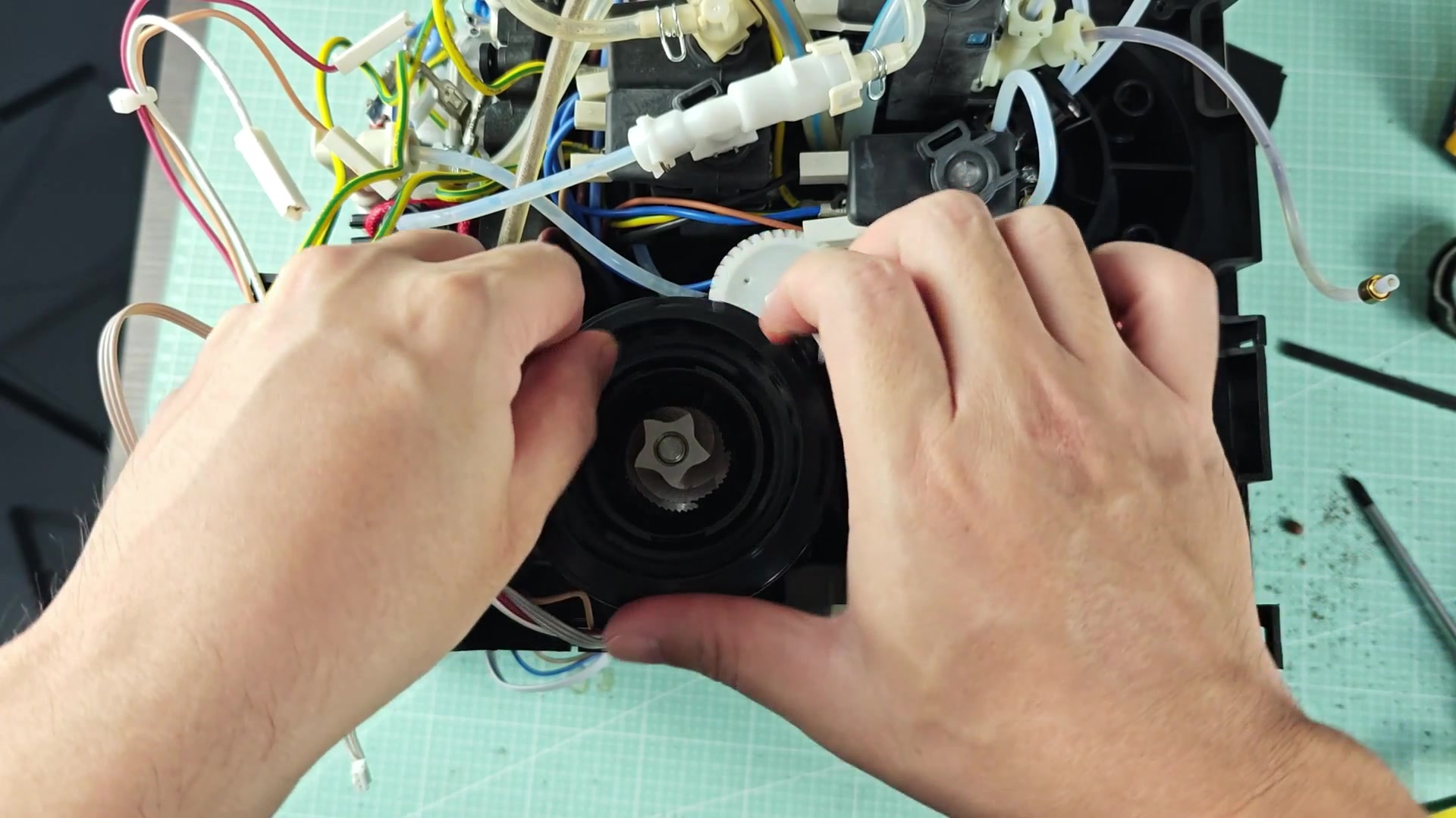

The first being that the beans or ground coffee is creating a blockage within the grinder itself. Secondly, the grinder may become dislodged from the machine, in which case you should reattach the top cover properly. Thirdly, a glitch within the machine may occur that can be cleared through resetting the machine. Finally, if none of the above three fixes the issue, then it may be the grinder motor or control board that is creating the problem. The control board being the part that most people dont want to hear about.
Out of the four causes, how often is it the control board versus the grinder becoming dislodged? It seems like most people jump to the conclusion that it's the motor failure instead of the grinder becoming dislodged after brewing their coffee. The reset procedure seems to be overlooked as well. Has anyone here had to replace the grinder motor or control board on one of these coffee machines?
9 times out of 10 its the beans in the grinder burrs. People just dont realize how much residue builds up over time
had mine do this twice. Both times it was the top burr assembly not properly seated. Should click when its properly inserted in place

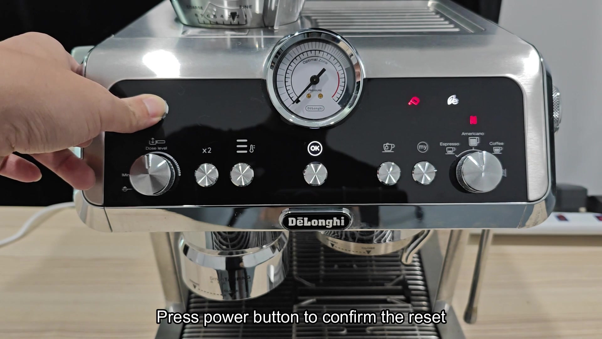

wait what reset are you talking about? is there some button combination or do you just unplug it?
Unplug for a couple minutes. Hold the power button while plugging back in on some model machines. Its in the manual but its very vague about the details.
so just plugging it back in again clears something stored in the machine’s memory or does it just clear the capacitors?

is it safe to vacuum out the burrs with a regular shop vac or do you need one of those antistatic ones for the fines? read somewhere static can mess up electronics nearby
Had to replace a grinder motor exactly once in about 4 years of fixing these. Came from a machine that had been run with a stone in the beans. Customer admitted it when I asked if there was any chance of a motor issue. The motor was fine, just the burr shaft was bent. It had been doing that for months. So no, motor and board issues dont happen unless something else caused it. Nine out of ten, like you said, its the simple stuff.
