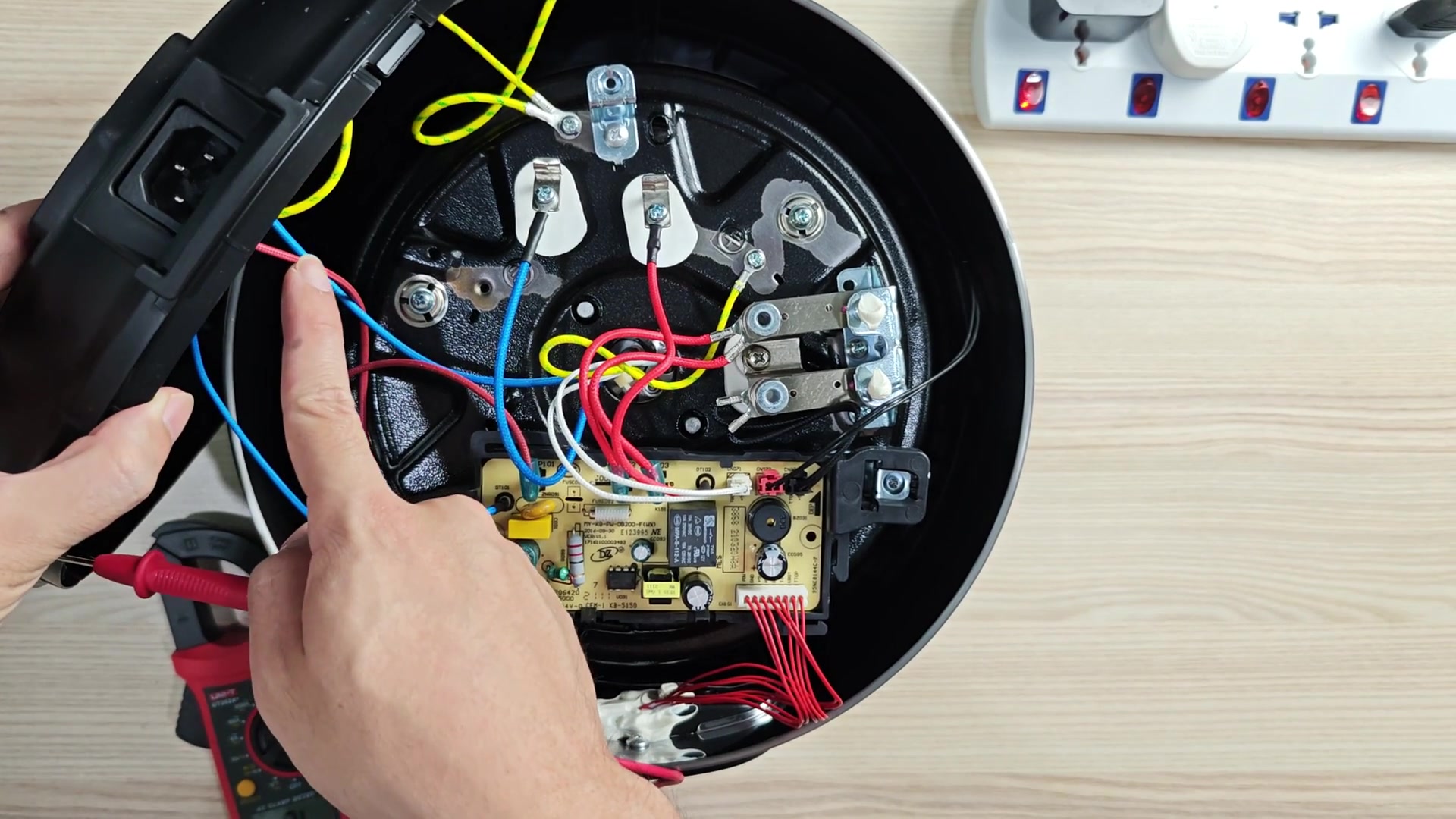

do you guys use a particular multimeter to test the Instant Pot for continuity?

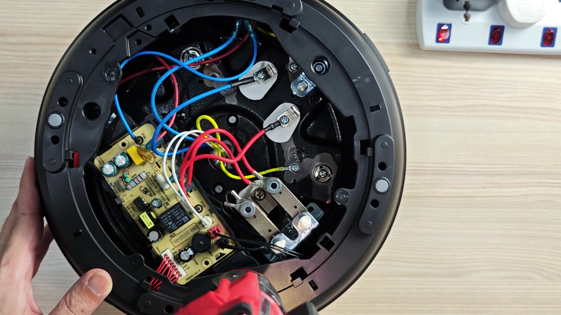

slightly off topic but have you guys noticed that these models have a fuse that is soldered in instead of using a fuse holder? If it were in a holder people could just pop it in and out in 30 seconds. Instead you need to open up appliances with mains voltage circuitry and an iron…

fwiw the inline fuse blew on one of these. Power cord was fine. The issue was actually with the control board. Found a cracked solder joint on the main board. Might be the reason the inline fuse blew. Soldered it back up and it turned on again. So the power cord could be an issue…
that’s interesting. How did you spot the crack in the joint?
