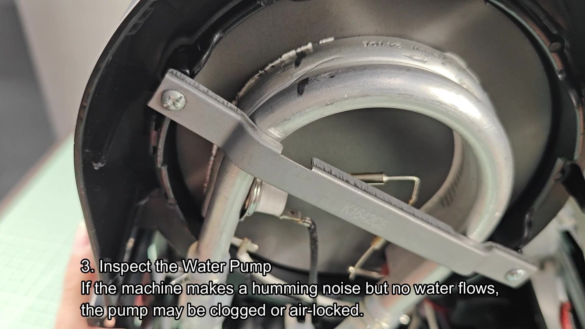

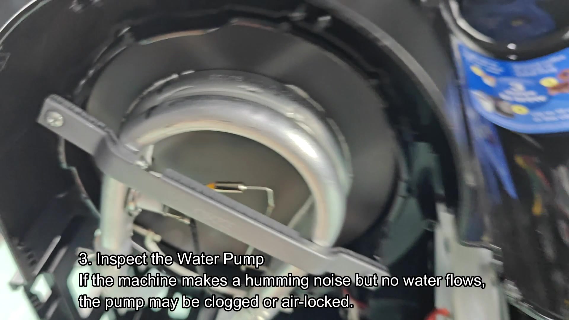

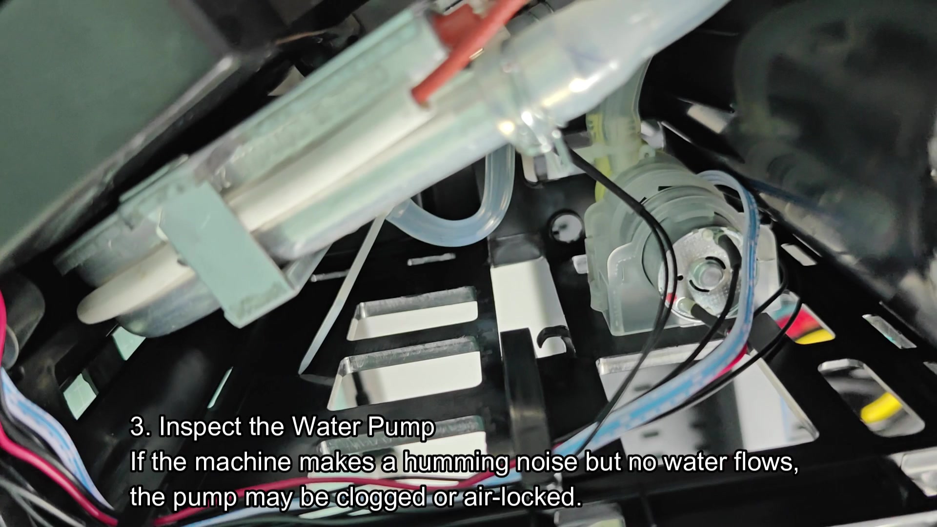

B British Un Feb 12, 2025 45 0 0 Oct 22, 2026 #25 The Hunt For t said: if the pump is humming its getting power but can’t push water. Clog or airlock. If pump is dead its silent. Click to expand... that makes sense thanks. So if the pump hums its a clog. If silent its a dead pump (or no power from controller).
