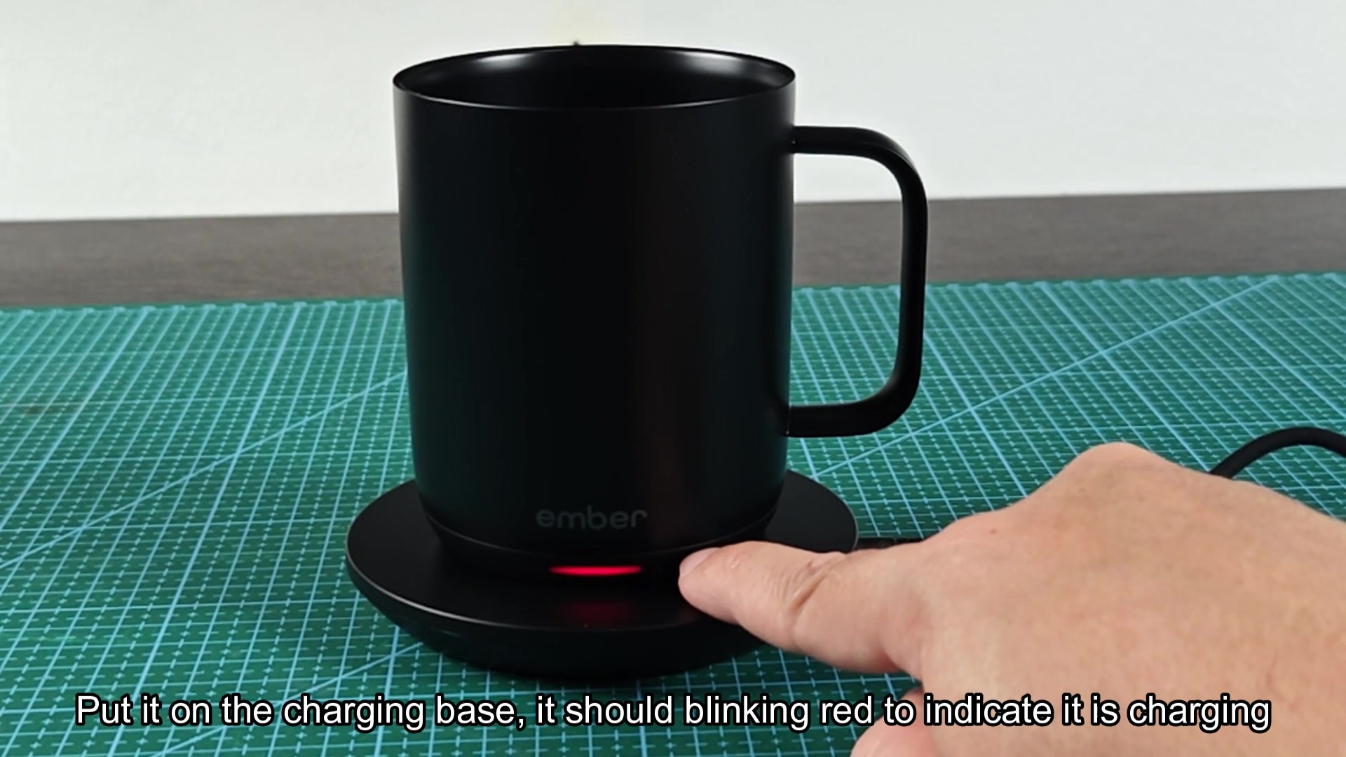

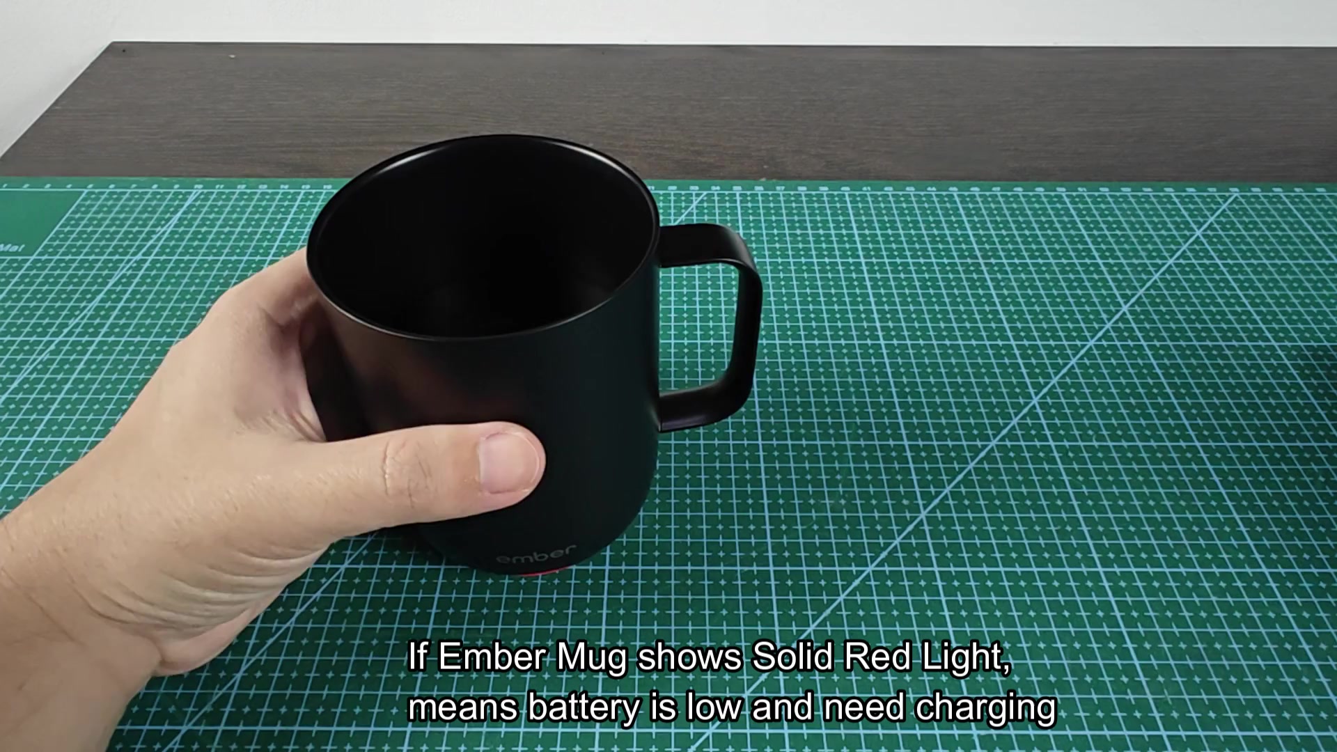

Ember mug showing solid red, just a low battery thing?
The distinction here is that if the mug remain solid red on the coaster the cell is almost always toast. When I opened up three Ember mugs I bought the cells had dropped below the battery management system (BMS) cutoff for the cell and would no longer take a charge. The BMS on th…
