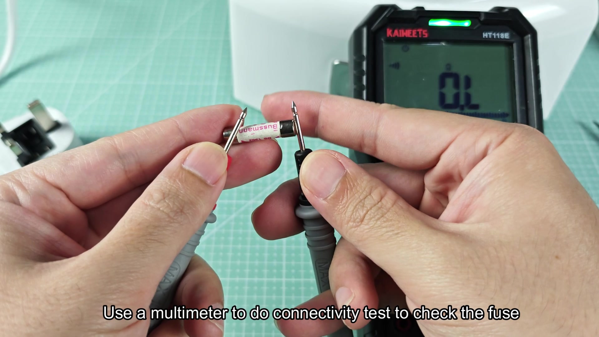

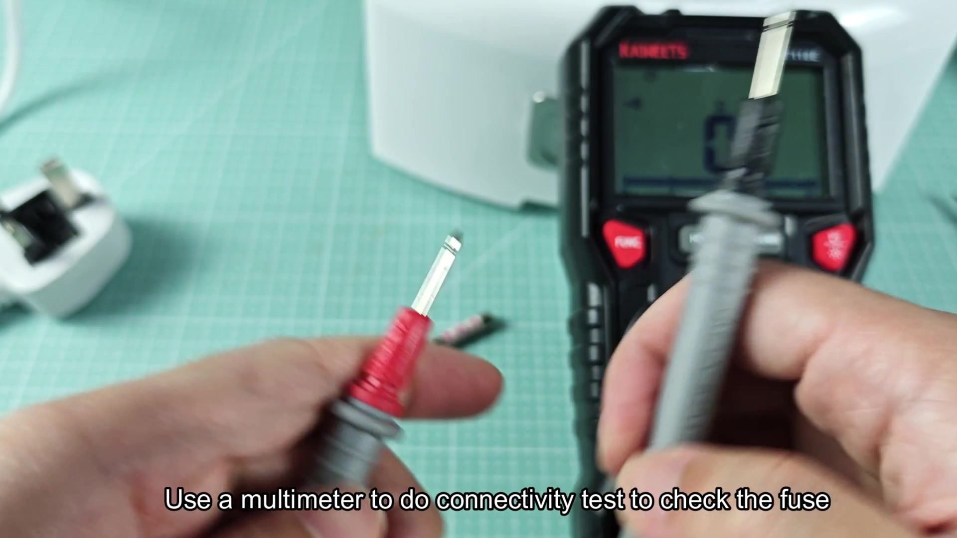

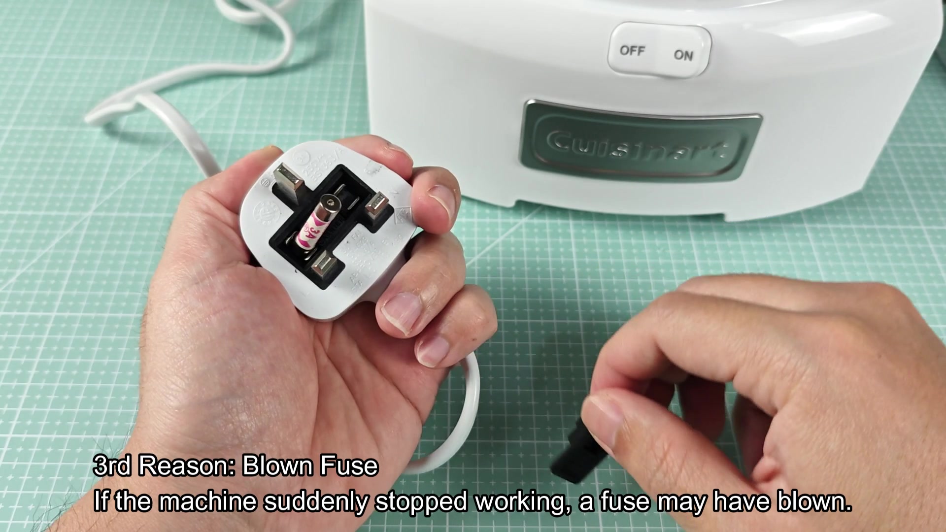

The fuse within the plug for the unit is one that gets tested on the UK models. You can test the fuse with a multimeter and replace if necessary. This is the first thing that should be checked before opening the unit.

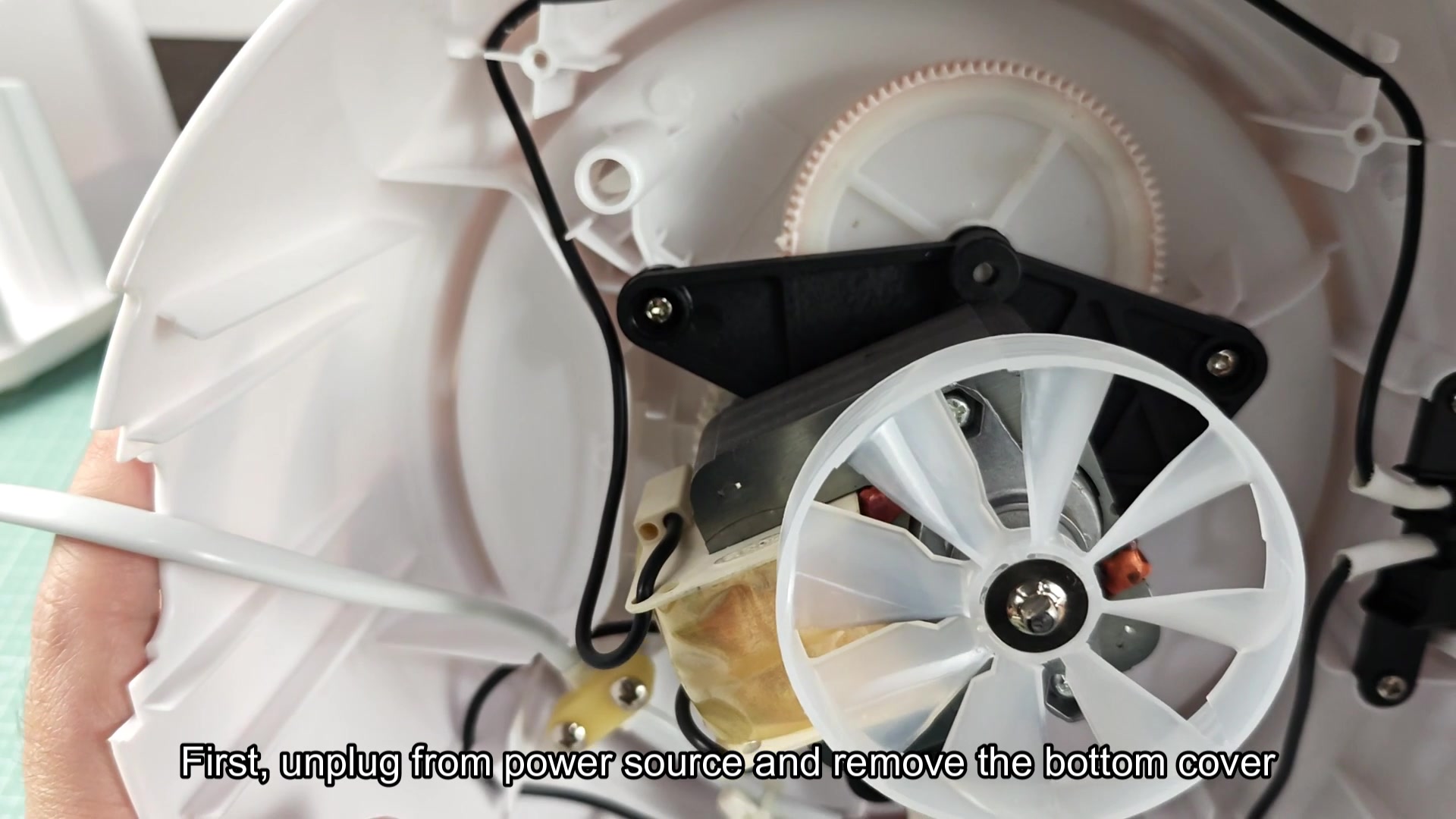

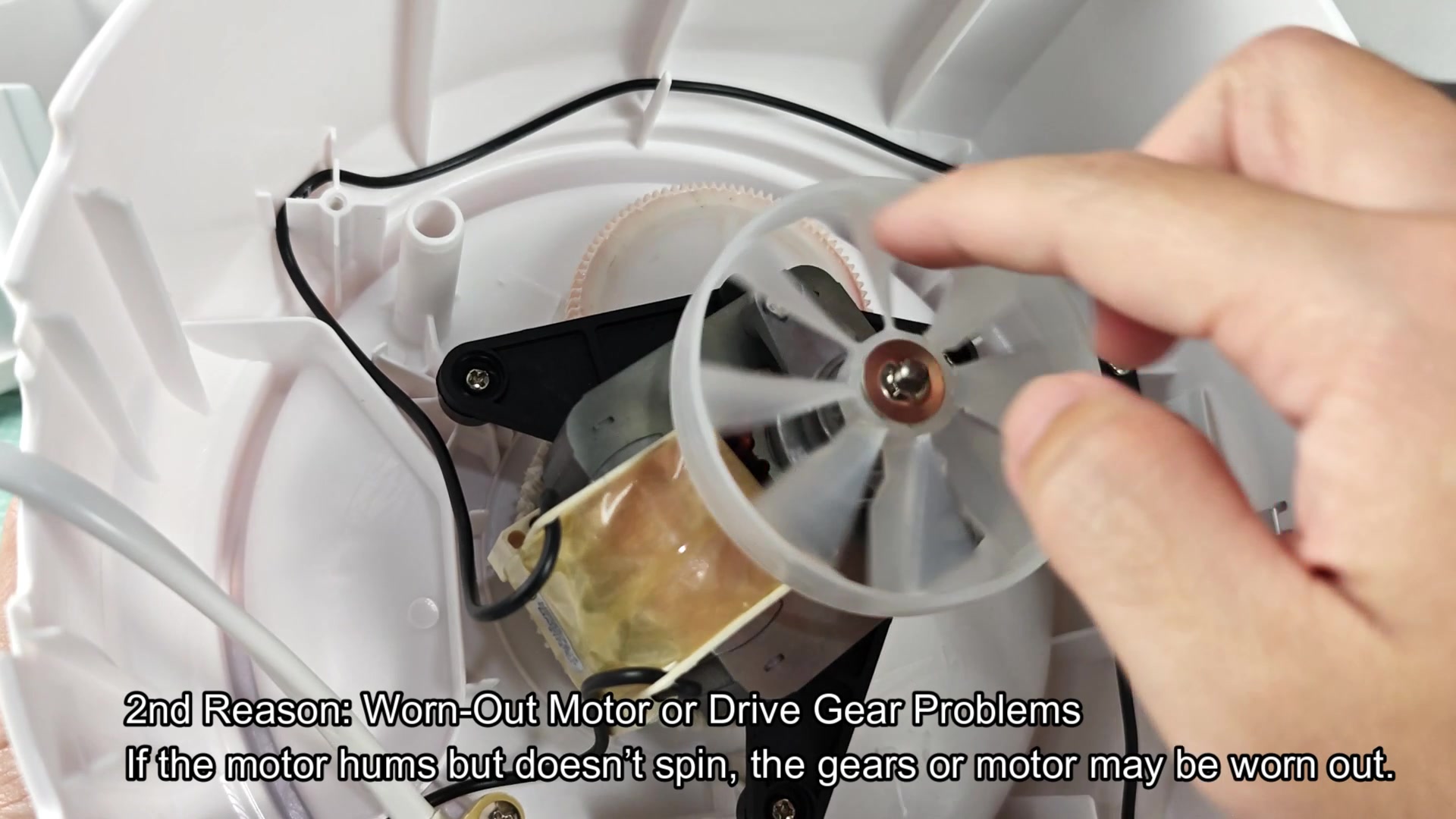

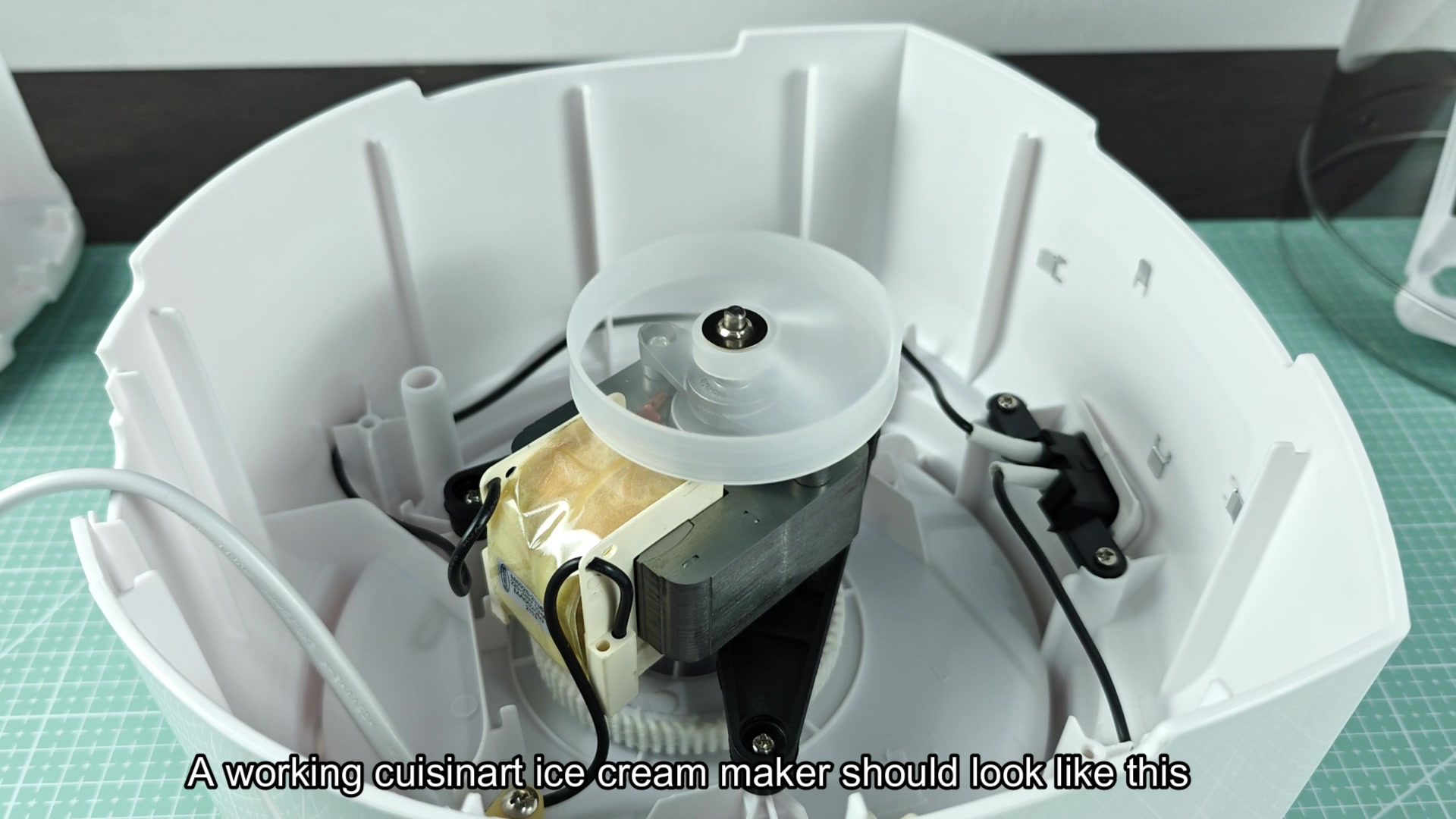

The drive motor and gear are the first of failure for these appliances. The motor work but the gear will fail. Have you opened one of these models? Are the gears plastic or is there a metal gear in these models? Is the power switch a standard switch or one that is proprietary to the appliance?

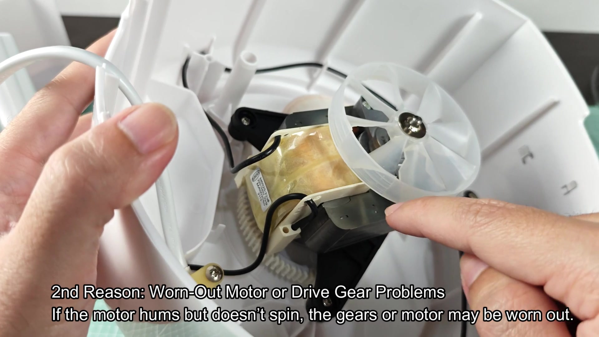

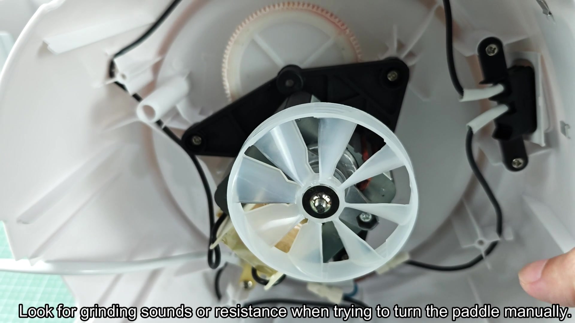

The gears are all plastic on the ICE-21 and ICE-30 at least, ive been inside a few. The motor itself is fine usually, its the nylon worm gear that strip. The gears can be bought on ebay but usually not worth it to ship the unit in exchange for a gear vs buying a refurbished unit from marketplace for $25
The fuse in the plug is the first thing that anyone with half a brain will check before opening the unit. It takes 30 seconds. Maybe 1 in 10 units will have a blown fuse in the plug but its so easy to check that its impossible not to at the first opportunity.

If the gear strips can you hear the motor running? How do you differentiate between a failing motor and drive gear?
If it is the drive gear you will hear a faint hum or buzz from the motor, sometimes its a little click click as the motor tries to engage with the stripped gear. A dead motor is silent and may smell of burnt plastic. Put your ear against the unit and switch it on, its pretty obvious.

The throwaway culture on this thread are depressing. Its a motor a switch a board and a gear. All of which can be repaired or replaced. Its not a sealed iphone.

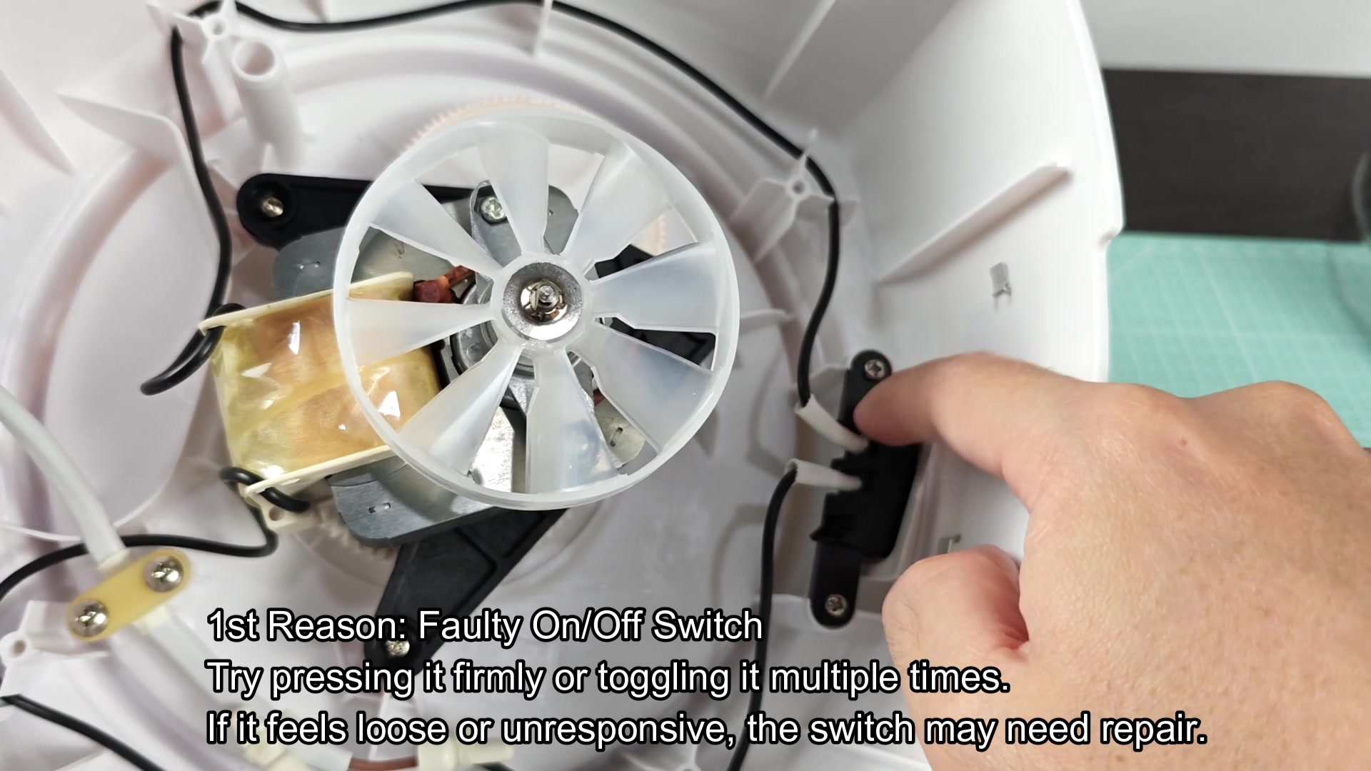

The switch on mine died approximately two years ago. The contacts inside of the switch were pitted to hell from use. I fixed it by simply replacing the switch with a piece of wire. Once the wire was in place the motor started up fine. I purchased a generic SPST rocker switch from amazon for around $4 and drilled the hole in the switch slightly bigger to allow the wire to pass through the hole. Its been working ever since. So to answer the question posed by the OP the switch is not proprietary as some may claim. Its a standard rocker switch with two spade terminals on the back of the switch.
Plug fuse first, board fuse second, switch third and motor last. Its the order. Anyone tearing open the appliance before checking the fuse in the plug is doing it backwards.
The writeup is basically correct but leaves out the thermal cutoff switch that some of the newer models have inline with the motor windings. If the cutoff switch on the motor fails the motor will exhibit the same symptoms as if the motor itself has fail. Its a matter of bridging the thermal cutoff to test the motor.

The one I had to remove from the motor on a dead ICE-30 model was a 130C one shot switch. They do not reset. I have seen a resettable one on digikey that I could splice in but I think most do just solder a wire across the switch. Its slightly sketchy in terms of fire safety but the motor is so small its not that big of a deal.
My wife knocked one off the wall making peanut butter ice cream. Its too thick so she was trying to get it to slow down and the motor just give up. Opened it up and the gear was shredded into little white shavings.

Having worked in small appliance repair for 8 years I can tell you that the frequency with which the plug fuse fails on these units in the UK is higher than most people think. I would say that 25-30% of units that fail will have a blown fuse in the plug. People do not think to check the fuse in the plug. People will think that if the light on the kettle works in the same socket in the wall that the fuse is fine but it is specific to the cord. A technician will check the fuse in the plug, replace it with a 3A fuse and charge the customer for the callout fee to diagnose what is essentially a 90 second task. Its depressing. The other thing that people do not think of is that the plug cord can break internally right where the cord enters the appliance. Especially if its been wrapped very tightly around the base of the appliance. If you wiggle the cord while the appliance is plugged in the motor may start up for a few seconds which would indicate a failed cord.
