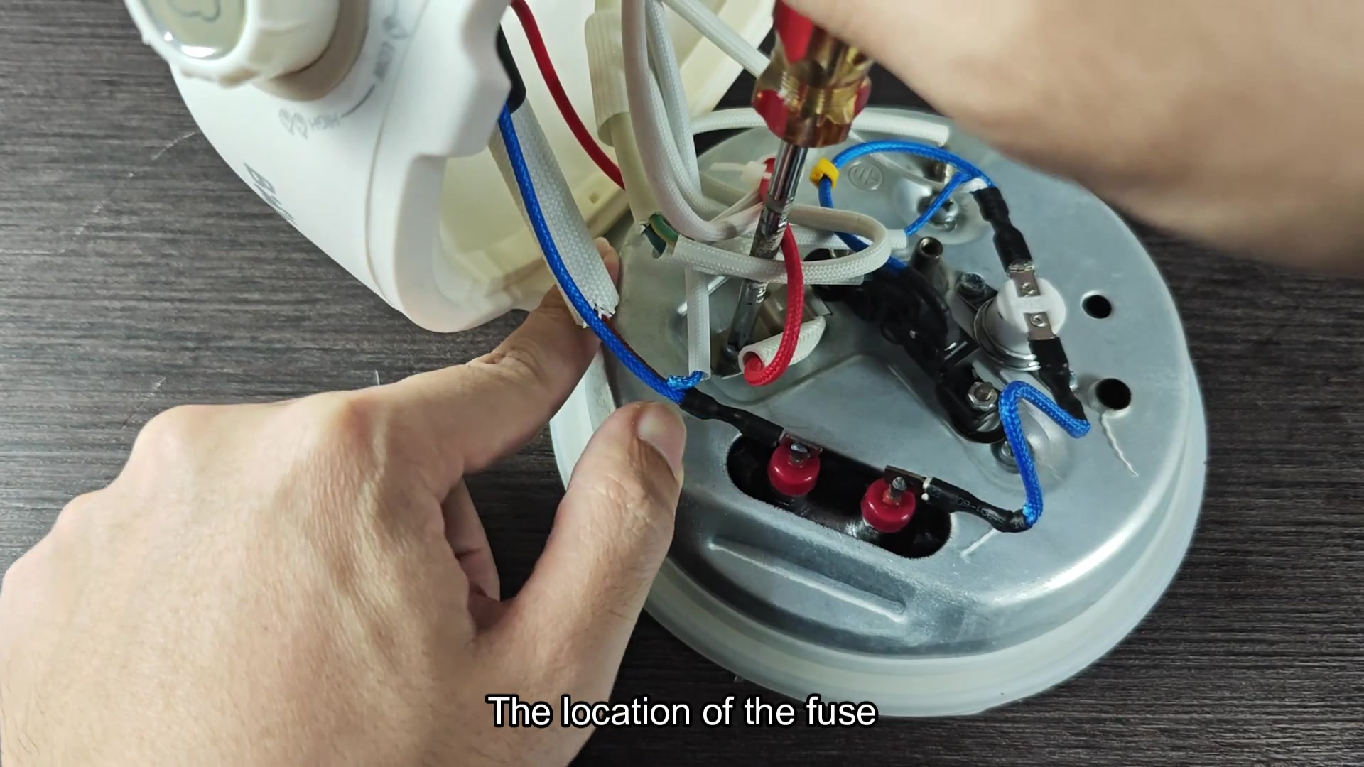

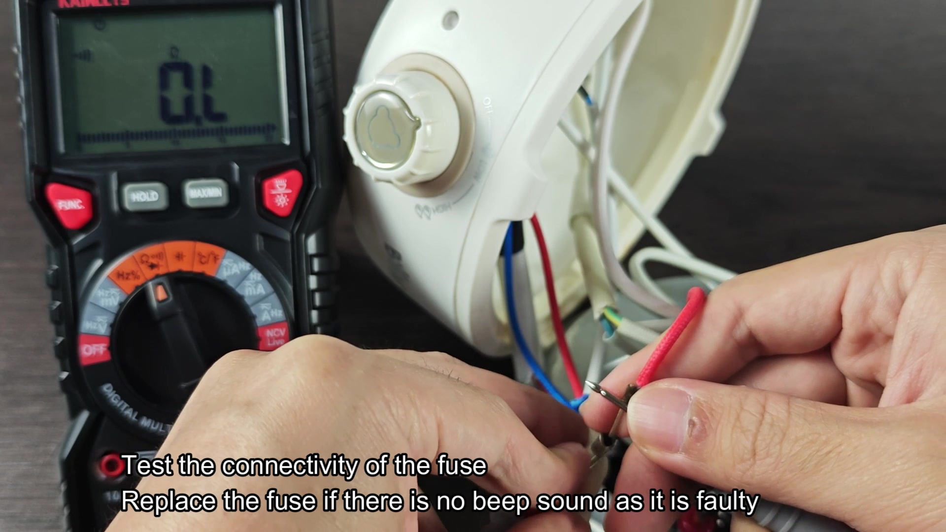

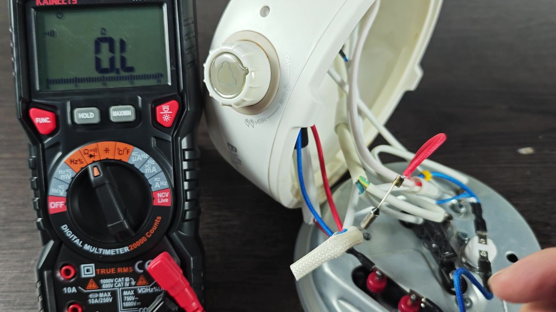

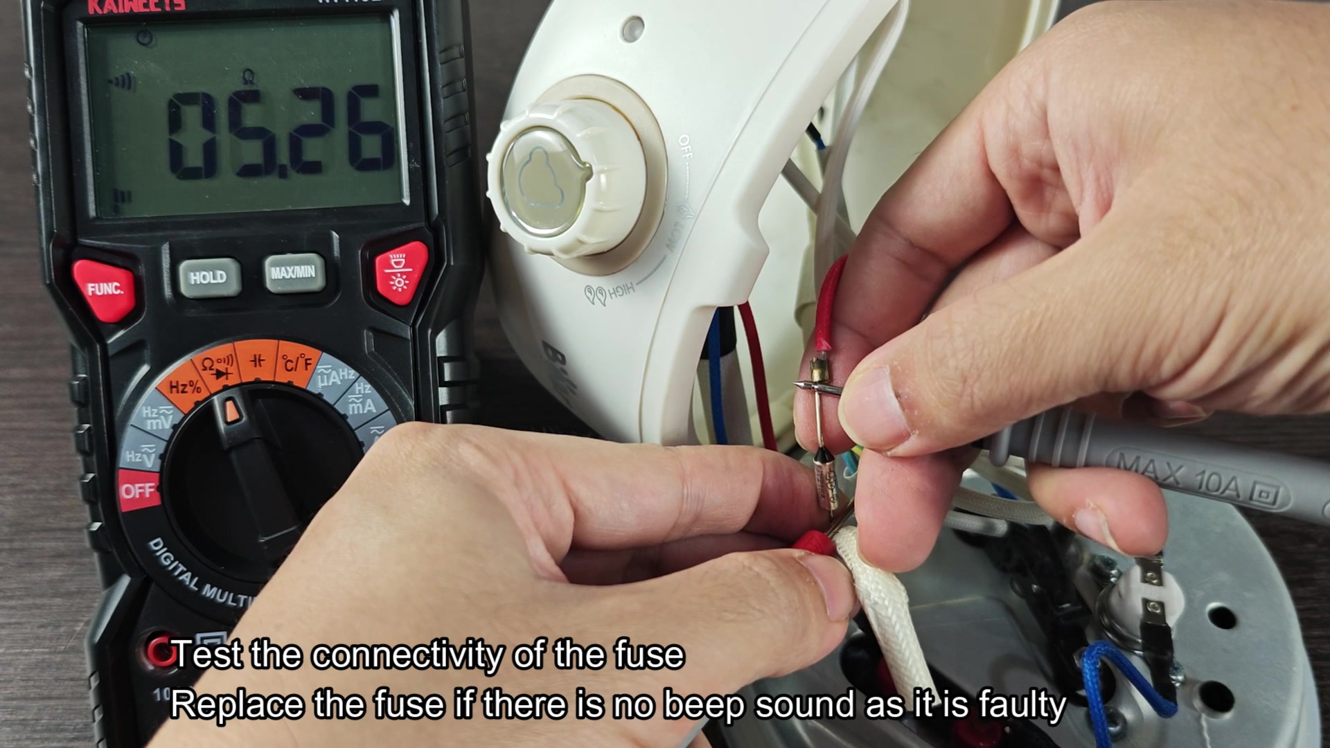

Bear cooker won't power on, is it usually just the fuse?
unrelated but i miss the mechanical switches. These days you can’t fix a thing on a Bear cooker with a screwdriver. Its all got a microcontroller and touch panel that dies every 3 years. Fuse is the easiest thing to fix but the control boards fail over time.
