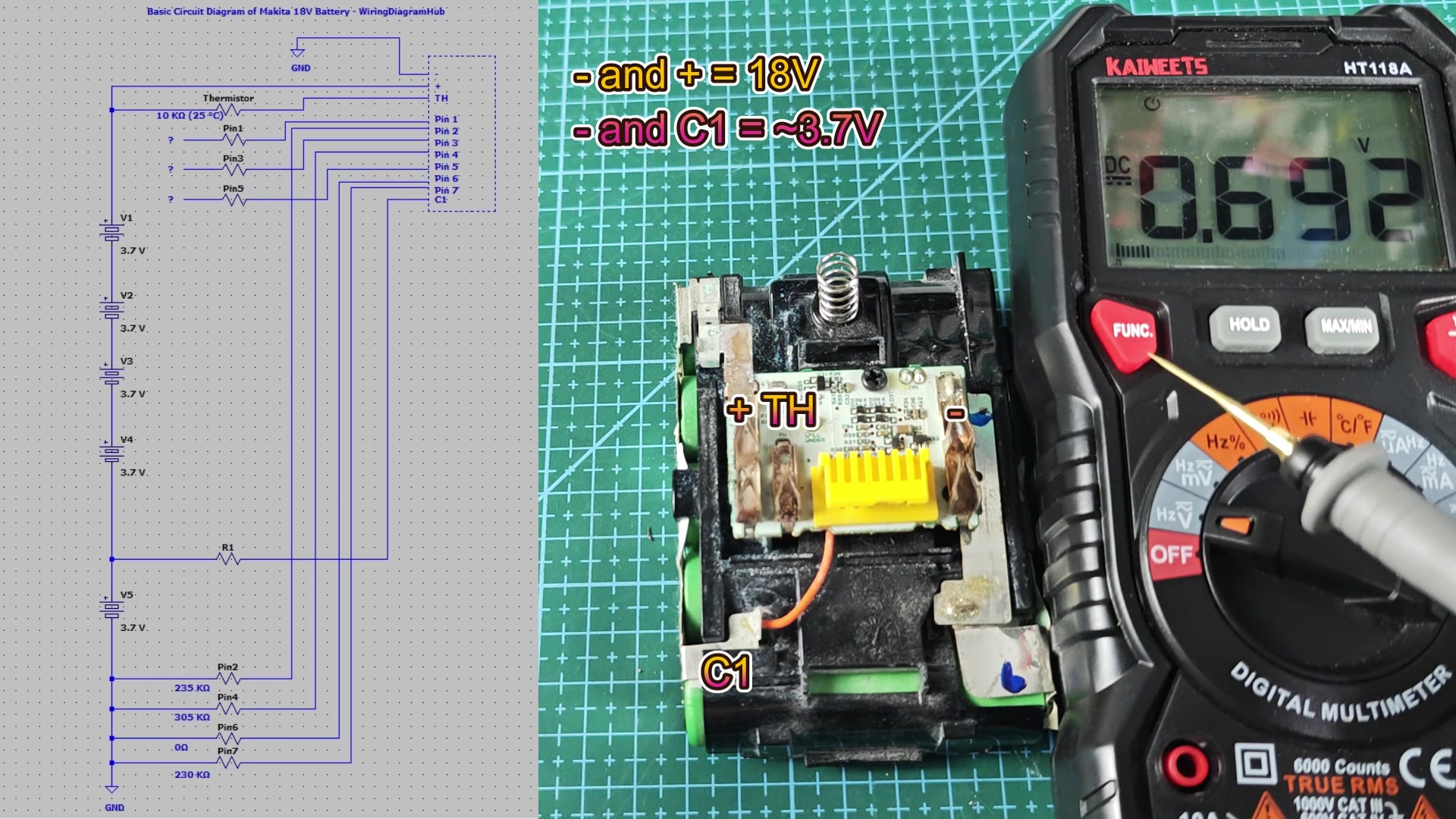

The Makita 18V pinout are one of those topics that comes up frequently in discussions but the information about it is widely scattered. The basic pins for the 18V packs include a minus pin, plus pin, a TH pin for temperature monitoring and a C1 pin located at the junction between the battery cell group for balancing. Additionally, the Makita tool utilizes pins 1-7 to identify the battery pack. I'm not exactly sure what goes into each of these pins but I would imagine that's what allows for the recognition of the higher capacity vs. The lower capacity battery packs.

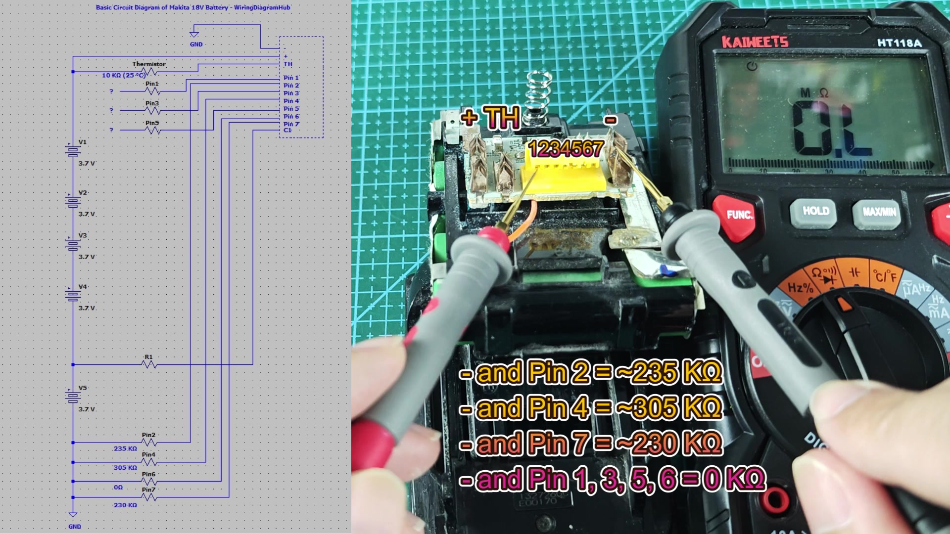

the ID pins are just resistor coding afaik, no actual data lines. Its how the tool figure out if you have a 3Ah vs 5Ah vs 6Ah pack mostly. Nothing fancy going on like serial comms or anything.

The C1 pin on the 18V Makita battery is not used for balancing the battery pack with the tool. The balancing occur on the charger. The battery's BMS system is very minimal. Most of the features on the chargers are actually built into the tool itself which is why aftermarket chargers can be sketch.

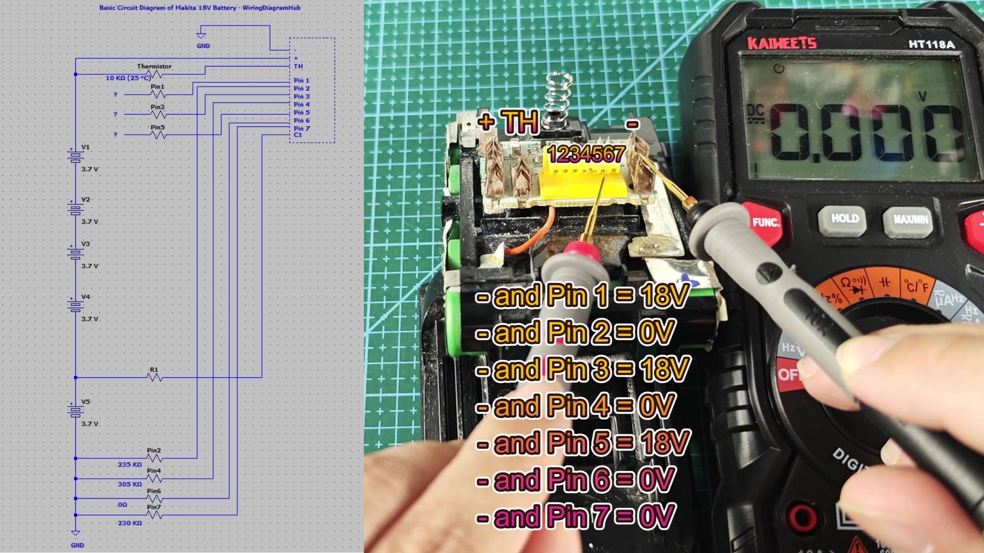

After tearing apart around 15 of these packs in the past few years I've been rebuilding them for guys in the shop I've noticed that not all of the 7 pins on the 18V packs are utilized by all battery packs. Some of the pins are tied to ground, some are floating and a few have resistors set to certain values to indicate the class of the battery pack. The newer models with star protection have some additional logic but otherwise its still just based on resistors. The other thing that is not discussed in most forum posts or guides is that the TH pin is actually essential; if its open circuit the tool will refuse to operate at all. This is the reason that some rebuilder might ignore the thermistor altogether when reusing the battery case.

XGT is a completely different beast, they have actual digital communication between the pack and the tool. LXT use a resistor to identify the battery class.
on the LXT packs, is the resistor used between two specific ID pins or between one pin to ground?
Pin to ground in most cases. Tool applies voltage and reads the resistance of the divider to determine the pack class. Different resistances means different classes of batteries. Same approach used by most OEM battery brands.

The battery will dump the current through the + and, terminals, no problem. However, the protection system will not engage since the BMS is not looking for the correct signal. This could lead to over discharging the battery and killing the cells. For ebike use, people usually just rip out the BMS and replace it with an ebike BMS.
